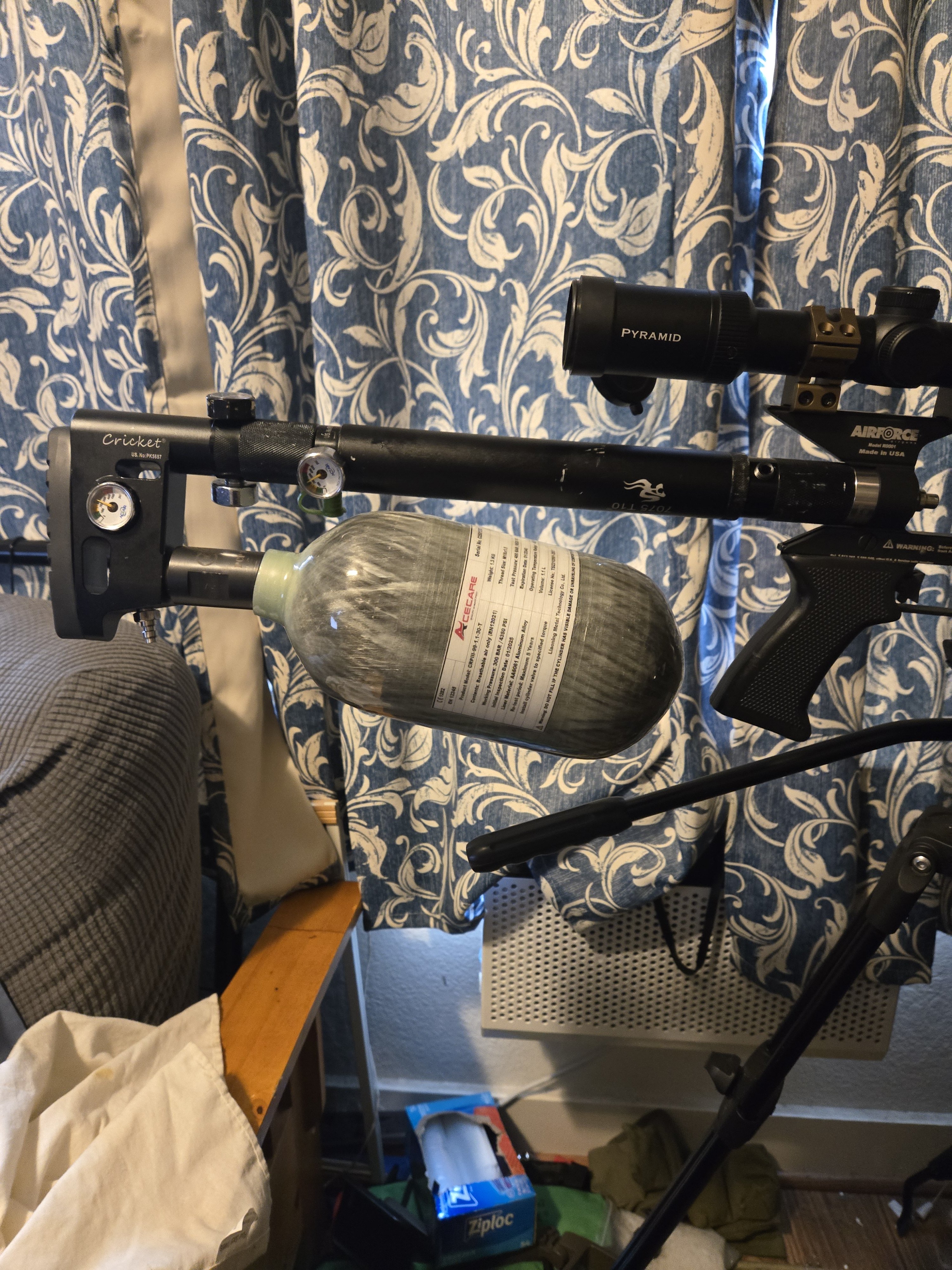

Also trajectron has a fitting that slopes a large bottle down. 20250407_083048.jpg
Mine (in use) are all genuine Huben Power and I've never had any issue with drift. I have 4 MAX-ATH, 2 Dream Universal, 5 cricket. And a Dream Universal in route.
