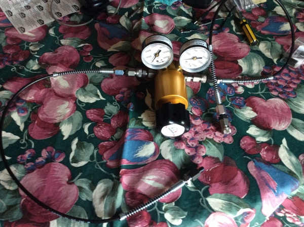

I just put this together, it's a RegMan regulator with micro hoses for my 74cf tank. Bought it through ATP. It's made for tethering.

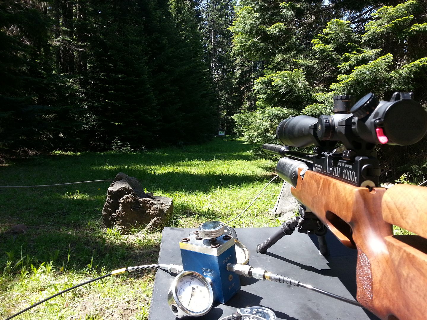

Another method I have used in the past was a 90cubic inch 4.5k psi Air Venturi or Ninja tank that has the regulated output. The regulated output is supposed to be set at 3k psi but they really only put out between 2700 to 2800 psi. So, depends on which gun you tether and it's performance at that range.
I was initially aggravated with it til I figured out that it filled my Prod to the exact fill it preferred at 180 bar, so I kept it. I then began using it for tethering unregulated guns for bench rest shooting. Lotta shots! They seem to go for $299 but I see them for sale used quite often for much cheaper. A lot of unregulated guns like to shoot at 180 bar, right in the plateau of their curve. Also, most regulated guns have set points of 150 bar and below so this works in that scenario as well. They can also be purchased at different "set points" for regulated output. The dedicated outboard Regulators are nice but this works well in a pinch. Air tanks plus seems to have them with set outputs of 2400, 2600, 2800, and 3000psi. And if you already have a small tank with paintball sized threads, you can just buy the regulator for $98.
"Mick-VA"Another method I have used in the past was a 90cubic inch 4.5k psi Air Venturi or Ninja tank that has the regulated output. The regulated output is supposed to be set at 3k psi but they really only put out between 2700 to 2800 psi. So, depends on which gun you tether and it's performance at that range.
Any regulator works well. Even a fixed for regulated guns. I started shooting my unregulated AAS510 off it. Now I always have my regulated guns tethered. I just set the pressure above the guns regulator. It just makes it easy to target shoot. No worries, and one less thing I have to think about falling off the regulator.

I have a 4500psi Air Venturi tank also that's regulated at 2900/3000 but the nice thing about having a adjustable regulator is you might have a ag that shoots best at 2650psi and another ag that does well at 2900psi and another ag that likes 2700psi having a good adjustable regulator lets you explore different psi settings and get you to your best string and then you can shoot constantly at that psi for a long time...If my .357 BullDog is shooting say 3 shots at 915fps at 2825 then falls and I refill and it shows the same thing again I can then tether my 74cf tank and set it at 2825 and really have a fun day shooting same thing with my .22 or .25 find that sweet spot set the reg off a tethered tank and have at it. At least this is how I look at it.
