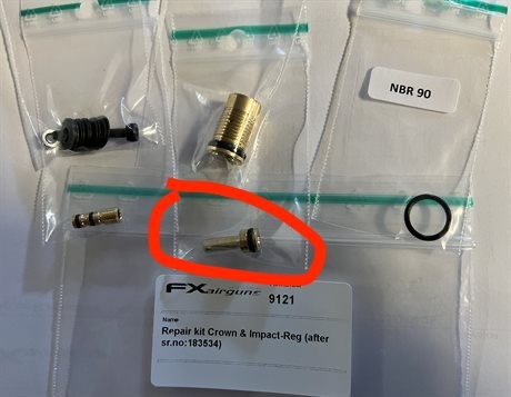

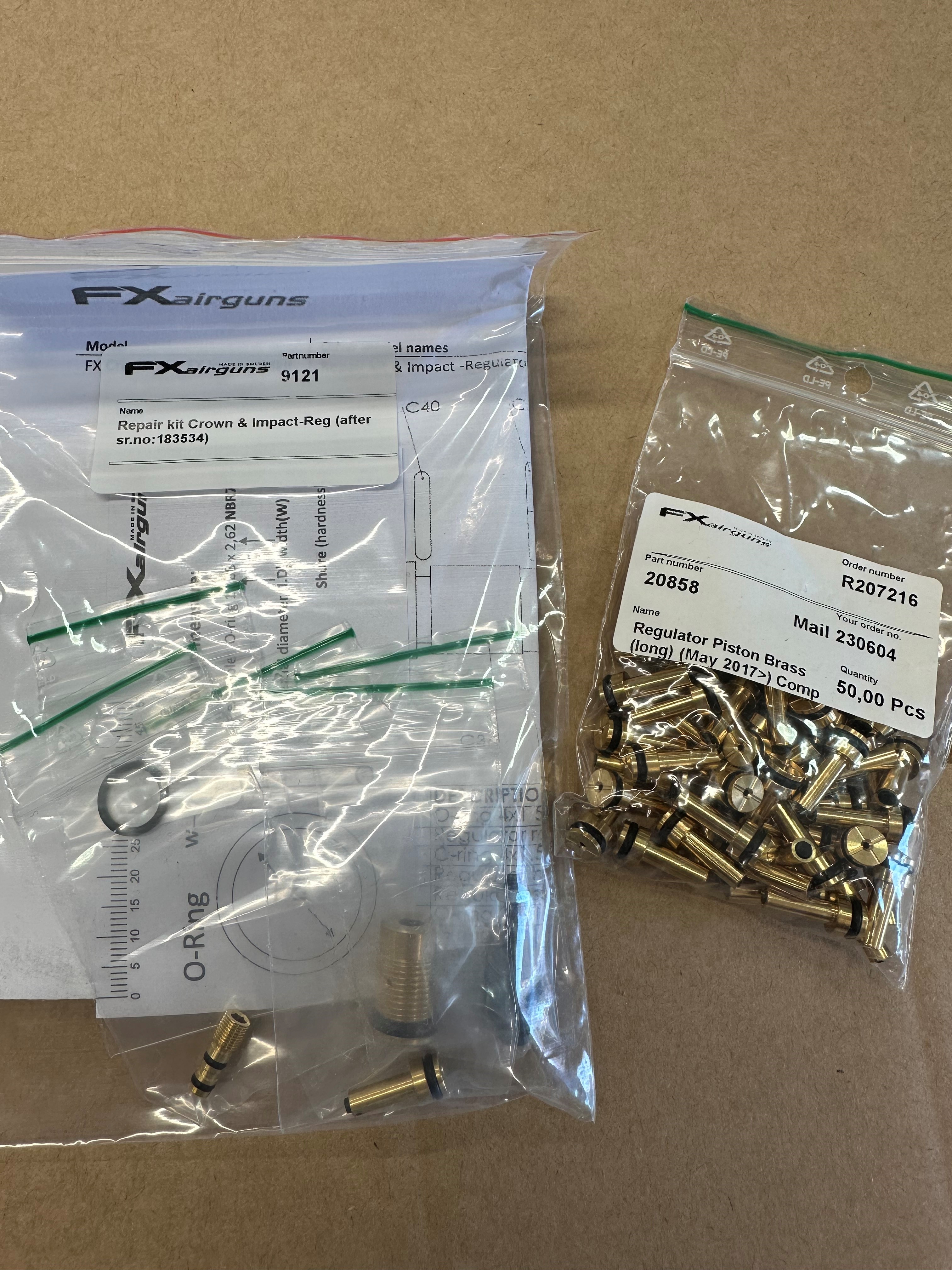

Because all in life is relative, consider contacting Mundilar Airguns. (in case you re still out to purchase an FX upgrade replacement kit for your reg of course)
I ve just purchased one there.
A complete upgrade reg kit with brass piston + an alternative (slightly different) brass piston : 60€ in all. (+ shipping fee of course, whatever that is for shipment to Denmark)
And no, these items are not advertised on their website. You will have to mail them and specifically ask for it. You might send this below photo with your mail, they will recognize it, because it's their photo they have sent me.
Hope this helps to get your Maverick back on track, the way you want it.
Good luck.

I assume that is a complete regulator, or at least with the O-rings, the the washers i am OK moving around
Complete kit, yes.
Here better to be seen on another Mundilar photo.

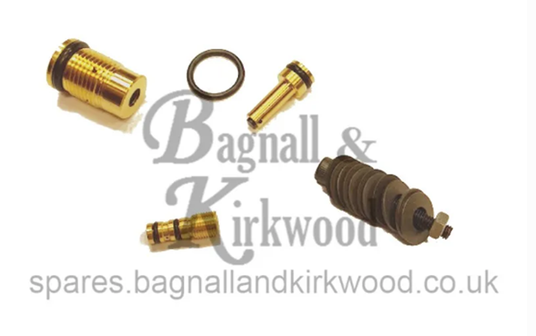

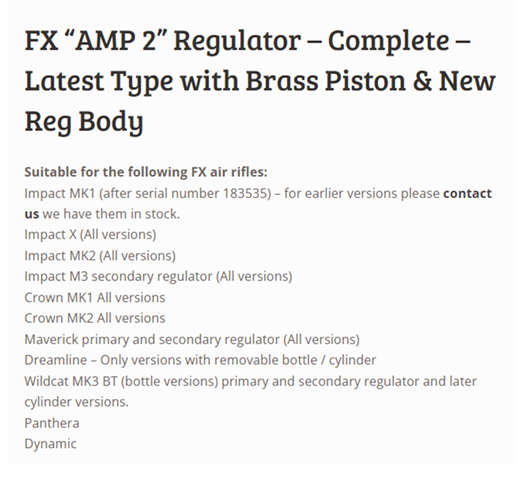

Bagnall & Kirkwood sell the exact same kit too. (see screenshot below)
However, their UK price tag for a complete AMP2 reg kit + an additional (and slightly different) brass piston model is
92€ + 30€ = 122€ ,
hence more than double of Mundilar's price for the same.
Sometimes you do get to wonder . . .
