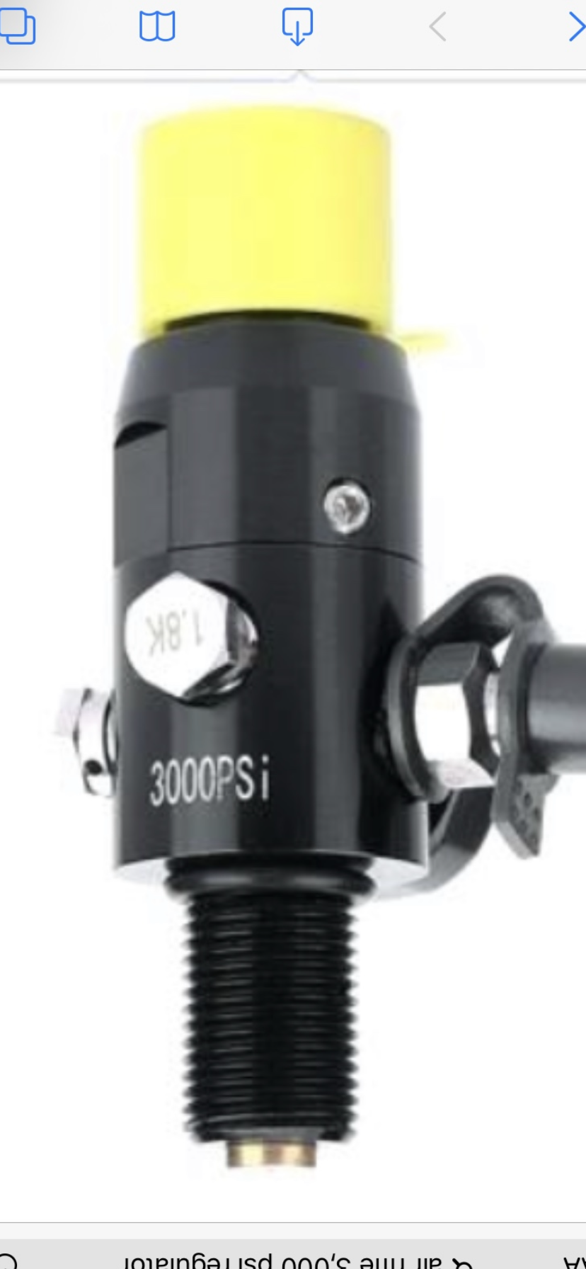

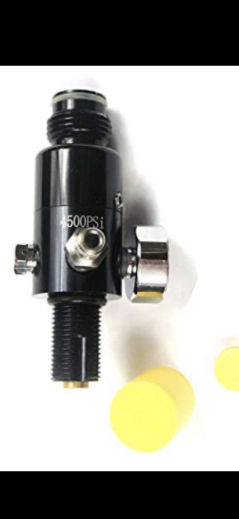

What you are looking for is an unregulated valve. Nobody is going to make a regulator with the same output as the input pressure. It defeats the purpose of what a regulator does. If you can't take the guts out of what you have and make it unregulated, get a dive or SCBA valve with the right thread for your bottle. If your bottle has metric threads, take a look at this one. https://www.aliexpress.com/item/4000026760786.html?spm=a2g0s.9042311.0.0.5ef64c4dD2jmIi It doesn't have a gauge but you won't find a new one any cheaper.

What I hope to do is fill rifles that require 3600,, 3000, & 2200 from the 4500 bottles.
It seems to me that a regulator set at 3600, 3800, or even 4000 would do so
Are there no regulators with gauges available in that range?
If I were to look for something that "nobody makes" it would be an externally variable regulator
I assume such a device does not exist.
Any and all sound advice appreciated
