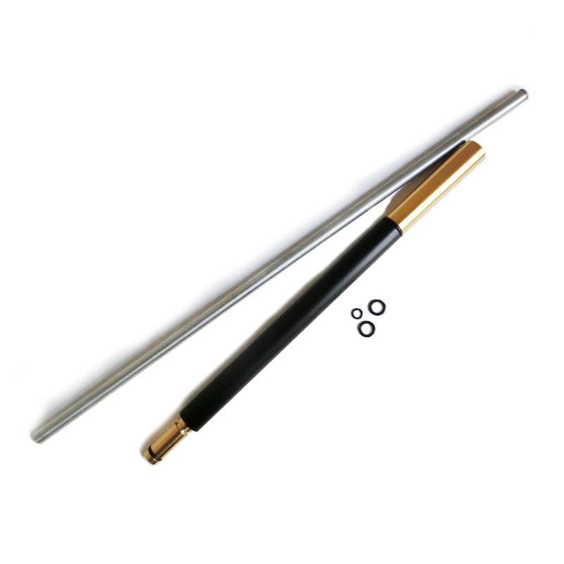

I'm installing a Altaros regulator in my s510. its coming from Altaros set at 33fp.

When I ordered from Altaros they ask what Joule/Foot pounds you are looking for. I told them 21J / 15.5 ft/lbs. With my current setup I'm getting 16 ft/lbs. 835 fps with a 10.34 AA pellet. Do I need to adjust the HST in or out? Stronger or weaker? It seems like I could easy adjust the regulator while it's in place. I would just need to degas and open the air reservoir. Thanks for your help AJ
Somehow I damaged the o-ring when installing the regulator. Actually it's pretty easy to do and I did it two more times with the extra o-rings they sent. I just ordered a pack of 50. I'm bound to get it right eventually.

You take the gauge out and then insert this into the air tube and watch for the o-ring to show in the gauge port opening. You are then supposed to push down on the o-ring with a blunt object to get it past that hole without damaging the o-ring. It's hard to push in to that point and then it slips past and damages the o-ring. I ordered 100 of them. I'll figure it out eventually. Maybe there is a bur on the metal in the gauge opening? Maybe I'll try a different regulator.
100 o-rings? It would be such a waste if you decide to buy a different regulator other than the Altaros which I assume you are thinking of doing. I would be sure to lube the orings with some diver's grease (not any type of petroleum based lube!) then carefully install and push up though the gauge port while sliding in. Be sure your blunt object tool is not somehow cutting into the oring either.
"TenTen"Other option is put o-ring from first groove to second ( closer to black airchamber ), then you will not have to push o-ring around manometer hole.
Manometer will show you regulated pressure, i like it more this way.
Thats an interesting idea. I may give that a try. It would be nice to be able to have it both ways. I'd like to know regulated pressure to make sure the regulator is working properly, but I would also like to see tank pressure to know when it's about to fall off the regulator.
