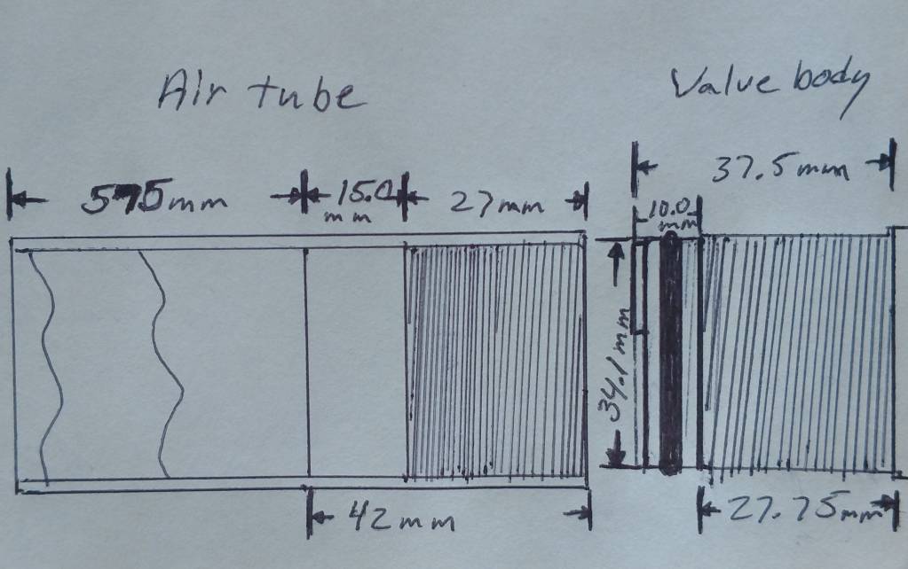

Thanks for posting your experience. If I can get three to four consistent shots then I'll be happier. Right now it is way to extreme of spread for my liking, though it is cool seeing the chrony hit 980+ FPS.![]()
There is about 550 cc's of air space available in the tube to work with, but sealing the regulator is going to be tricky. The way it is machined now, only 4 mm of space is available for sealing next to the valve body, and I don't know how it will be referencing atmosphere like that.
