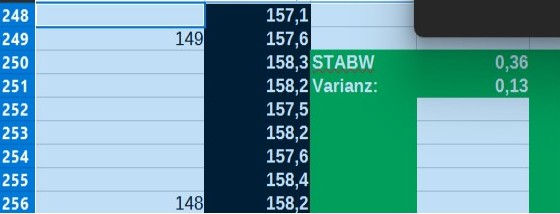

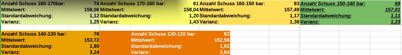

I bought a Red Wolf for the german market and it's limited to 7,5J. The second limit is, they are only allowed by daystate to be filled to 180bar, although the bottle is rated to 250bar. I filled the gun to 182bar and did a shot string down to 118bar where it showed low pressure in the display. That was hours of work but it did outstanding 493 shots. That's 7,7 shots with one bar of air, crazy. Then I did some math which showed the following:

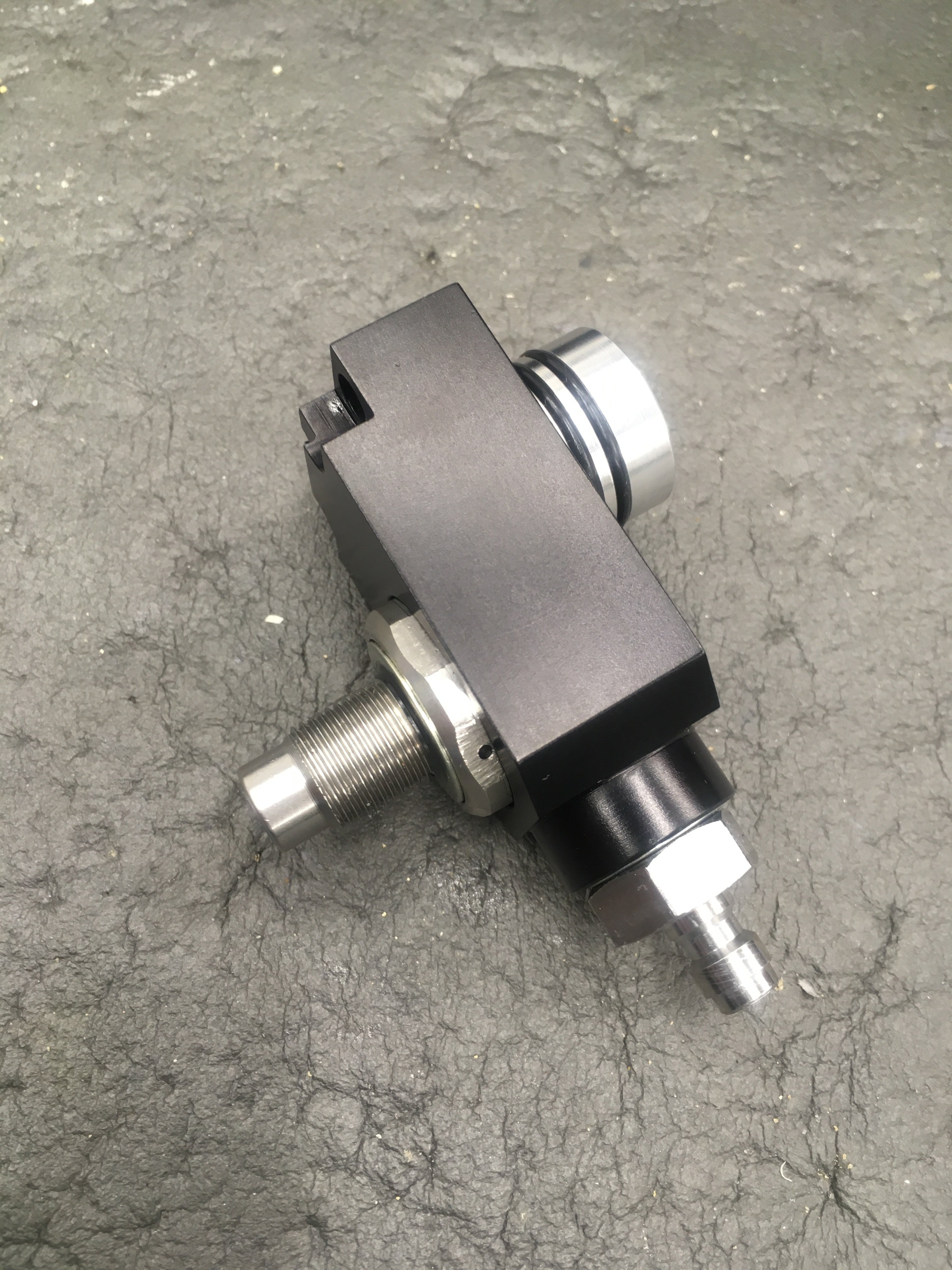

Best string was from 150-140bar and now a big research begun. No regulators for the Red Wolf available. It seems, noone did it before. I looked over the exploded views from nearly all bottle guns Daystate produces and found out that the bottle and the O-Ring for the bottle of the Wolverine were the same size. Bingo! Then I ordered a Wolverine bottle reg from Huma-Air and it fits perfectly. Set it to 150bar and it settled at around 148bar with a very fast recovery time after each shot. Love it. Doing the math again it looks like this now:

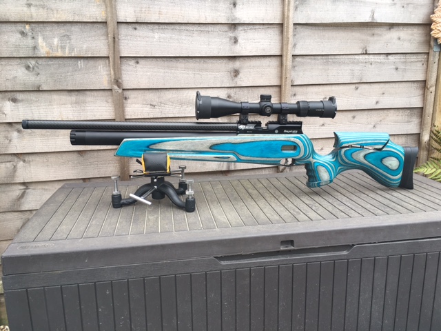

Perfect. Now I can fill the gun to 250bar and shoot it down to 148bar and I can do nearly 900 shots with one fill with a perfect deviation between the shots. The gun looks like that now:
Love the Red Wolf!
This one is the reg you need: https://huma-air.com/daystate-wolverine-hi-lite-regulator-by-huma-air/
