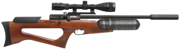

First off, I was very interested I purchasing a Brocock Bantam Sniper HR but had a heard time pulling the trigger due to the cost. I just picked up a 22 cal Brocock Bantam Hilite on the forum and would like to turn it into the Sniper HR. For those with experience with these guns:
1) With the slingshot valve system, is it worth adding a regulator the gun?
2) What regulators would you recommend? I saw altros sells a regulator.
3) What regulator pressures did you try and what were the results?
Thanks Gentlemen!
As one who has had his fair share of regulated PCPs, and consequently my fair share of regulator ISSUES, I purchased a Bantam HiLite specifically because it isn't regulated, and I wanted to see if the incredibly logical-sounding Slingshot hammer/valve set-up worked as well as hyped. I also chose .22 caliber as (in my mind and opinion) the silver-slipper caliber for the HiLite platform. Happy to report I was right on both counts!
Mine isn't quite as powerful as advertised, producing 29 foot-pounds average. However I'm not anxious to monkey with it considering I'm getting more VERY CONSISTENT shots per charge than advertised (makes sense considering the power shortfall). From an optimum 235 BAR fill I'm getting 65 regulated-consistency shots with 18.1 grain JSBs.
Low= 835, Hi= 862, ES=27, SD=4, Average= 852 FPS / 29.0 foot-pounds.
It's also very accurate, consistently averaging .50" to .65" c-t-c five-shot groups at 50 yards with 18.1 JSBs and 16 grain Air Arms pellets. That's phenomenal accuracy and consistency from a short, light, handy carbine! So to answer your question, NO, it's not worth adding a regulator.
