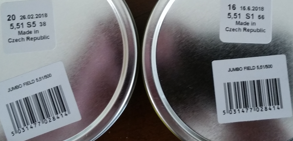

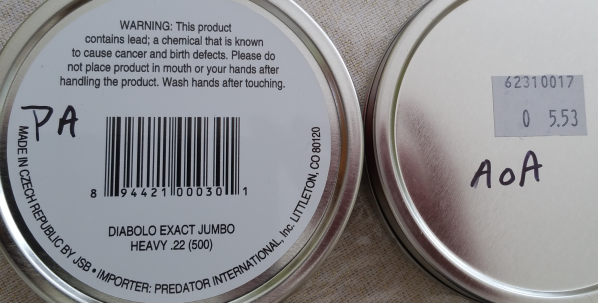

Well, this is interesting and would tend to affirm my experience so far after resizing the JSB 18.13 from 5.53 to 5.51 head size. A problem arises though, depending on who I purchase the pellets from, how do I know die/batch? Here's an example, JSB 18.13 from two different stores:
Based on your post over in Dhart's thread on the Red Wolf's accuracy, I'm reading the tin on the right as die 62, batch 0 ? But the tin on the left from Pyramyd Air has a round label with only a bar code. I get the same round label on JSB tins that I order from Trenier Outdoors. But when I order the Air Arms 16gr from both places, they come with labels like this:
Do you know how to decipher the AA labels as to die/batch? The ones on the left shoot fantastic in both my Regal and Wildcat but I haven't tried the tin on the right yet. I don't think that barcode in the top photo gives useful info considering the AA tins in the bottom photo seem to both have the same barcode.
