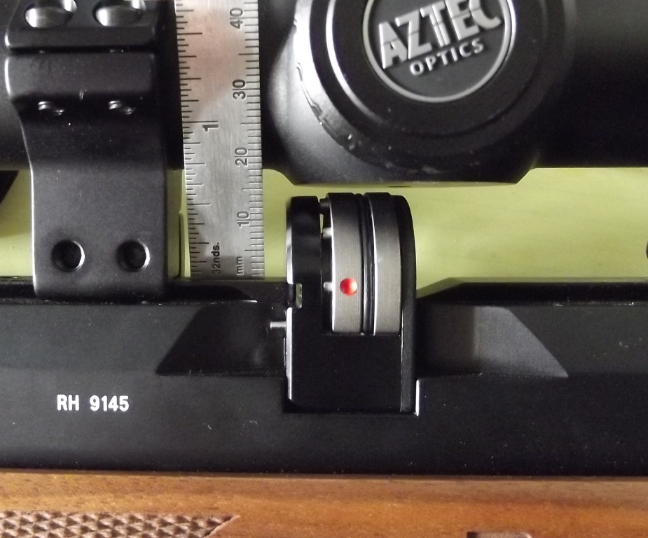

Also, how high does the magazine sit above the action? Wondering what height rings I need?
The magazine sits a tad over 1/2" above the breech, so I'd go with high rings depending on your scope. You might give AOA a call about the scope and rings, they would know.
