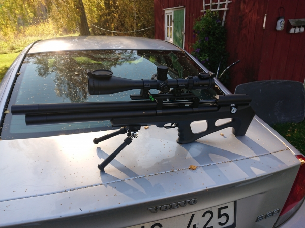

I use my wildcat as reg tester. And have mod the stock so i can have the gauge in there to see if i have reg creep. Works fine. And i have set up my royale 500 reg in the wildcat.
