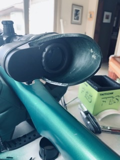

Also my reflection problem with the leupold scope being the worst is because there is a very long eye relief especially in low power settings That means there is a large space between your face and the ocular area allowing light and reflections to be introduced. I fabricated a eye cup which doesn’t look that great but hopefully will solve the problem.
