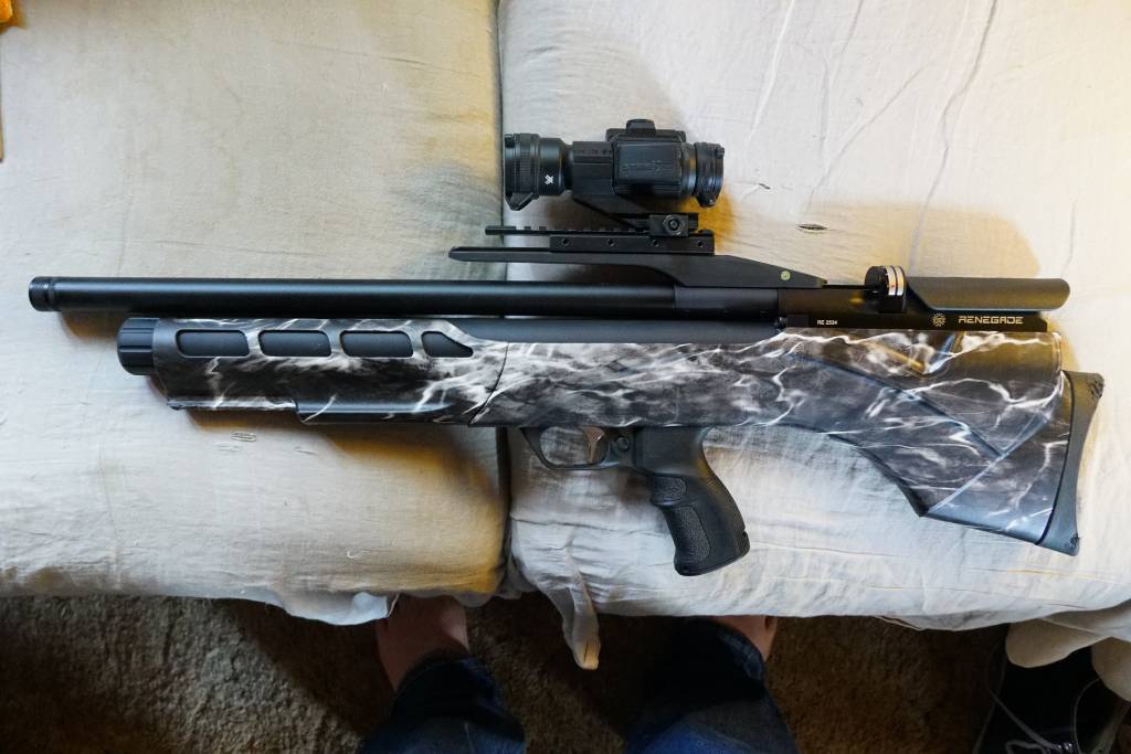

If you don't need to have a wood finish, "vinyl" wraps are pretty tough. Will take a lot of abuse without damage. I've done two so far, the material seems to be able to withstand a bit of a beating with no adverse surface damage.
