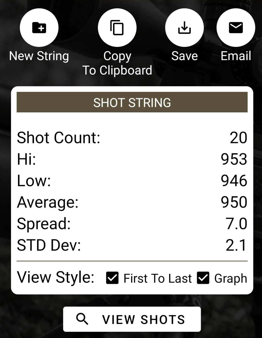

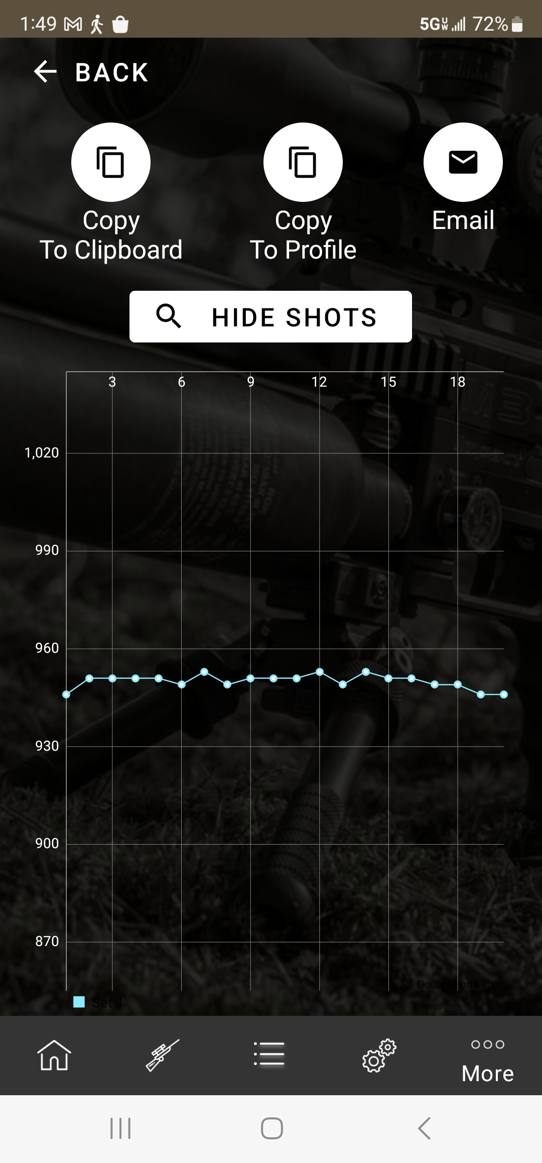

I know this is an OLD thread however, I just got a Heliboard and an 11.1v Red Wolf HP so I'm going to the range to record a shot string from 250bar down to 150bar and will attempt to tune the RW to shoot the flattest curve possible at around 950 fps. The #'s I see you guy posting would be atrocious with either my M3 .25 or my prototype Skout .25 caliber. I'm use to seeing SD's in the 2-3 range so I find it difficult to imagine that a gun as finely tunable as the Redwolf isn't capable of the same, but we'll see. I only bought this gun to fool around with as so many EBR winners have done so with .22 caliber guns and RW's in particular. While I agree that getting hung up on the #'s is not nearly as important as actual real world results, I've never seen a gun that could be counted on to consistently group at 100 yds that didn't have excellent #'s (low SD and ES).
Here you'll see the results of my first attempt to tune my .22 Red Wolf HP with the newest Heliboard I just installed. I think this demonstrates that an SD of 2 is a reasonable goal.

Today I plan to tune a program to 970 fps. I will save the final string results and post them.
Will be interested in your attempt of a shot string from 250 bar down to 150 bar joe.
Hi Paul. I changed my mind about which speed to use, opting for 950 as a target. This tunes window starts at around 240 bar and ends about 60 shots later ( although only 50 are shown here) at 185 bar. Because I specialize in bench competition shooting my goal may be a bit different from those of the typical shooter
I want as little variation from shot to shot as possible within a limited pressure window large enough to allow for all 23 competitive shots as well as an equal number of sighters. Tuning beyond that although possible servers no practical purpose in my application therefore I simply don't bother. Here are the results of my latest 950 fps tune.
Notes: Red Wolf .22 cal
Pellet: JSB RD
Weight: 25.39 gr
Shot count: 50
Low: 944
Hi: 958
Avg: 951
STD Dev: 2.9
Spread: 14.0
