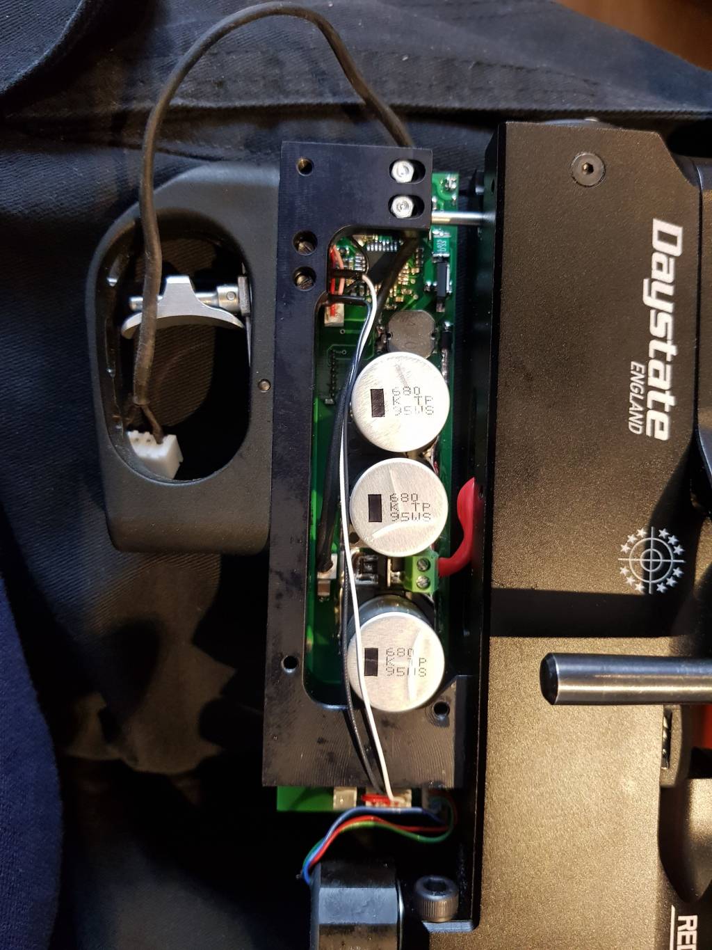

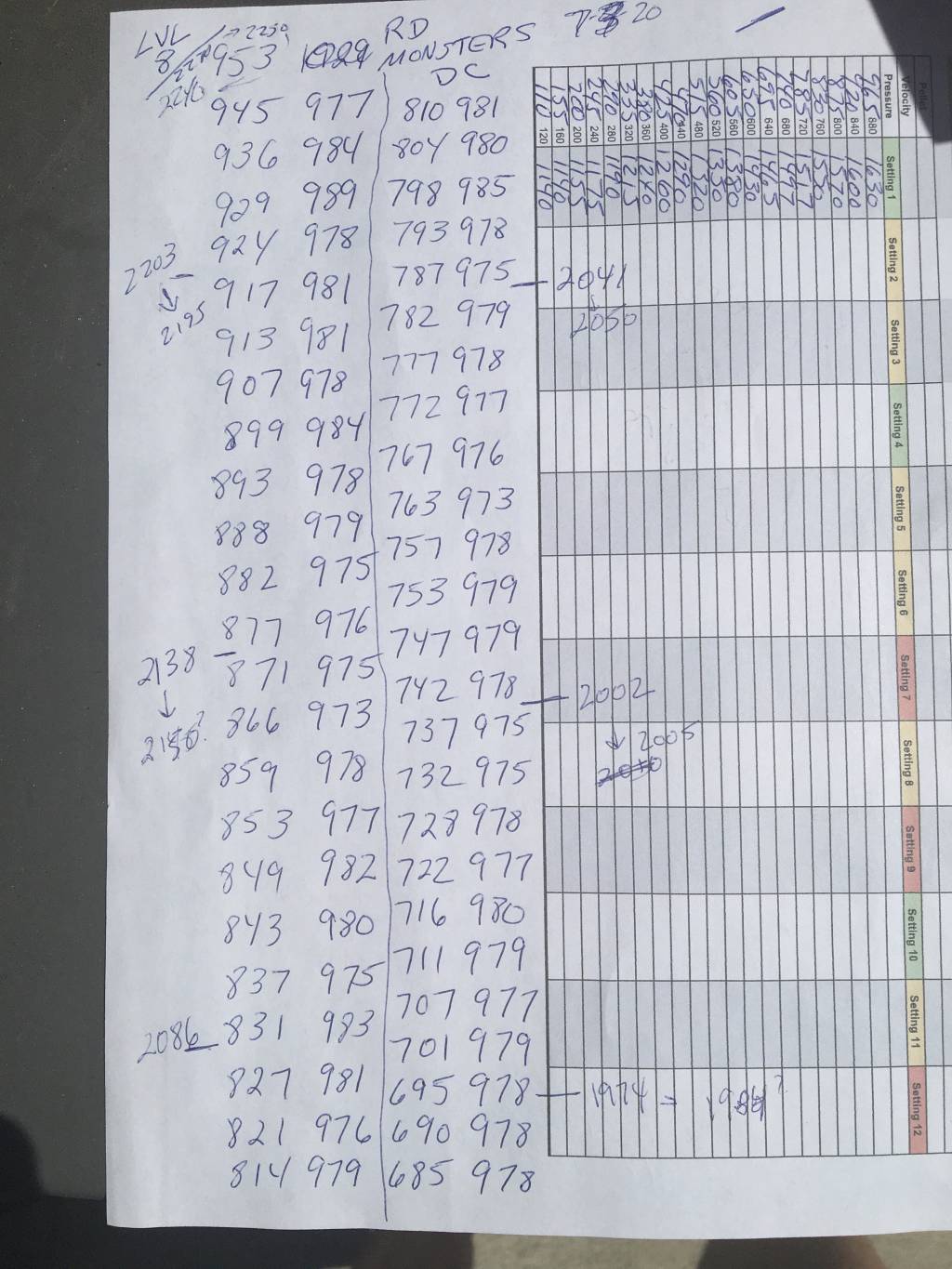

This is what the HP HeliBoard looks like below the factory GCU2.0 board, and a typical shot string level 8 with RD Monsters. The two columns have pressure from n “r” values and FPS. This is with standard HeliBoard programming and capacitors at 90 vdc. I tried for many hours but ended up back at the factory HeliBoard settings. The red jumper on the right is removed in the HeliBoard setup.

Hi Scott, on level 3 my gun shoots the JSB 18s at 890 to 900 FPS. However, my specific gun doesn’t really like the 18s much and for 25M BR the RD Monsters are much more accurate at 760 FPS on level 3. ES for 50 shot string on both is approx. 12 to 15 FPS.
