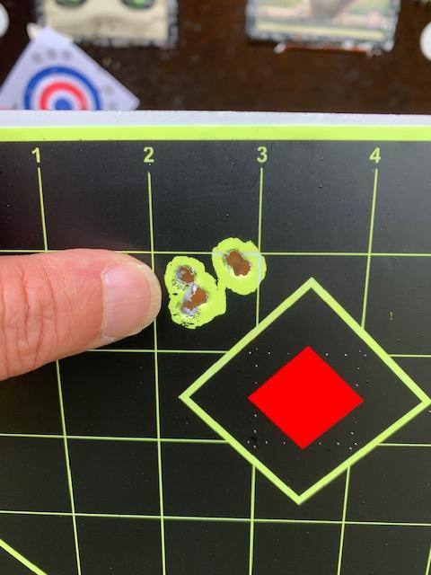

Do you have any pics of groups?
RW HP at 100yards today with 25g Monsters doing 974 FPS.

I will post some groups when I get a calm day. Testing pellets on paper with high winds does nobody justice. As for the "I think" comment, I dont like to live in that space. My post what what I seen from 100 slugs in a shooting session in very difficult conditions. Less hold for wind and no adjustments to my turrets with 1.5 more grains of lead. Only surprise was the lack of explosive response on feathered targets. Just went right thru and they drop, no big feather pillow effect. Probably due to lack of FPS but dead is dead.
