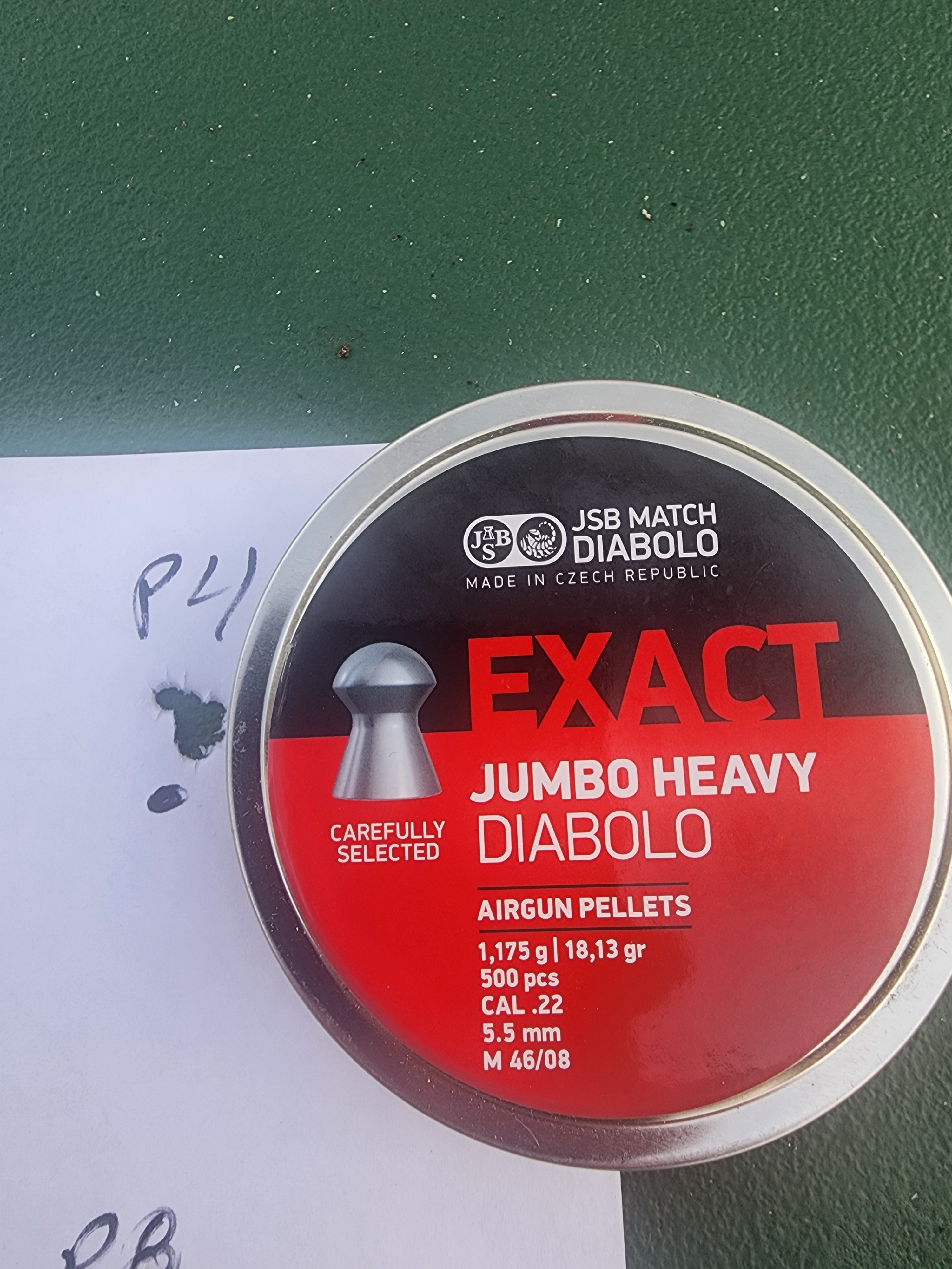

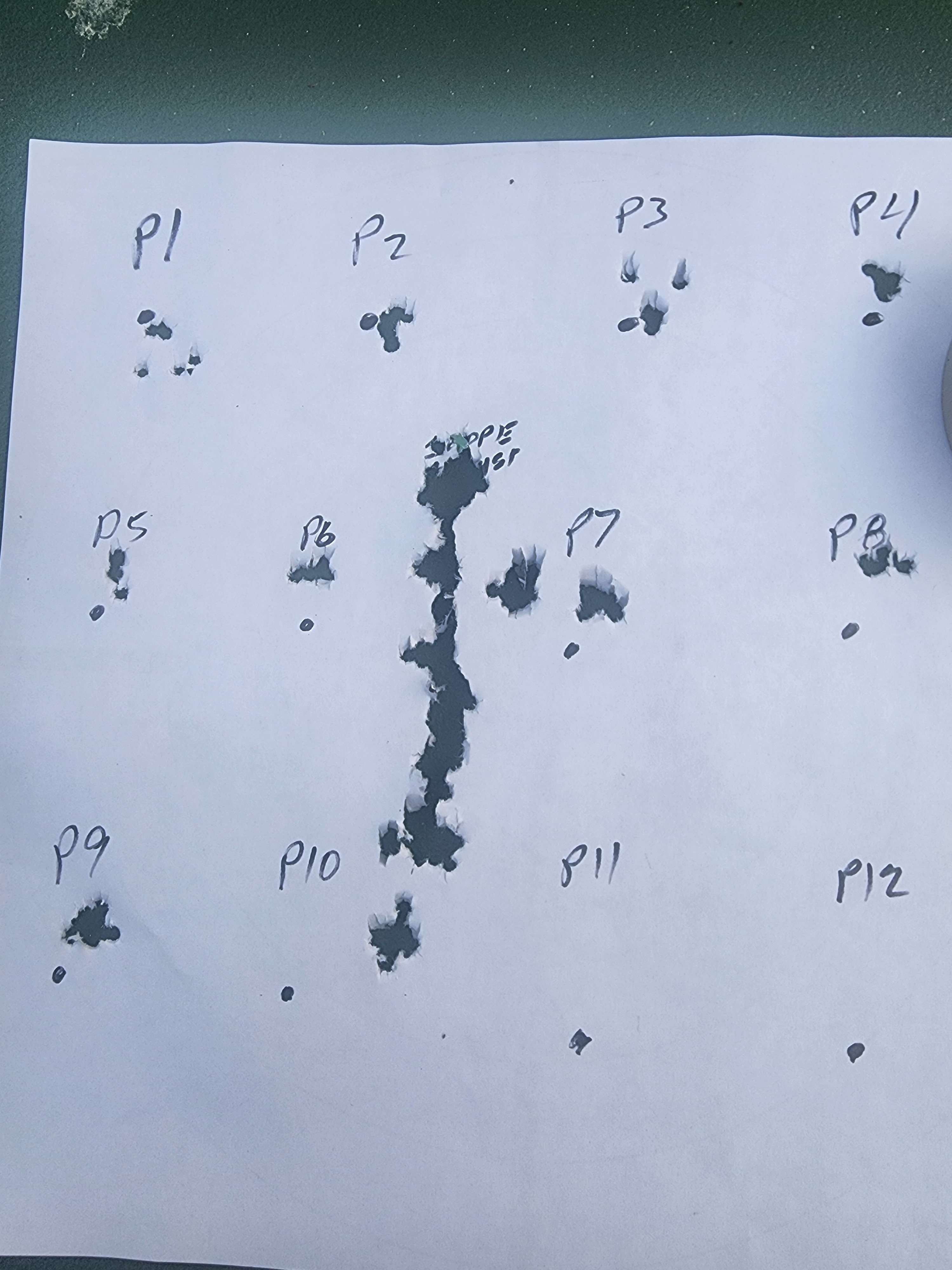

Ok, I went out today with the JSB Exact Jumbo Heavy at 18.1 Grain. Ran through the Power Levels from 1 to Power Level 9.
Power Level 1 Average - 598
Power Level 2 Average - 624
Power Level 3 Average - 701
Power Level 4 Average - 782
Power Level 5 Average - 829
Power Level 6 Average - 861
Power Level 7 Average - 901
Power Level 8 Average - 937
Power Level 9 Average - 951
Those were run from 250 bar down to 190 bar - 5 shots each level. Refilled to 250 bar, Power Level 4 - 120 shots before the speed appeared to drop off. The last 10 shots were up and down 917-221. Very little wind, 25 yards

Hmmmm - Pyramid Air
JSB Exact Jumbo Heavy - 250 count - $14.99 - $0.060 per round
JSB Exact Jumbo Monster - 200 count - $14.99 - $0.075 per round
She seemed to like the 18.1 at 920-930 FPS, I pulled the trigger it went where I had it pointed. Granted I started getting bored single loading 120+ shots.
Off to clean the barrel.
