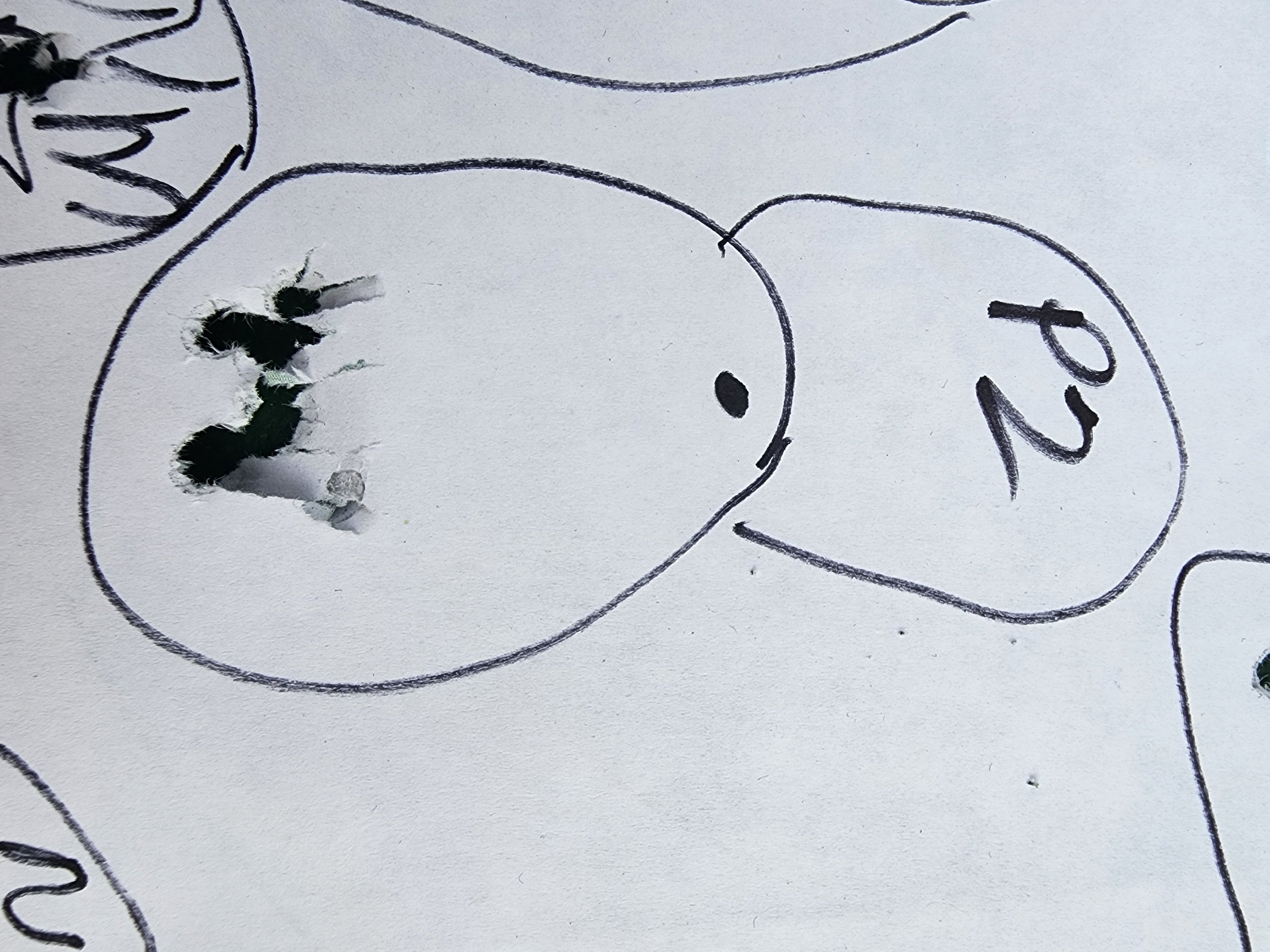

Power Level 12 - 1.320 X 0.644
Power Level 11 - 1.475 X 0.400
Power Level 10 - 0.981 X 1.229
Power Level 9 - 1.595 X 0.798
Power Level 8 - 1.303 X 0.964
Power Level 7 - 1.738 X 0.807
Power Level 6 - 0.904 X 0.588
Power Level 5 - 1.072 X 1.671
Power Level 4 - 0.672 X 1.450
Power Level 3 - 1.728 X 1.124
Power Level 2 - 0.208 X 1.540
Power Level 1 - 0.688 X 1.064

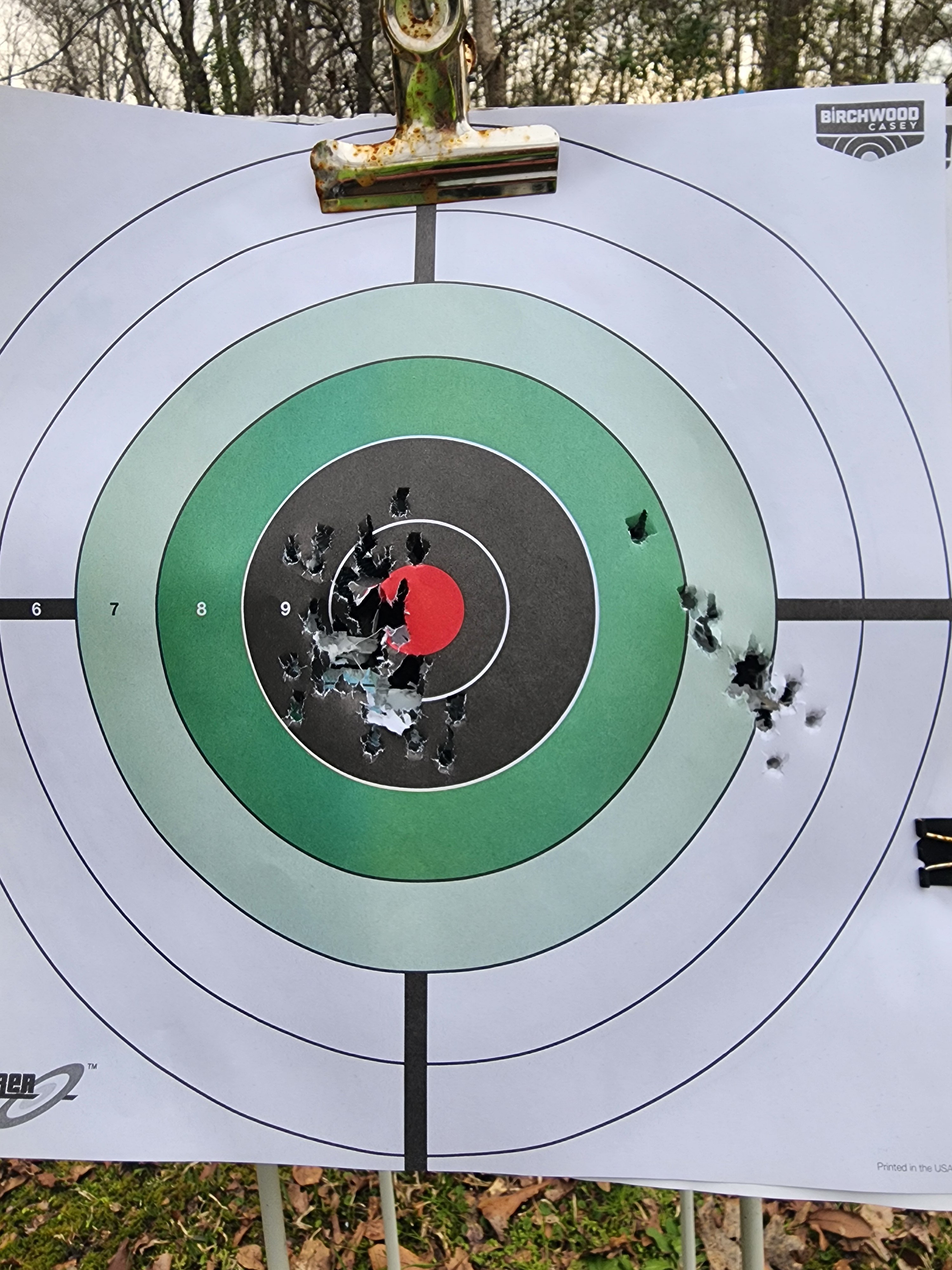

I than refilled to 3,500 and shot 66 shots with the Moderator at the green target, WHAT A MESSSSSS.

Something is amiss. @25 yards you should be shooting one ragged hole. What speed are the pellets going? I question the Monster juice too.
That's what I thought one hole, slightly ragged I could live - 8 MOA is just off.
