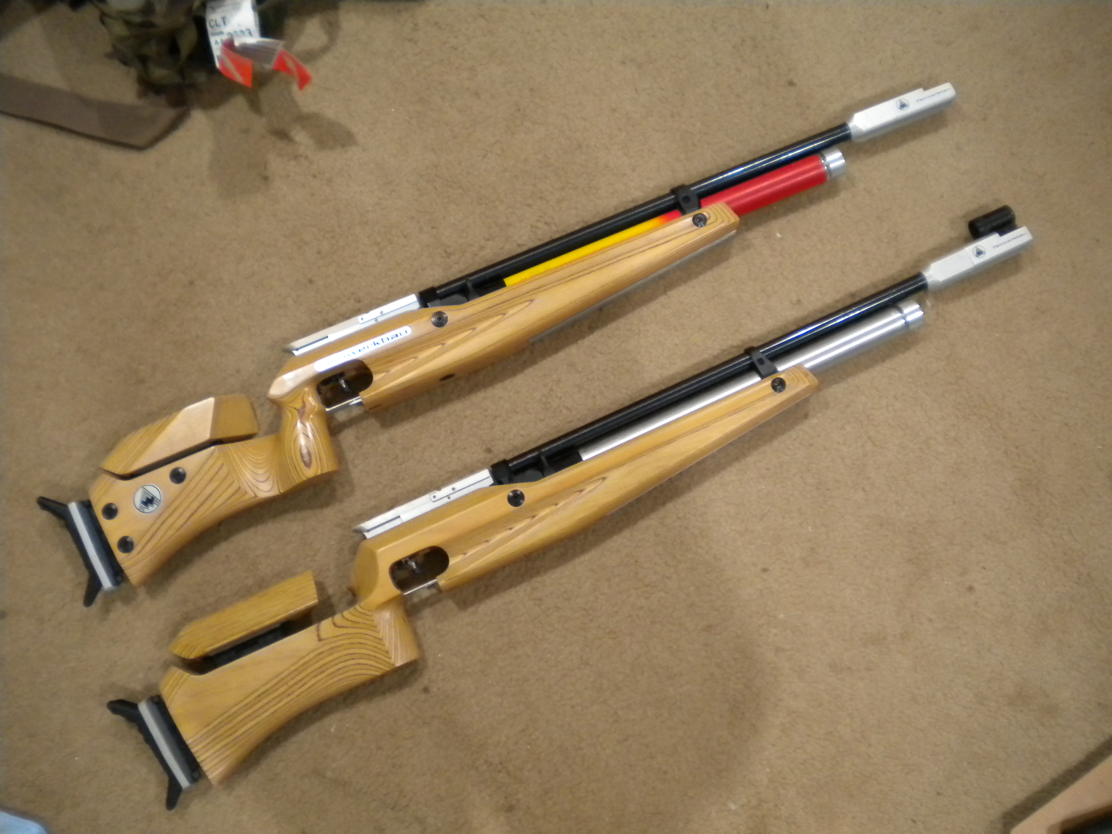

I bought a used FWB600 lefty for $600 and i see them around at shows for about the same price , maybe your on Ebay ? or several other gun sales sites ?
I trust what motorhead says , so i am going on that information . I do not Think the 10 meter version is sold in USA , but i will try to buy one if i can, but have you disassembled those and measured the inturnals ? it is a 28MM piston and is it the same stroke length ?

North Charlotte NC USA. At the end of this year, I sold two fwb 600 series that I didn’t need for $1,200 each. One went to MO, the other to CO.A buyer from Colorado wanted to buy another one for 1200.

You write about something you have no idea. I have more than 30 German rifles, and sometimes 50. There are several Dian 54s, including one 7.5J for use in a 10m tunnel shooting range, it differs only in the spring! I have FWBs also. The FWB 600 series is not a spring-piston rifle, it costs $800-950 and is very difficult to get.

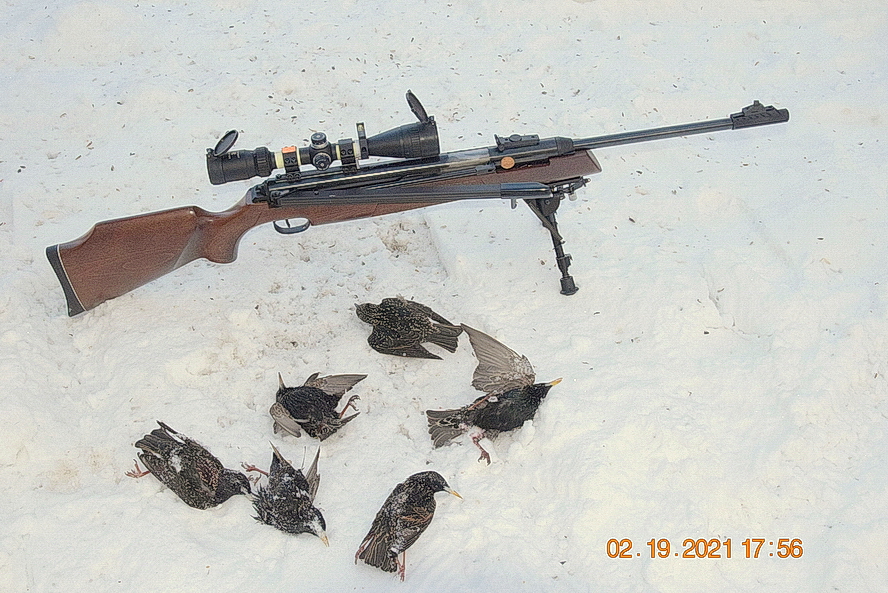

I have plenty of .177 rifles. An Anschutz 2002 & a 2001 ten meter guns. A FWB 300S U too. Nothing is remotely close to a starling rifle. The photo is of a 2002 SuperAir with an 8X Unertl.

I'm now 76 yrs. old and it is time to reduce the cocking effort of my .22 RWS 54. This is my starling gun.
I have to be able to cock it while lying prone on the breezeway floor. Velocity is not necessary. Right now I'm getting 764 fps, but only need 500 or so. Heck even 400 fps is plenty for birds at 16 yds.
Who has a decent replacement spring?
And no, I don't want to cut coils, forge & grind new ends, etc.
