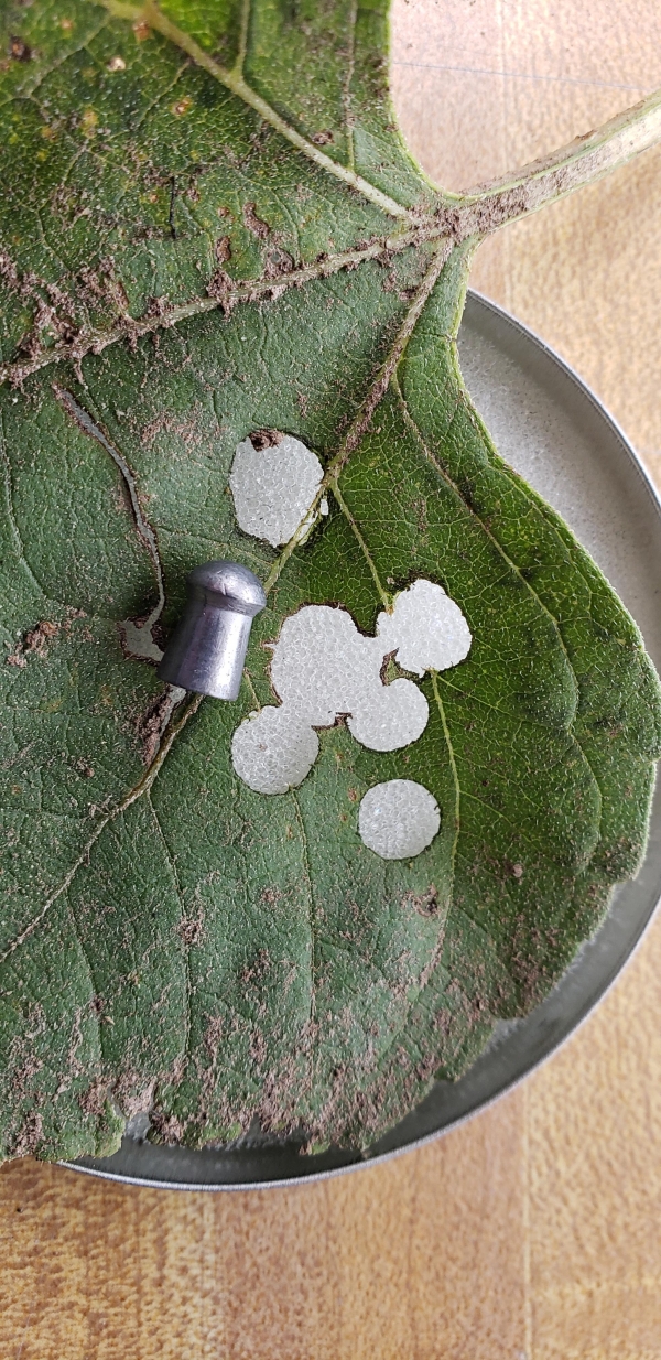

Here is a 10 shot group I shot on a sunflower leaf at 80 yards. 5mph crosswind, JSB Redesigned 22cal, 25gr going 960fps out of the RW HP. Pellet has been working very well for me.

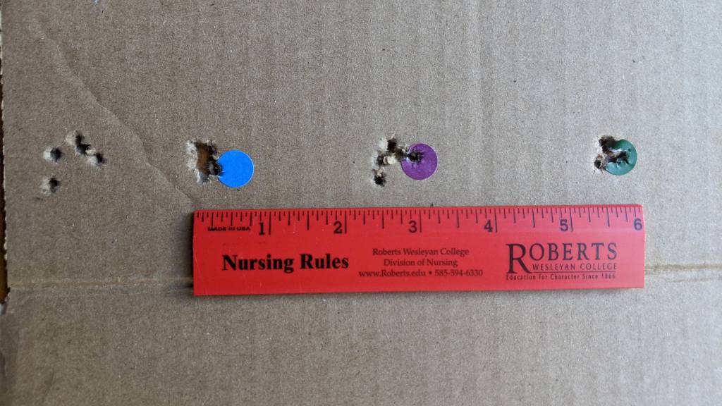

Accuracy is looking promising with my new (Thanks AoA!) barrel. Here are my first 20 shots (5-shot groups) with this new barrel at 50 yards.
