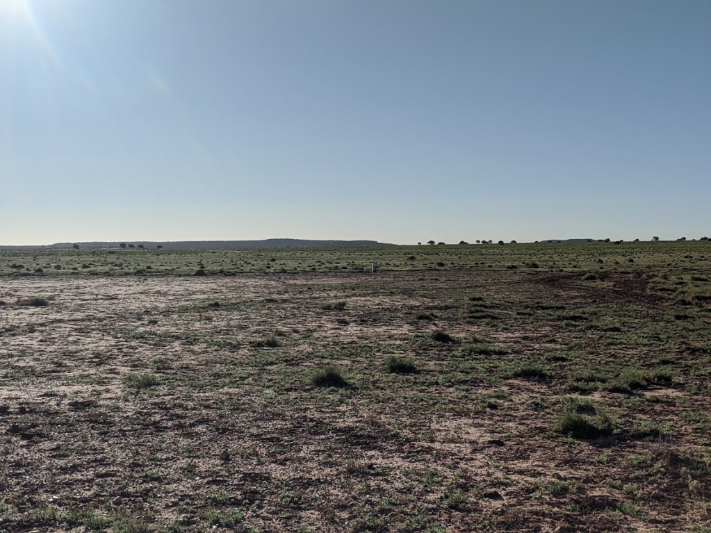

Yesterday morning my schedule worked out to give it a go. I can get to 60 yards at my house, but further than that means a relocation of the shooting fun. The winds have been bad lately, and I was hoping that getting up early would allow me an hour or two of semi-favorable conditions. An alarm clock set to 430 found me about 3 miles from home, out on my families ranch, ready for the sun to peek up and get light enough to see to do some shooting.

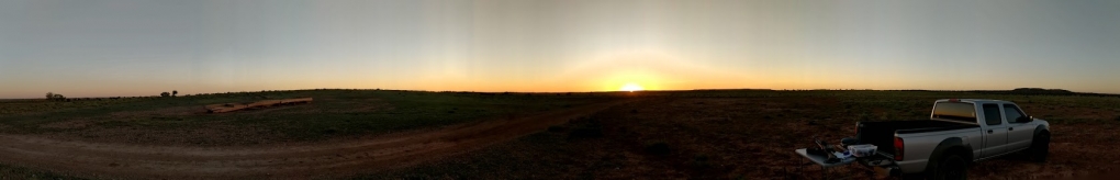

This is one of those panorama setting pics. It's much cooler on a device that allows you to pan, but it's alright as a still. Sun juuuuussstttt peaking out here. Targets are set up and ready to go, just over the top of the tailgate. It was chilly enough that I had a sweater on and was still shivering. Nights in the high country, even in the dead of summer it cools down pretty good at night. (5600 feet above sea level)

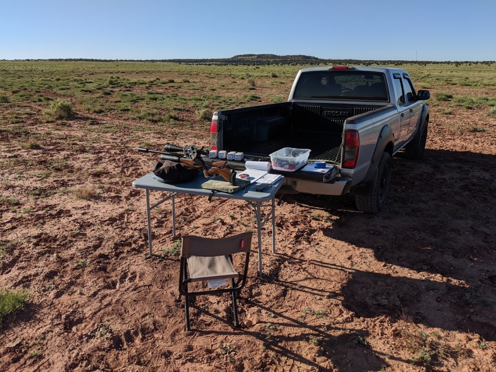

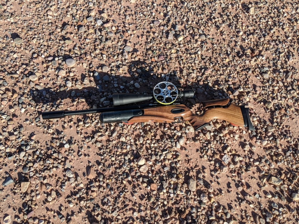

The set-up with more light.

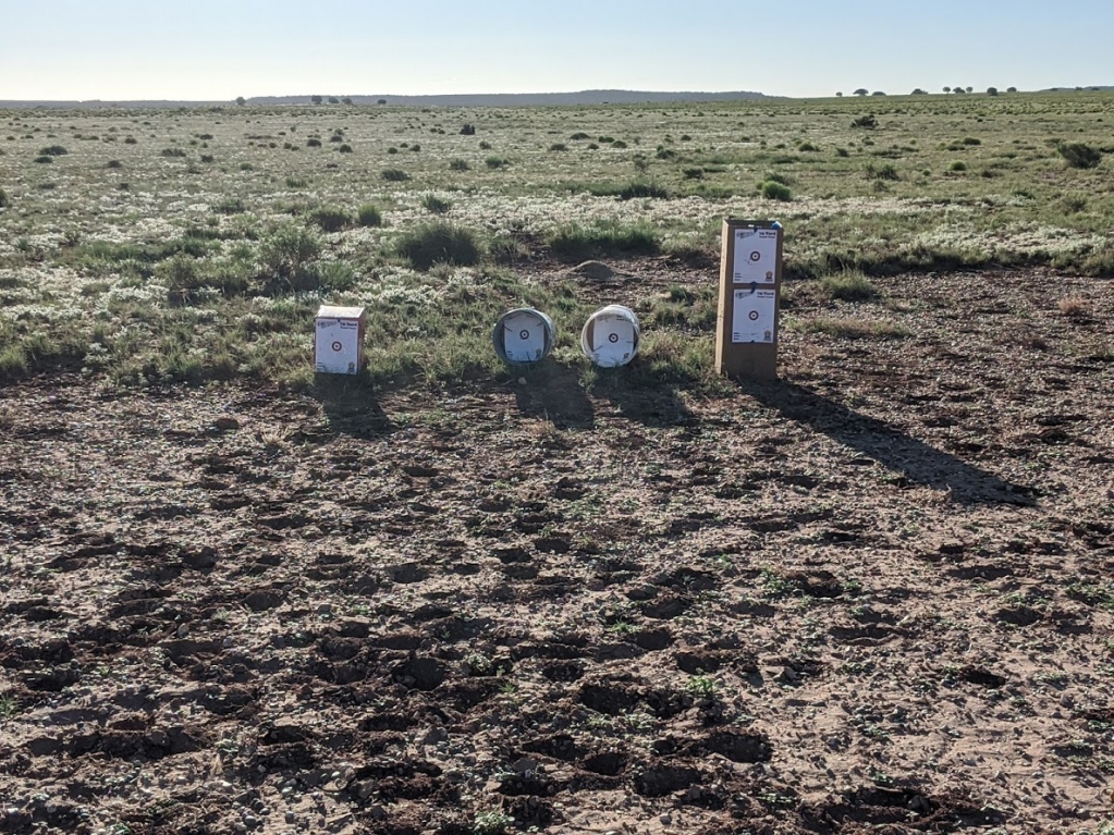

Targets there at the edge of where the ground cover starts, no magnification here.
A little bit of a ragtag target situation, but I was trying to minimize trips out and back so utilized a few different paper holders.

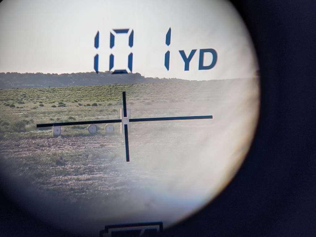

The EBR printed target says 75 yards but all shots were taken at the lasered 101.

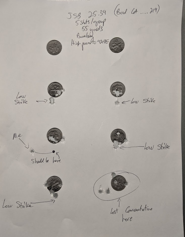

First up: lot ending in 219
This first one is a 10 shot group, This was before I had the scope dialed in very good, and was just holding dead-center.
6? shot group-dunno what happened here as to # of shots, likely too early in the morning for my brain to be able to count to 5
5 shot group
It was at this point that I got frustrated with the low-striking pellets. Out of every 5 or 10 shots, there were a couple that would hit low. Pellets were being plucked straight out of the tin. If this was to turn into a long-range benchrest competition situation, I would be weighing and sorting these bad boys, hopefully to exclude those low striking ones.
So, I went digging in my little plastic tub of Red Wolf paraphernalia (can be seen sitting on the tailgate) to see if any of the other RD tins were a different lot#, success, there WAS a tin with a different lot#.

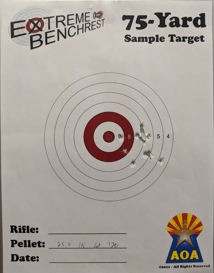

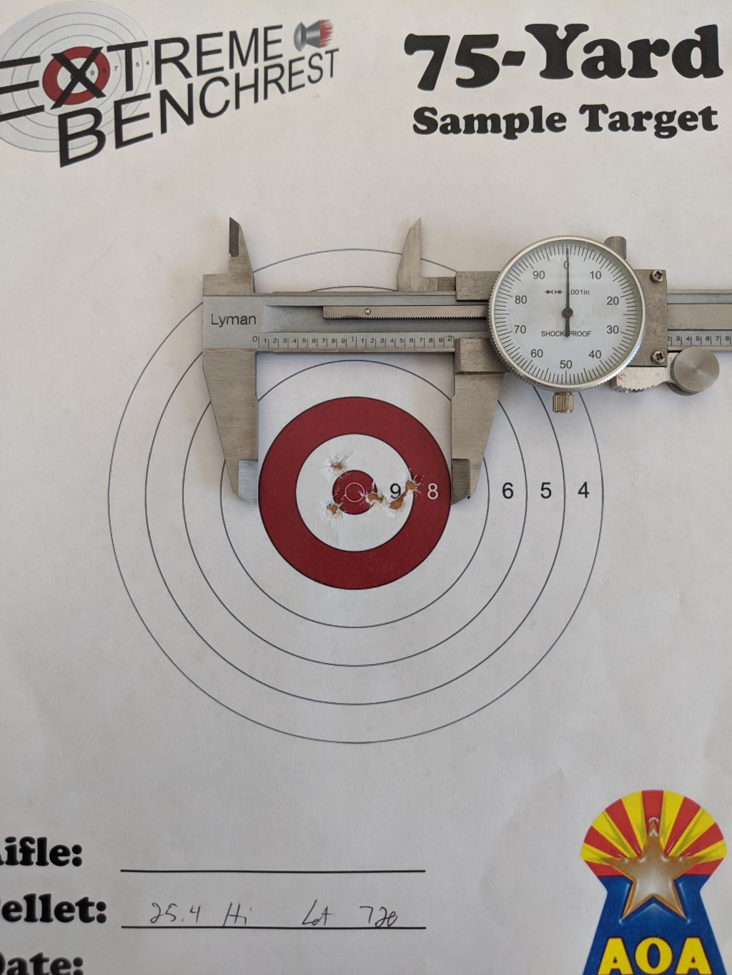

Next: RDs with lot ending in 720
First group after switching lot#s was the high point of the 101 yard shooting. Only 5 shot group, but no way I was going to keep shooting and try my luck to do it 5 more times for a ten shot group. Didn't measure it, but I believe I've got a couple 10s in there and the rest are 9s.
10 shot group here, this is when it had gotten warm enough for those left to right thermals to kick in
11 shot group here (can't count), and less than 5 minutes after the left to right, the wind came up and I was getting right to left shift.
This lot# seemed to be more consistent than the first, and resulting groups were better.
I could see what the wind was doing from the dust that was kicking up with the pellet strikes behind the targets. The little cloud of dust was easy to watch to see the wind currents, although after the fact and just a little too late to be useful for the shot that I had just taken.

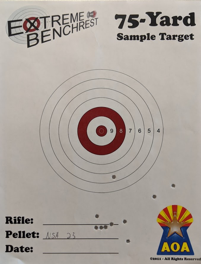

NSA 23gr, 0.217, ten shot group. These fit REALLY tight. I wasn't impressed here. There's a little cluster, but the other shots that aren't in the group, were't me.

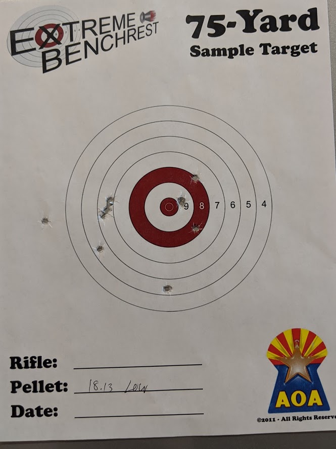

JSB 18.13 on LOW (28-29fpe)
The wind was moving pretty good now, but I wanted to take advantage of the situation so decided to try some long range groups on LOW.
Ten shot groups, man that wind is tough on pellets compared to slugs.
10-11 shot group here. But there's 12 or 13 holes in the paper. The two (3?) right-most holes are actually going the wrong direction. I had only taped the paper in the top middle, top bottom so it had folded over on me with gusts right when these pellets struck.

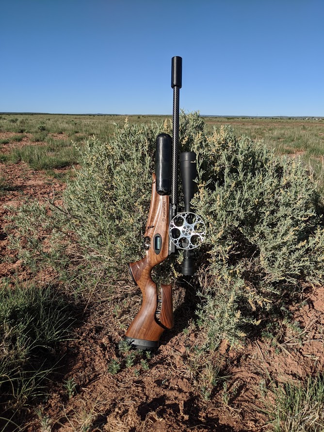

Glamour pics taken on the way back in
Old weathered lumber meets new classy lumber

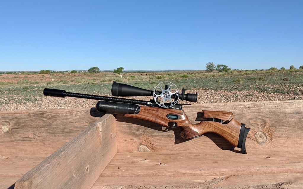

RW was not harmed in this pic, pellet tins between rocks and gun. Morning sun cast some shadows and the pic didn't turn out as good as I hoped for.

I threw some calipers on the best pellet and the best slug groups this morning before I left the house, per your request.
I'm measuring that best 5 shot Redesign group at 0.835, center to center. So, sub-MOA at 100 yards.
I'm getting the best 10 shot slug group (NSA 20.2/0.217) at 1.533ish.
For the rest of the groups, the outer edge of the red circle is exactly 2 inches. That should give a pretty good idea of what size groups you are looking at.

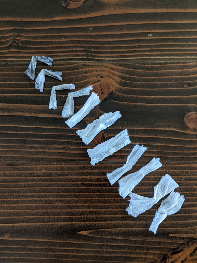

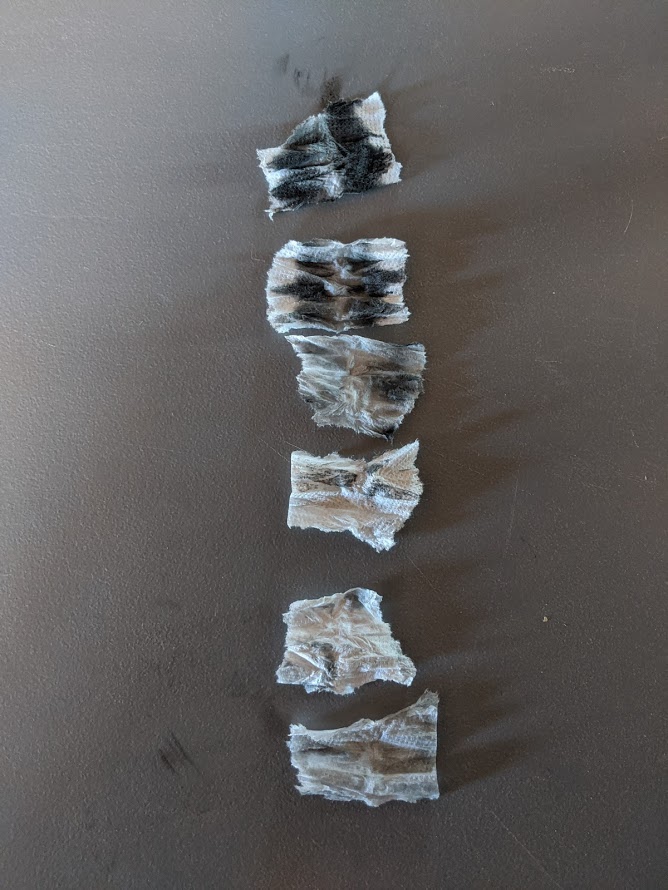

After going out and doing the 100 yard groups, I decided that I wanted to pull a few patches through the barrel to de-crud. I haven't seen a loss of accuracy due to the RW barrel being dirty yet, but I didn't want to get to that point in the middle of a match. Pulling patches through a barrel with the oring in a groove in the barrel carries the risk of messing up that oring, but I chose to take the risk rather than possibly lose my dope data/scope zero by removing the scope and barrel.
This was what came out:
It got clean quite quickly. It was very similar to some patches pulled through when I first received the gun. I realized I had an old picture of those patches and now is as good of time as any to share, since I'm already talking about barrel cleaning.

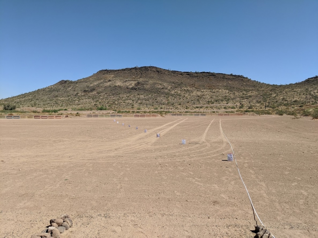

The sight in range:
(just a little different scenery than the beautiful Ponderosa pines up north, between you and me, I prefer the high country)
During sight-in I figured out that I was needing an extra MOA (8 clicks) at 55 yards and nearly that for 50 yards (6 clicks). The rest of the dope was spot-on. That is pretty typical of the difference between 5600 feet where the work-up was done, and 1800 where the summer matches occur. That denser air at lower elevation causes the pellet to drop faster at the far distances. I also was needing 6 or 7 inches of hold-off for the wind coming in from about 7 o clock. At this point I was thinking the day was not going to go well. The wind seemed to really be grabbing those .22 pellets. More hold off was definitely necessary for a 14.35gr doing 792 than my usual 10.34gr doing 920. There's a reason FT shooters mostly use .177, easier in the wind than the big heavy stuff moving more slowly.

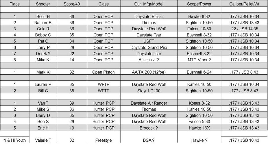

The match director didn't have a Troyer factor figured out this month, but I kept notes on what I ranged the targets as. I had 19/40 yards on one lane, with 25/54, 25/52, 32/44, 30/55, 14/44, 34/46, 25/32, 14/25 on the other 8 lanes that I kept track of. I forgot to write down my yardages on the last lane but I think it was around 30 and 55 yards. There were a couple pretty long targets, but most had generous kill zones. Were it not for the wind, it would have been a very easy course. The wind was from behind us, and switching back and forth from either shoulder. There were far targets that I needed to hold 5 or 6 inches to the left for one shot, and the very next shot on the same target needed that much hold-off to the right because the wind had switched. It was tricky.
I ended up shooting 36/40. Much better than I thought I would with the .22 handicap, especially when I saw what was happening to my pellets during sight-in. Two of my misses were the wind. One I held at 9 oclock and got pushed all the way over the top of the kill zone to the left, so not enough hold-off. One I held about 1 inch upwind of the target and the pellet hit right where I was holding, so too much hold-off. I completely pulled one shot. My final miss hit at 6oclock and I thought I had a good trigger break. I dropped that target on the second shot without making any scope adjustments, I'd like to blame that one as a bad pellet but I could have been the weakest link in the chain again there too. In conclusion, the RW did what it needed to do. My less than stellar score is a matter of physics (larger pellets making it harder than necessary) and shooter error (pulled shots and misread wind). I can't complain there.
There were three other shooters in my class that also shot 36/40, so by knocked down targets, we had a 3 way tie for first in Open Class. We'll sometimes have shoot-offs in this scenario, but I think we were all done getting cooked by the early summer Arizona sun, and we defaulted to breaking the tie by who had the longest runs without misses. My 4 misses were scattered throughout my 40 shots, so that put me in third for the tiebreaker, the other two 36/40 shooters had their misses clumped together. There was also a Hunter class shooter that shot a 39/40 (good job Van)!
So, how'd the Red Wolf .22 do in a FT competition? Well, when looking at all the classes, out of 17 shooters, only one person had a better score, and 2nd place was a four way tie. The argument that the Red Wold in .22 can be stretched to be a competitive FT gun still holds. The one-gun challenge that is part of EBR is pretty much the essence of this experiment with the RW. Can it shoot pellets accurately out to 100 yards? Yes, it'll do sub-moa. Can it shoot slugs for long range critter knocking? Yes, also sub-moa. Can it, not only be used for FT at lower powers, but also be competitive? Most certainly.
Check out the full match write-up by our match director here:

Extreme long distance airgun shooting (for me)
Next, I did a little shooting at prairie-dog sized targets, similar to this:
Using the NSA 20.2 in 0.217, I was able to connect at 147,148,151, 171 yards, lasered. The 171 yard shot was ridiculous. I was out of elevation and holdover for that one. I had to shoot with the target out of sight under the scope and then move the scope down to see the hits. Took a few to walk it in but I was able to connect on what was mostly a hail mary shot. Those slugs sure seem to hit hard and don't need nearly as much windage as I would have expected. My furthest airgun hit prior to this was at 144 yards, I was on cloud 9 after beating my own record 5 times in one morning. After seeing how much further they can extend airgun ranges, I can kinda see the slug push (although I still think they're only safe for non-populated areas like the ranch pictures shown above).
Just a little sagebrush action
Something about this corner pic seemed like the ranch in a nutshell, old weather juniper fence posts, rusted barbed wire, mostly sand, a little grass, tumbleweeds piled into the corner fence, and a dried up cow pattie there in the bottom left. Just had to slip the RW on that nice soft bed of grass to make the pic relevant.

I came back to the RW in the same afternoon, just at 20fpe with 14.35JSB. I cleaned the barrel and reconfirmed my FT dope chart to make sure that nothing had gotten bumped or barrel leaded up or anything else that could mess up my FT competition this Sat. I'll do a much shorter write up on that confirmation process.

This is my true to dime-size dime target. 6 groups of 5 each.
I lost concentration on the bottom right one, so disregard it. But on the rest it is interesting to see that the pellets wanted to group in the lower half of the dime. The upper right was my best group and that cluster of four seemed to be where the gun was zeroed. VERY interesting to see the trend continue here. A couple (1 or 2 in the case of 5 shot groups here, or 2 or 3 in the case of 10 shot groups) out of every group hits low. It is not hard to extrapolate this out to 100 yards. If there are a couple pellets out of every group that hit 0.25-0.5 inches low at 55 yards, it's only going to get worse at 100 yards. Very interesting.
So the continuation of that trend with the wonky 219 lot was cool to see, but I was also able to compare bumbag to benched shooting on HIGH. It actually wasn't as difficult to shoot from a bumbag on HIGH as I thought it might be. I pulled some shots, but the overall accuracy results weren't that much worse/better than what I can do off a bench. Especially that upper right dime. Were it not for inconsistent pellets, I'd be looking at 5 shots into something like 3/8 inch. I could sure tell it was shooting 42fpe though, when comparing the pulse to what is experienced when shooting at 20fpe.
