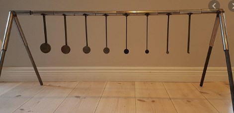

Field Target!
Alright, it sounds like my club is going to try to have a match on the 23rd. That means I better get serious about FT with the RW, in case I decide to make that match. I've been having so much fun shooting with various projectiles at each of the power levels, that I'm not at the level of comfort that I'd like to be, this close to a potential match. So, that means lots of sitting on a bum bag in the next week or so, basically all my spare time for shooting needs to be with my rear-end on that bag. I was able to do so for around 90 minutes tonight and I've got impressive things from that shooting session to report on.
First off, I'm still not 100% sure on the pellet that I'm using. I've been working with 2 tins of JSB 14.35 that I bought a couple years ago, and those had been showing pretty good accuracy during the chronographing/programming. 2 tins isn't enough to work up, practice, and compete with in FT, so I ordered up a sleeve from AOA. They got here some time in the last week. ArzRover also came good on his promise of some vintage Crosman Premiers from the good ole days when they were incredibly consistent. Those CP's did REALLY well on a 50 yard Know Your Limits target on Weds when we were shooting for fun. For those unfamiliar. the KYL targets are part of the .22 rimfire tactical game, and look like this:
The smallest is 1/4inch I believe. Start at the biggest and work your way down. I think in the official rimfire comps you can stop when you think you've reached your limit and take those points, or keep shooting, but a miss loses all the points. Well, with the initial CP testing, I got all of them with 2 extra shots (and I think the smallest one the pellet hit about 1/2 inch up the stem). Conclusion: the CP's seemed to be mighty good on Weds on the KYL.

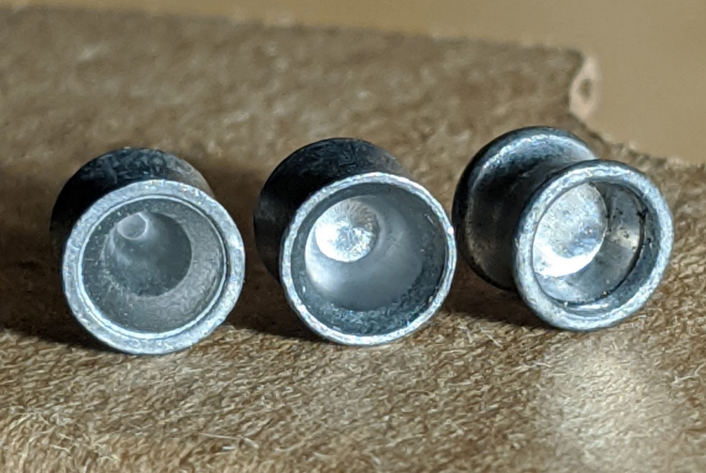

Edosan's current post about the different skirt profile of the 25.39gr Redesigns reminded me that I better make sure the new sleeve of JSB 14.35gr is the same as those 2 old tins that I've had. Nope, they're not. So, I've got three pellets now to decide from for FT. Old 14.35s, new 14.35s and the CPs. Here are what they look like (Old on left, New in the middle, and CPs on the right):
More shallow skirt depth on the new ones, also differences in outer rim thickness and the length of the main angle from skirt rim to where it dives into the deepest portion of the skirt. Enough different that I'd like to segregate them out, especially for competition. (Asked my kiddos about what they had in their sticker stash so that I could positively identify those 5 tins from the new sleeve. They came up with some Minion stickers, so the tins in future review pics with a Minion sticker are the New 14.35).
Not much difference in outer appearance, maybe a little bit different skirt angle and waist circumference between the old and new 14.35s.

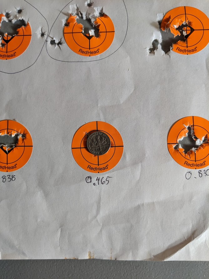

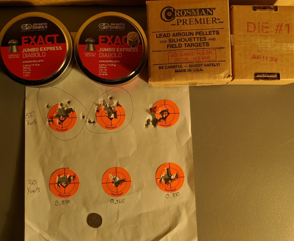

That all leads up to the testing that I did tonight to answer the following question: which one is the most accurate (basically which one is getting used in competition and will therefore be used to map out all my impact points from 10-55 yards)?
I devised the following little comparison...
Two row of three orange stickers. The stickers are big enough at this distance to be gimmes, but I wanted to shoot a pretty large count group and the middle gets torn out pretty quick doing that. Then it's hard to know where the aimpoint is. The orange stickers have crosshairs so that the center can be lined up with for quite awhile after the middle is shot out (ended up being too unsteady for this to matter much but anyway). One row of stickers shot at at 30 yards, the other at 55 yards. Five shots at each target with each pellet at each distance, rotate through 4 times for a group size of 20 shots (reasoning being to get an average wind effect over all three groups). All the 30 yard targets shot first, then move it back to 55 and repeat.
(20 shot groups if the above paragraph doesn't make sense to you)
And all of that from a bumbag.
Top row = 55 yards. Bottom row = 30 yards. Two left stickers = old JSB. Middle two stickers = new JSB. Right two stickers = CP.
(Sorry about the crappy lighting.)
After that I decided I better weigh a small sample to answer my curiosity about consistency between them all.
Old 14.35s - 14.4, 14.4, 14.4, 14.4, 14.3, 14.4, 14.4, 14.4,14.5, 14.4
New 14.35s - 14.5, 14.4, 14.4, 14.4, 14.3, 14.5, 14.4, 14.4, 14.4, 14.5
CPs - 14.3, 14.4, 14.4, 14.5, 14.4, 14.4, 14.1, 14.2, 14.5, 14.3
I only weighed ten of each. I hate weighing pellets, and even for FT comp, this is usually the extent of my weighing. I'll sometimes do a small sample of a new tin of pellets like this just to make sure they're fairly consistent. There was a 14.1 peewee in the CP's but overall plenty consistent (Many will disagree here but FT is not really a precision game. It's a consistency game, and I'm talking about consistency of the shooter. My general approach is that it is a better use of time to shoot the gun, A LOT, from the position you'll be using for FT. A long time ago, while watching the crosshairs dance around, I decided that the human part of the equation is a lot bigger factor than a pellet being off by a couple grains. That crosshair movement, whether due to heart rate, or breathing or whatever, is way more influential on where the pellet is going than a slightly over or underweight pellet. Of course I mostly shoot at monthly club matches, and I'm sure I've missed a few points from non-perfect pellets, but I still feel like more time spent shooting the gun is a better use of my time than weighing and sorting pellets.)
Thoughts
These were shot pretty late this evening, with the setting sun at my back. That lighting situation allowed me to see most of the pellets in flight. Let me tell you, no wobble, no spiral, no what-the-H-was-wrong-with-that-pellet. EVERY single one of the shots I took tonight, with all three pellets, flew as perfectly straight as any pellet can fly. It was beautiful.
Impact points were quite similar for all three. I mentioned a while back that all the impact points are vertical, for each of the projectiles from each of the power levels, there's still an upcoming report on that, but it is simply convenient when various pellets at various speeds hit in a vertical line (vs hitting off to the left and right like they usually do when swapping to a different power level or pellet). If anything, the new JSB might hit 2 or 3 clicks (1/8moa) high at 30 yards, the other two seemed to be right on though. All three needed about 45 clicks at 55 yards. I'll get that pinned down a little better, but initially I'm thinking they've all got a pretty similar BC, otherwise I'd have different vertical impact points.

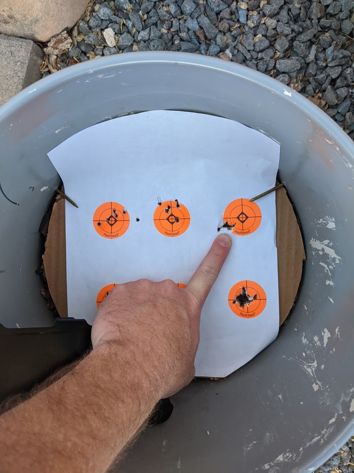

At the beginning of the shooting session I took the chrono out at distance to try to get an ACTUAL BC and compare them for these 3 pellets, but the sun was already down too far to get readings. I'll probably figure out the BCs, just cuz I'm curious.
I like to take my shots with the scope at 20x, I've just found that I'm more accurate like this. Looking through a scope, I've never been able to get a feel for how big a group is. Only after I've walked up to it, and SEEN it up close and personal, do I realize how big or small it is. I thought I had some pretty decent groups there at 30 yards, but didnt realize just how good that New JSB target in the middle is, until I walked out to move it to 55 yards. This is a close-up of the same picture posted above.
That bottom row middle target has 20 shots, taken from a bumbag, UNDER A DIME! Yes, it's only at 30 yards, but still, this was NOT taken from a bench. It actually measured out to 0.465 inches. That's 20 shots under half an inch, from an Open class field target position. A 1/2 inch killzone at 30 yards is a Troyer 60......and the gun put 20 shots into less than 0.5inches. WHOA!!! The other two groups are also quite good, 0.8 inches or so.
So, I get it placed at 55 yards, walk back, still trying to wrap my head around how good it shot at 30.....Take my first 5 shots with the CPs and I just had to walk back out and take a pic of the first 5 from the CP's at 55 yards before I shot the other 15 at each sticker.
Yep, they're all in the same hole (not hole in hole Centercut). It is the coolest feeling to sit on a bumbag and watch all five (or more if you're a really lucky son of a gun) pellets arch up and down in a perfectly straight line, and drop into a shared hole like this. It instills just a slight bit of confidence in a gun. Sarcasm there, it instills A TON of confidence in what a gun is capable of!
There are some "flyers" not in the main group there at 55 yards. Every single one of those was my fault. I was getting pretty shaky there at the end and most of those wayward shots were taken on the last round of 5 shots at each 55 yard orange circle. I'd already shot 60 or 80 shots before I started the page I shared here. So I was at least 200 shots into my first serious bumbag session for quite a while. My shooting technique was suffering pretty bad there at the end. (also cool to shoot that much without needing a refill, the RW at 20fpe is awesome for shot count and long FT practice sessions like this)
So which pellet? Of these three tested tonight, all three of them are good enough to shoot a very respectable FT match score. I could not definitively say that one did better than the rest, mostly because the misses were on me, not the gun. Some of the groups are better, but only because I was able to avoid a bad trigger break during that group. I'm not a good enough shooter, or at least wasn't tonight, to see an obvious difference. I'm kinda leaning towards the new JSB, just because I've got most of 5 tins still.

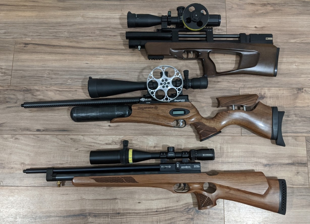

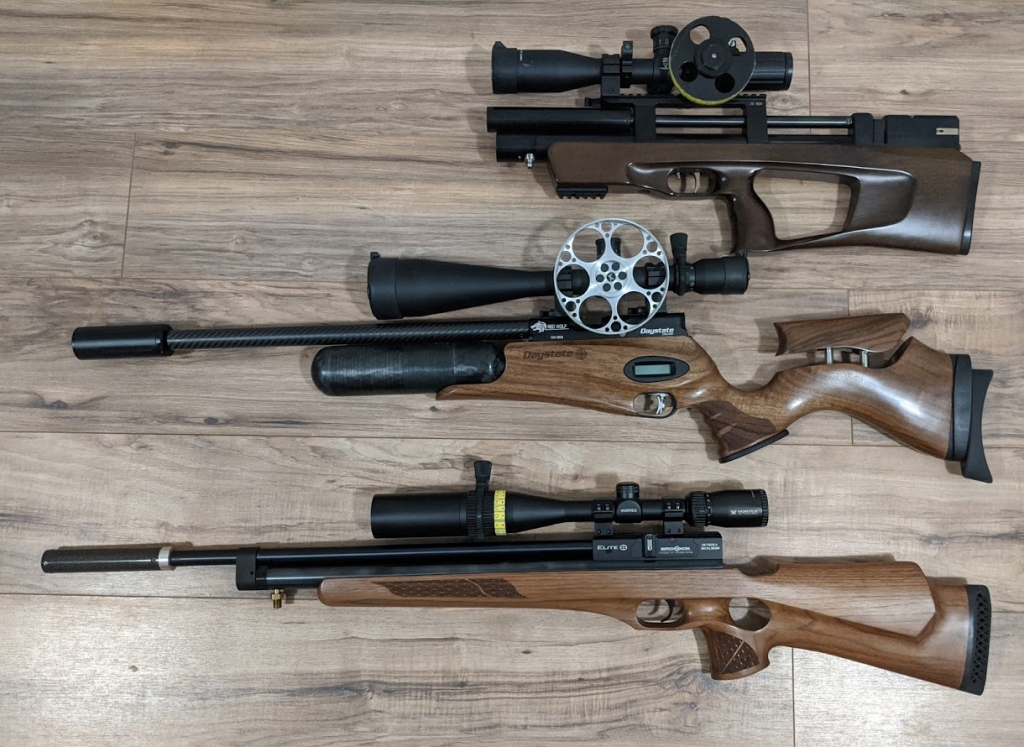

My Veteran is a .22 and setup for 20fpe, and I've shot it a lot! I think I'm 14 or so tins through that thing now. So I feel like I've got a pretty good handle on what light .22 pellets do around 20fpe. I was shooting in 8-10mph winds today and I'm amazed at how much less windage is necessary for the 20fpe projectiles from the Red Wolf when compared to how much is needed for 20fpe projectiles from the Veteran. I came across a British term during the BSA review, the claim was that it "takes less wind," and basically is the concept of a certain barrel/pellet combo doing better in the wind than it should. Well, I may be singing a different tune on a more windy day, but from what I saw with this RW this evening, it certainly "takes less wind!"
I am absolutely loving the overall length of the RW with the Donny Tatsu on there. My main FT gun is a long beast, with a long moderator on it. Carrying the main FT gun through doorways (going from tank area to shooting area) and/or shooting it, feels like handling a broom. This RW is just about perfect in length. It's long enough to give that stability that comes with rifles, but not so long that it's a nuisance. I snapped these pics this evening, when thinking about how pleasant the RW length is:
Nothing beats the 24inch Veteran for overall length, but that shortness makes it hard to shoot too. The other gun is a Brocock Concept with a Rocker1 moderator. The RW is shorter than the Brocock, and this particular Brocock has always had that nice compact rifle feel. I'm really liking the Red Wolf length for a general/multi-use gun.
(And how about Bobby coming up with a sealed box of pristine Die #1 Crosman Premiers from 1999! Really good pellets, they dang sure don't make them like they used to. The old CPs from that time-frame have a legendary reputation, at least amongst the FT shooters that were active at the time. I felt like I was being handed a family heirloom. And the worst part, I pulled the lid off and spilled them across the shooting bench on Weds! Luckily, only a couple hit the ground, and they're that harder Crosman alloy so they don't appear to have been damaged by my carelessness. Thank you for sharing some airgun gold from your stash!!!)

For Franklink's Premiers. .. they are 22 cal, Die 1... from 1999, I think. They really should be cleaned and some sort of lube applied , but his test protocol is right from the tin.

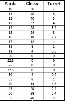

Prelim results are looking like this:
The scope the RW ended up with is a Falcon X50 10-50x60. It ranges extremely well. My only complaint with it is that it's 1/8moa clicks. I'm so used to 1/10mil click values that whole numbers on the turret make my brain go straight to tens, ie 1 on the turret = 10 clicks, 2 on the turret = 20 clicks, etc. But not on this Falcon. 1 on the turret = 8 clicks, 2 on the turret =16 clicks, etc. Just a hard habit to break. I usually only need two columns, one for yards and the other for clicks, but have been using the 3 column method when using this scope on a gun, in hopes of not having a brain fart in the middle of a match.
Those numbers will be verified and vetted throughout the week, and a final version will be printed and used as my dope card for the match next Sat. I'm liking the fact that I don't have any lapped click values. When using the 10.34 at 20fpe in .177 with this scope and a 30 yard zero, I end up with the 10-14 yard click values being more than one revolution of the turret. That's a recipe for disaster by getting off a revolution during a match. I think it's happened to most of us at least once. Anyway, nice that my values don't have anything past one full turret revolution with this RW FT experiment.

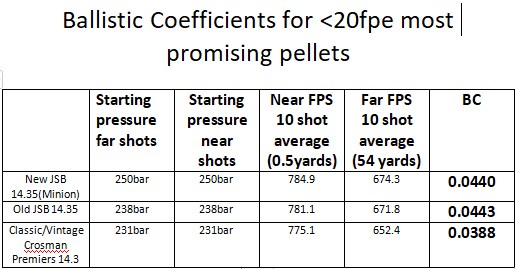

My process is different than most, as I like (well I don't "like" to, but I'm usually pleased with the results) to drag pellet traps back and forth and shoot at each of the distances to obtain an ACTUAL vs a ballistics calculator predicted value. I do however, like to compare what I'm seeing to Strelok as I'm going through the various distances. Actual click values set the precedent and are given more weight and the final say, but it's fun to compare to the Strelok program. It usually involves messing around with all the settings to get it to match up as close as possible. The usual suspects are scope height, BC, and zero distance. After all the chrono work prior to this stage, I view fps as a constant not to be toyed with at this point. So, I started out with a BC of 0.028 for these 14.35grain pellets. And the impact points were not even kind of matching up. I played with the zero distance a bit (I think I moved it from 30 to 25 yards) but the Strelok numbers were still way off. I finally got the Strelok numbers to match pretty good, by inputting a BC of 0.04. Seemed way too high for this pellet, vs literature values. So I decided to grab some actual BC values.
BC collection for the <20fpe tune
I've only got one old tired Chrony so I've got to do it the hard way, measure close fps, and then far fps. In an attempt to get a more accurate fps, I like to take the average of 10 shots from near and 10 shots from far. In the case of the RW, the exact pressure given on the screen allows for one more variable to be eliminated by taking the 10 near and the 10 far shots from the same starting tank pressure.
I plugged that 0.044 into Strelok after this, and was rewarded with predicted click values much closer to the actual click values I was seeing when shooting each distance. That is a pretty high BC and I was excited enough to text a friend. His response, "are you sure.....?" I don't think he could quite believe it. We discussed it a bit and I think we both came to the conclusion that my elevation of 5600feet above sea level is likely helping that pellet get downrange without hitting as many air molecules and slowing down as much. Who knows for sure, but I'll take it! Those pellets are smacking the crap out of everything that I'm shooting. They seem to be retaining a fair bit more energy than the usual 20fpe .177 that I'm used to. Bigger cross section to impact too, but the heavier weight is likely helping with retained energy. Fun fun.

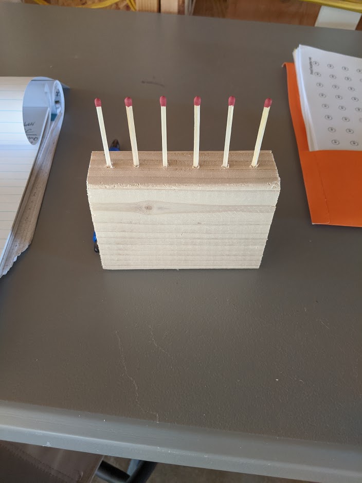

Plinking

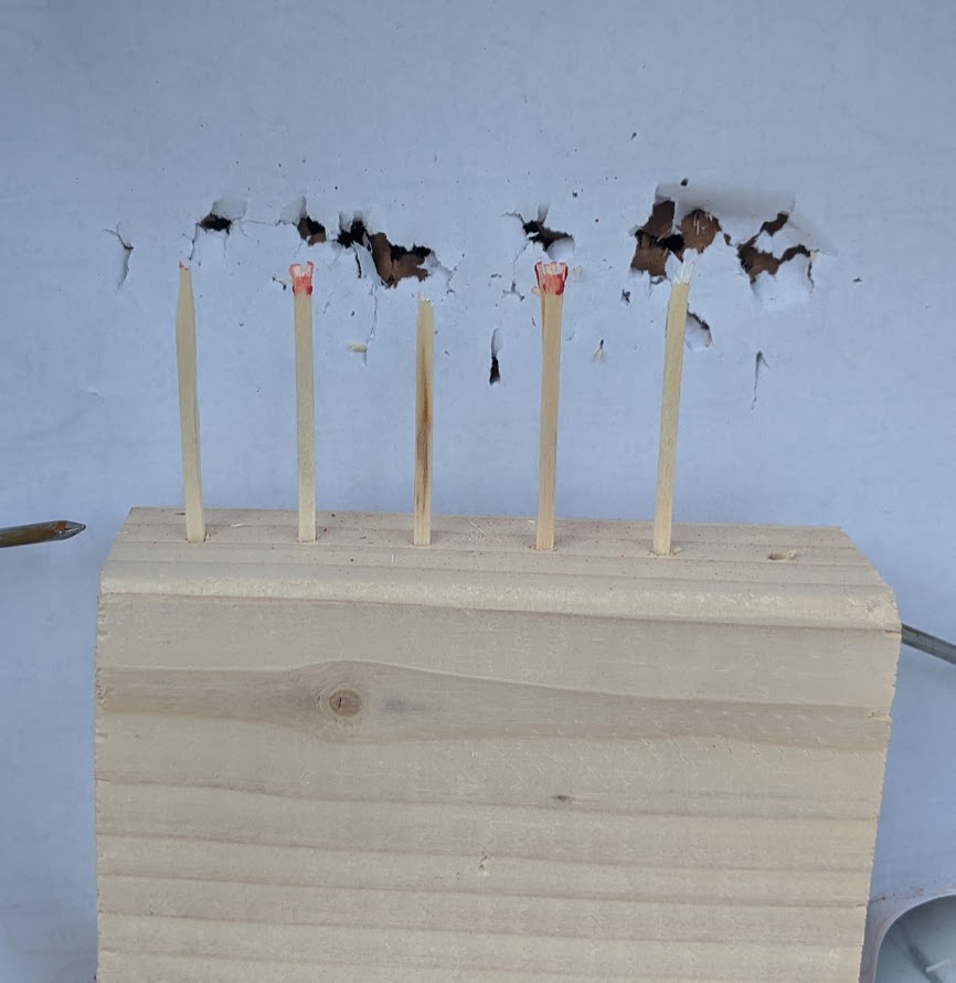

We lightly discussed how cool that BC is, and I told him I'm much more amazed with the accuracy. For some reason the mental image of shooting matchheads came to mind when I was trying to tell him how accurate this thing is. So, I decided to give it a try.
Couple holes drilled into a piece of scrap 2x4....
Decided on 30 yards, just cuz. Man o man was that a bunch of fun! I started out seeing if I could go six for six, ha ha couldn't do it. I was usually getting around 4/6. Then I decided I'd try to get it on scope cam, which made me decide to get it all in one take (mostly so I wouldn't have to do any editing, but also to help in making it believable....you know, "ah that guy just copied a bunch of clips together to make it look impressive.") That then led to me getting out the magazine for the first time with this gun, so that anybody who watches the vid won't have to sit through me slowing reloading each pellet. Mags are ten shots so the challenge then became, can I knock off all six match heads, at 30 yards, from a bumbag, in the wind, with one magazine. Lol, it took a few takes but here it is:
(couldn't get the reticle and image to be focused at the same time, but it's short so you won't have to suffer through it very long, if you choose to watch.)
https://www.youtube.com/watch?v=Z_sRVfcChnc
Here's the close up of the results from the vid:
Knocked #6 match out of the block, you can see it go flying in the video.
Took eight shots to get all 6 matchheads. I've got to admit that this was my best attempt. But how bout that eh? Shooting MATCHHEADS at 30 yards, pretty consistently too. Damn accurate gun, that's for sure.

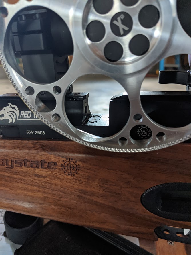

Magazine thoughts

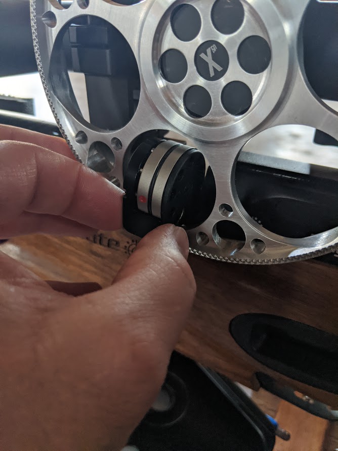

After my first experience with the magazine in the above video (and unshown attempts), the Red Wolf mag shooting was awesome. I didn't see any loss of accuracy. And man o man was it fun to work that lever and throw more pellets downrange. The biatholon sidelever, coupled with no hammer spring being compressed during cocking, and the magazine culminate into a VERY enjoyable experience. Think Ruger 10/22 plinking fun, just throwing lead downrange willy nilly, but with the accuracy and precision that comes with a $2400 top of the line airgun and you'll have a pretty good idea of how much fun I had with the matchsticks and the magazine.
I also found out that the mag only loads from the left. I've got a big honking sidewheel on this gun and quickly decided it wouldn't work. But I was wrong as I delighted in the realization that that big honking sidewheel has big honking holes in it, juuuuussstttt big enough for a mag, if the wheel is rotated into alignment.
(I named the file for that image, "lucky maghole." Something about that gave me a good giggle.)
The mag and the single shot tray are also loaded with some pretty serious magnets. They are quite helpful in getting both into their homes.
None of this going on,
cuz the magnet-assisted magazine and sst go right where they're supposed to, quickly and efficiently.

I was unaware that the pin in the mag could be swapped to allow loading from the right side. Kinda neat that that's an option.

That's funny that the holes in the sidewheel are just big enough to insert the magazine!
You have to do whatever it takes to get the dope in your app to match actual.....but .04-ish BC doesn't seem correct. I usually have to fudge something to get my app to line up close to perfect, it's usually at 10Y where I'm off a click or two so I just memorize the exact amount.
I'm wondering how many inches the actual drop was at 54Y was??? Did you use a tape to measure that distance or a laser range finder?
It would be interesting to put your scope into a scope tracking jig to see what the actual clicks are and if there is any tracking error.
Do you put your altitude into your ballistic app? Just an example - For my USFT, using SHOOTER ballistic app, from a 30Y zero I'm getting 2.2moa drop at 7300ft but 2.4moa drop at 1600ft DA down at BASF. This correlates when I go down to Phoenix to shoot a match vs up here in Flag and my dope is usually right on once I rezero for down in Phoenix.
Sorry to sidetrack, just thought I'd think out loud, might be a good subject for another thread later on.

The odds of the holes in the sidewheel being big enough, and properly located, are mighty small.

Yes, altitude was entered in Strelok. When this scope was on my USFT all the dope numbers matched, better than any other scope/gun setup actually. I was using 0.031 for a BC in that set-up. That was with JSB 10.34 at 920fps. I too have found a loopier trajectory with other guns when having matches down in PHX. It mostly affects the far shots it seems, I've always gotta give it some extra clicks for the 50 and 55 yard targets to fall.
Hopefully this RW and Bobby's Labradar find themselves at the same place at some point. That'd be the really interesting way to answer how come the BC seems to be so high.
I'll get around to checking BCs of other pellets at the other powers, will also be interesting to see if a higher than typical BC trend emerges there.

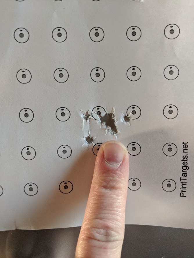

Here's ten shots at 55 yards:
I was going for the circle just to the left of my main group, so I was giving it more windage than it needed. Seven in a hole smaller than my fingernail, 3 outliers. The lone shot on the right was where I was holding for most shots and the wind died when that one was released. The two lonely holes on the left were big gusts that got pushed more than the rest, one even getting pushed down a bit (at least I didn't feel myself pull that one low).

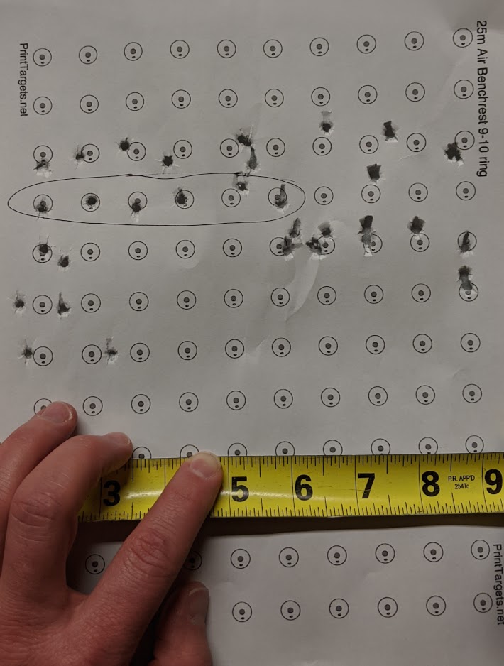

This one just has some random shots, again at 55 yards.
The series of shots I liked the most here are the 6 circled. Those were six consecutive shots, starting on the far left. You know you've got a pretty accurate gun when it'll do that in the wind at this distance. If you look at the tape measure by my pointer finger you should be able to make out the fact that these little circles are just a bit bigger than 1/4 of an inch and just a hair smaller than 5/16 of an inch.
I need to spend more time practicing in the wind, but initial thoughts are that it doesn't take as much as I would have guessed. I was giving it more than it needed for most of my shots. My assumption was that the bigger .22 would present a bigger profile for the wind to push on than a .177 at 20fpe. At some point with that theory though, is an overlapping grey area of a (seemingly) higher BC with the .22. This is kind of throwing me for a loop, because (as mentioned prior) my 20fpe .22 Veteran is influenced by the wind more than this Red Wolf/14.35 combo seems to be. Based on that, I had some preconceived notions that a .177 @ 20fpe was better in the wind than a .22 @ 20fpe. I'm not sure I've reached a conclusion yet, but it's fun trying to figure it out. In field target circles, the serious guys almost exclusively use .177, so I'm possibly way off base here. Just making assumptions based on what I'm experiencing. We'll all see how they pan out.

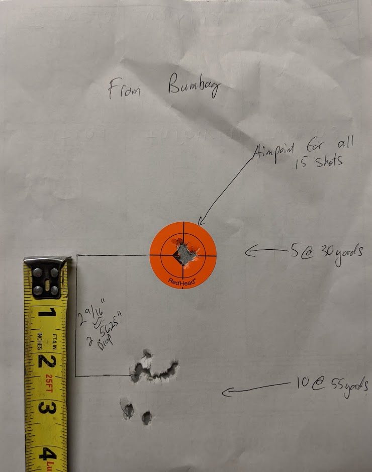

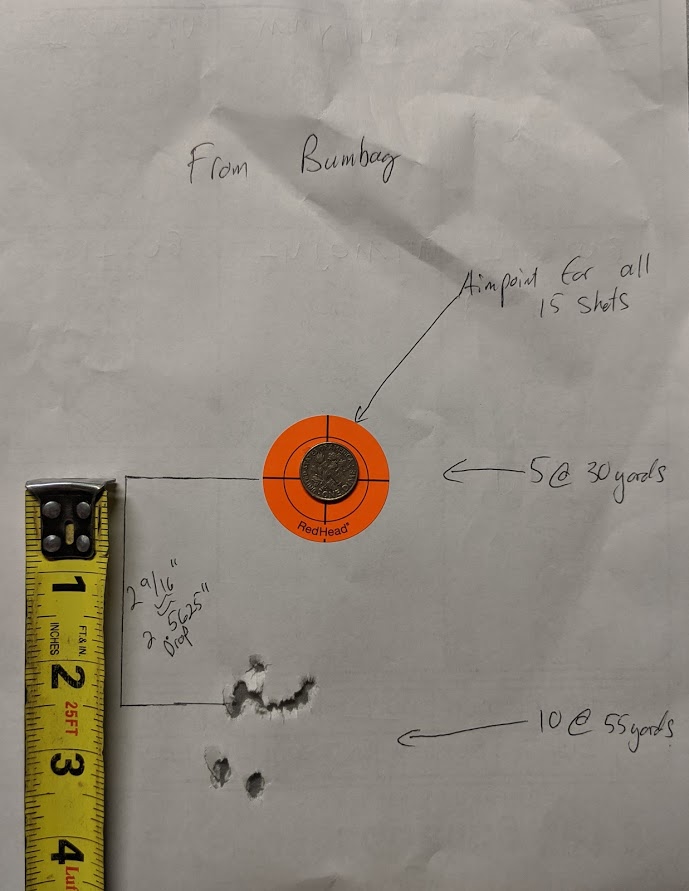

Steve123 was curious about the drop at distance in an earlier discussion about the abnormally high BC. So I shot this sequence this evening as well.
That's fifteen shots, all with the aimpoint in the middle of the orange dot. 5 shots were taken with the target at 30 yards and 10 more shots were taken after moving the target back to 55 yards. No hold-offs for wind here. You can see how the wind didn't string out the impact points horizontally at 30 like it did at 55. The two lonely/lower shots from the 10 shot group at 55 where bad trigger releases. That's my heartbeat. You can see it a little in my matchstick shooting video from a few days ago, but my typical FT position/heart rate combination results in a diagonal and upward from left to right "scope wobble" (Steve123s term). So those two lonely shots were taken at the bottom of that heartbeat caused crosshair pattern. Oops.
So, the drop from 30 yards to 55 is 2.5625 inches. I played with Strelok and Chairgun a bit.

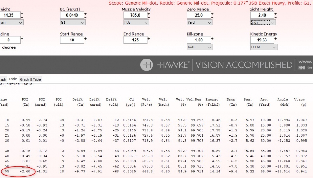

Chairgun needed a higher scope height than Strelok for the drop to match actual:

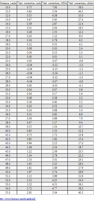

Basically the same info from Strelok in a different format:
The drop in inches doesn't match as well here, but the click values are mighty close to what I worked up a few days ago.

I've always gotta slip a dime in it seems.
Yeah, those 5 at 30 yards are EASILY covered by a dime. Incredible gun. Just incredible. I've yet to have a shooting session where I didn't end up just sitting there staring at it in amazement. A few days ago I started thinking about how I could rearrange my personal collection of airguns to be able to afford this one and make it my own. I can usually resist buying and over-spending, but this Red Wolf experience is really weakening my resolve.

I do still need to do some verification work at all the distances. Last night I was mostly getting a feel for the wind, so I only shot at 30 and 55.
You make a good point though about how neither Strelok, Shooter, or Chairgun match EXACTLY to what I was seeing with my initial trajectory mapping exercise. That is partly why I take the approach of actually mapping them out by shooting at paper at all the distances. The other reason is that it's simply good practice.
Case in point: Strelok table I attached last night says vertical correction of 2.91 inches at 55 yards and 5moa (40 clicks). The 5moa/40clicks is what I'm seeing with actual shooting, but the drop in inches is not.
I don't really give much weight to the ballistic calculators. 90% of the time they seem to be close, but not perfect. For me, the ballistic apps are a fun academic exercise, but I much prefer to trust my trajectory mapping by real-world results method, at least for FT.
