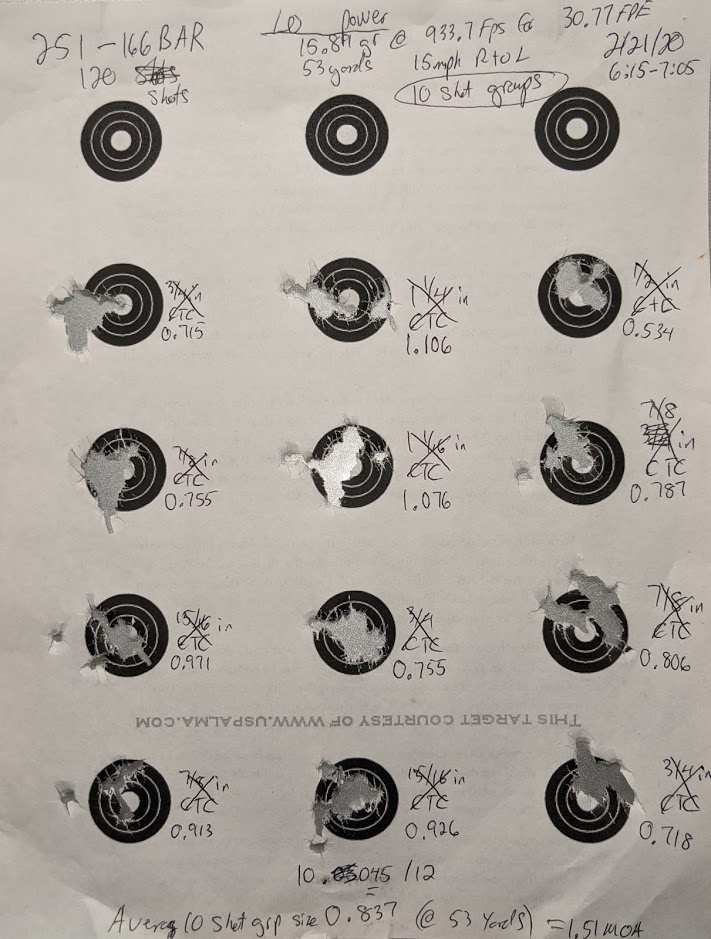

10 shot groups with 15.89:
This is 12 groups, 10 shots each. Lasered 53 yards, using 15.89 JSB. 120 consecutive shots. Pressure from 251 bar to 166 bar (I've been in the programming a bit now, and if I'm reading it correctly, 122.6 bar is the low pressure setting for Low. I think that means it could be shot down to that point-so it should be good for more than 120, 31ish fpe shots on low). I initially tried to measure with a ruler but decided to get out the calipers, so you'll see my ruler-sized group sizes crossed out and replaced with the caliper sizing. I also averaged all 12 groups (math at the bottom of the page).
Average 10 shot group size was 0.837 inches for 1.51MOA.
This was all in 15mph winds, per nearest weather station, right to left.

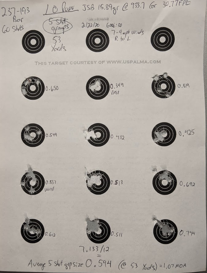

5 shot groups with 15.89:
Exact same scenario as above, but with 5 shot groups, and a little less wind.
Average 5 shot group size = 0.594inches for 1.07moa.
Imagine that, the 5 shot groups are smaller than the 10 shot ones.

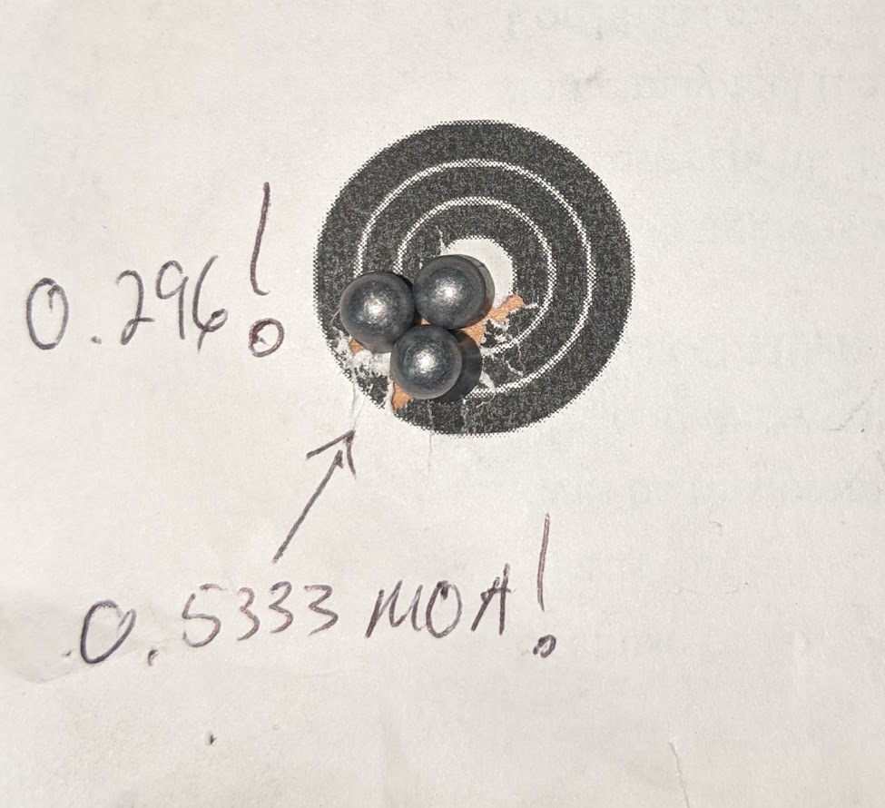

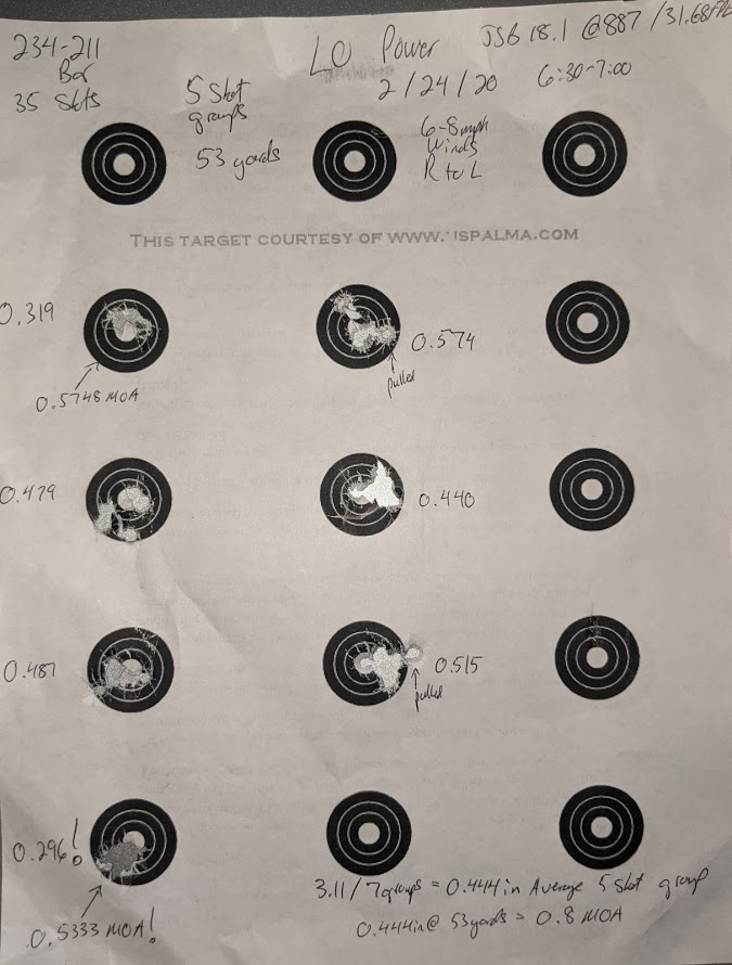

5 shot groups with 18.1
This is only 7 groups. I got on the phone with my ART buddy right after the 7th group for a little programming lesson and that ended the shooting for the evening.

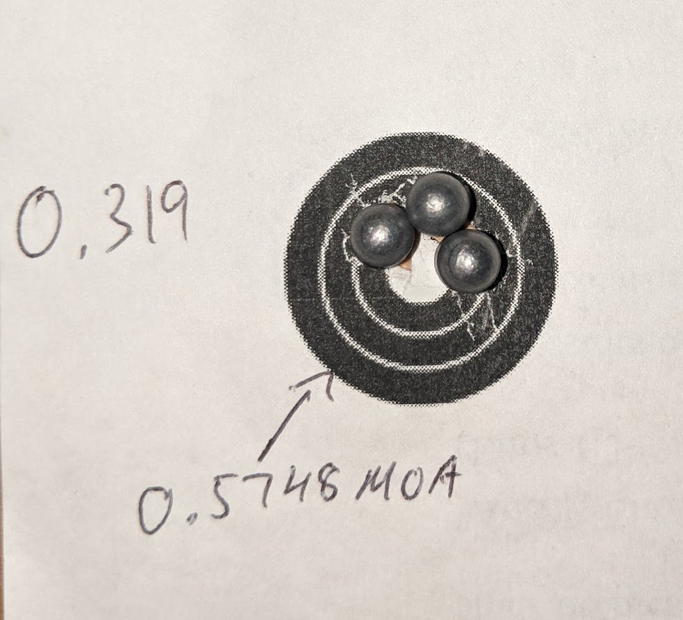

Close ups of the top left and bottom left with 3 JSB 18.1s sitting in the group. These are the best two groups the gun has shot yet, at least in my hands.

Wow, just freaking wow. Some of the best groups of my life right here.
This gun put 10, 15.89gr pellets into 1/2 inch, at 53 yards, in 15mph winds and averaged 10 shot groups under an inch with the 15.89s at that same distance.
Also with 15.89s, it put 5 into a 0.349 size group and averaged 0.594inch 5 shot groups.
With the 18.1s, it printed a 5 shot group under 0.3 inches! It AVERAGED 0.8moa in this scenario of 5 shot groups at 53 yards.
This is all further impressive to me because these are 120, 60, and 35 consecutive shots (on each of the three above target pages). It's one thing to get a really good group here and there, but to have it shooting that well, on a consistent basis. Just wow is all that I can say.
This gun is AVERAGING sub moa, 5 shot groups at 53 yards with the JSB 18.1.

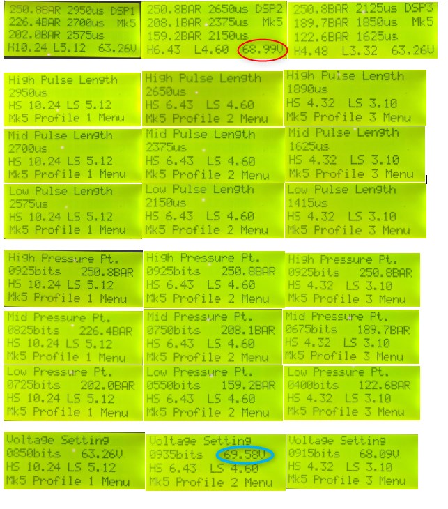

What helped me wrap my brain around it the most, was taking pictures of all the default settings with my phone, and then copy and pasting them together into one image. Like this:
Each column is a power level and the settings for that power level. DSP1=High=Profile 1. DSP2=Medium=Profile 2. DSP3=Low=Profile 3. I initially only recorded the top image in each column. My telephone instructor's first suggestion was to drop the voltage, circled in red. The first problem I had was that I dropped the voltage from the settings that were already in the programmer (circled in blue), which happened to come from a gun with at G1 cpu/board. Luckily he caught my error because this programmer I was using is his and he realized what I had done.
So, it's important to make sure that what you're looking at on the screen is the settings for the gun being tuned, and not something already in the programmer.
Once we figured that out and he gave me some other pointers, I was (mostly) on my own.

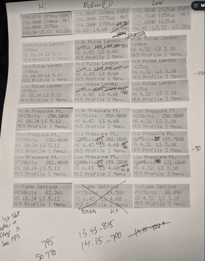

My next step was to see how much the voltage needed to come down from the G2 board factory setting of 63.26v. I ended up needing to bring it all the way down to 51.20v to get to my desired fps of about 810-815 with JSB 13.43, or right under 20fpe. I shot enough shots to bring the pressure down from 244 bar to about 190 and was seeing my fps taper off much too quickly. I realized I would have to jump all the way in the pool and change each of the parameters.
Pulse length is essentially dwell.
HS always has to be higher than LS. (Dunno why, but that's just how it is.)
Changes should be done in equal increments.
So, I changed all three pulse lengths (measured in microseconds), and the mid and low pressure points. I used the parameters I had, and the fpe they produced, to approximate what needed done to get about 30% lower than factory Low. I initially undershot by a vast amount and had shots in the 250fps range. I thought about it for a second and realized that the voltage was likely too low now, so I bumped the voltage back up to the 63.26 and was in the 650fps range. I then incrementally brought up the pulse pressures, and eventually fine-tuned the voltage back down a hair, to arrive at my goal fps of a little more than 800fps with my desired pellet.
Here is my scratch paper roughly showing what I did.
All of my changes can be summed up as studying the cause and effect relationship of the changes I was making. All of the above described programming took less than 2hrs. I spent the rest of the afternoon shooting and recording a 323 shot string. Yes, 323 shots from the Standard RW at 20ish fpe!

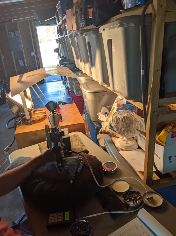

For this fun, the gun was left out of the stock and still hooked up to the programmer, like this:

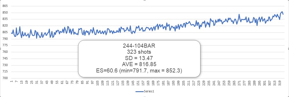

323 shots:
So, with how I have it programmed, I've got some creeping up of fps there in the last 1/4 of the string. The ES is too big. Though I do average under 20fpe, I've got some illegal shots in there.

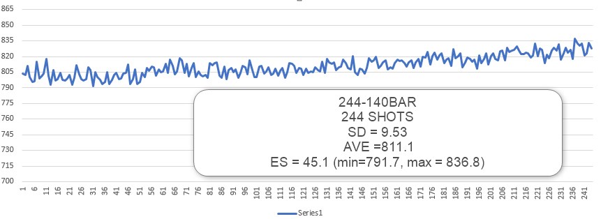

Here's how 244 shots looks:
Still have an ES that is too big, but all but one or two of my shots fit within that 2% variance in chronograph readings that are mentioned in the FT rule books, so, I'm legal here.

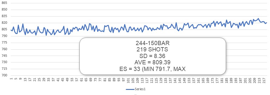

Here's how 219 shots look:
(MAX on this one was 824.7-forgot to add it to the image)
ES is starting to be acceptable for FT use. I consider this string fully legal for FT.

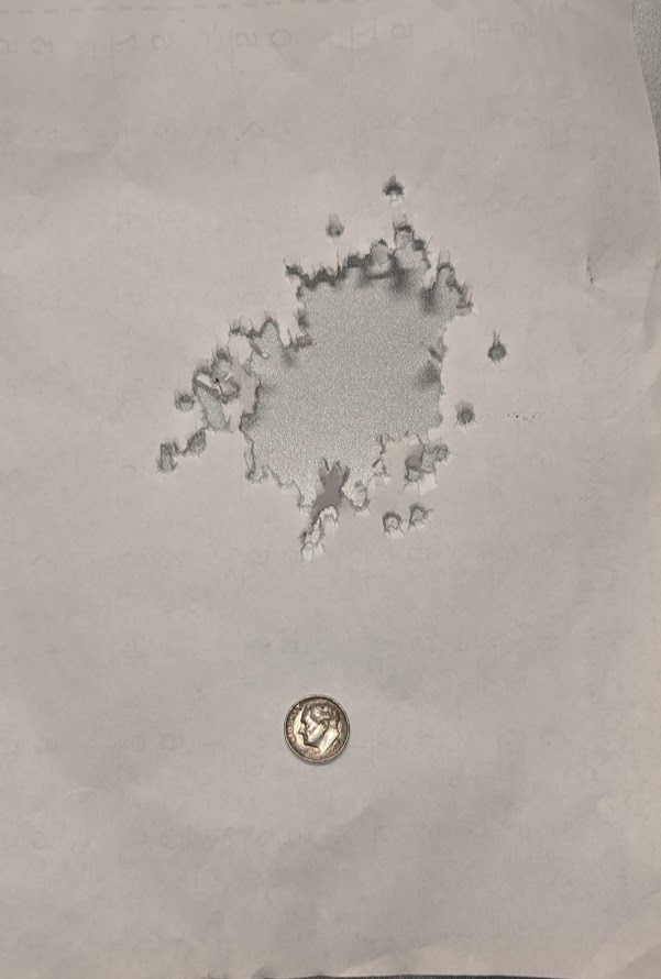

Just cuz, I shot all 323 shots from the string at a target at 53 yards. 25mph winds, no stock, many shots taken using my longest finger vs trigger finger, 6 year old scribe bumping the table.....

There had been some discussion in Centercut's report on his EBR prize about extreme spreads with the electronic guns. I'm off today so here I sit in front of the chrono.
The goal with this programming session was to eliminate the fps climbing when the bottle pressure got less than about 150-160bar.
I'll do a better report in front of a computer, and Excel the crap out of it, but for now and just focusing on the low end of bottle pressure.....after some adjustments..... 143 shots from 166-110 bar with a ES of 14fps. It appears that I was able to tune out the climbing fps problem as all of these shots have the same fps as the first 185 of the string. Not a bad ES either, for an unregulated gun. Just need to verify that my adjustments didn't have any effect on the fps from a full bottle (they shouldn't).
Just glancing at all my notes, I should have about a 15-20fps spread over about 330 shots, with a 250-110 bar fill.
