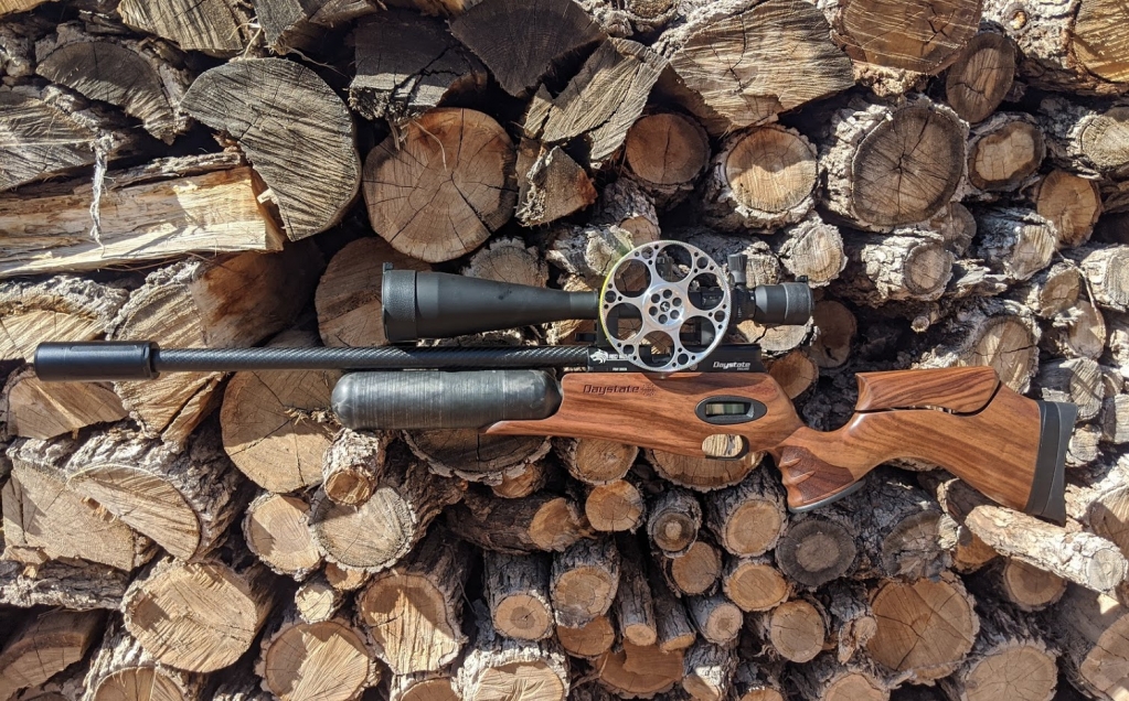

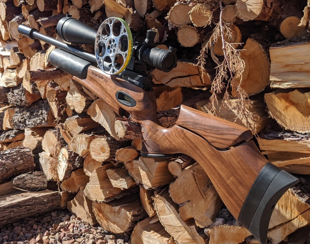

Initially took this one in front of the Alligator juniper firewood stack. When I looked at the resulting pic, I realized that the handsome walnut stock was about the same color as the sun-bleached juniper.
So, I took this one in front of the oak stack. Much better! Quite the classy aesthetic on these walnut RWs. I'd peg the laminate as flashy, but I've gotta go with classy when describing the walnut version.

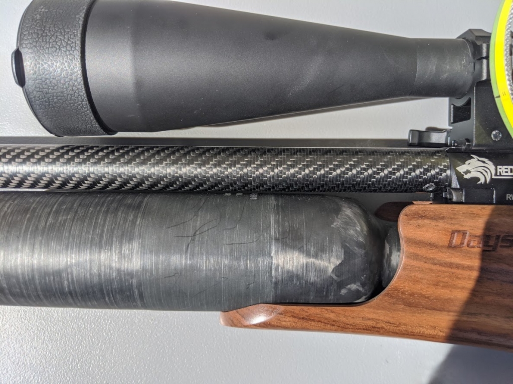

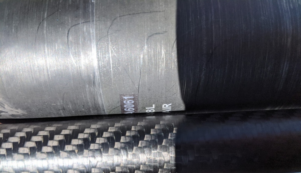

Real carbon fiber shroud.
0.48liter tank (480cc) hard to see it because of bottle orientation, but it's right under the shroud

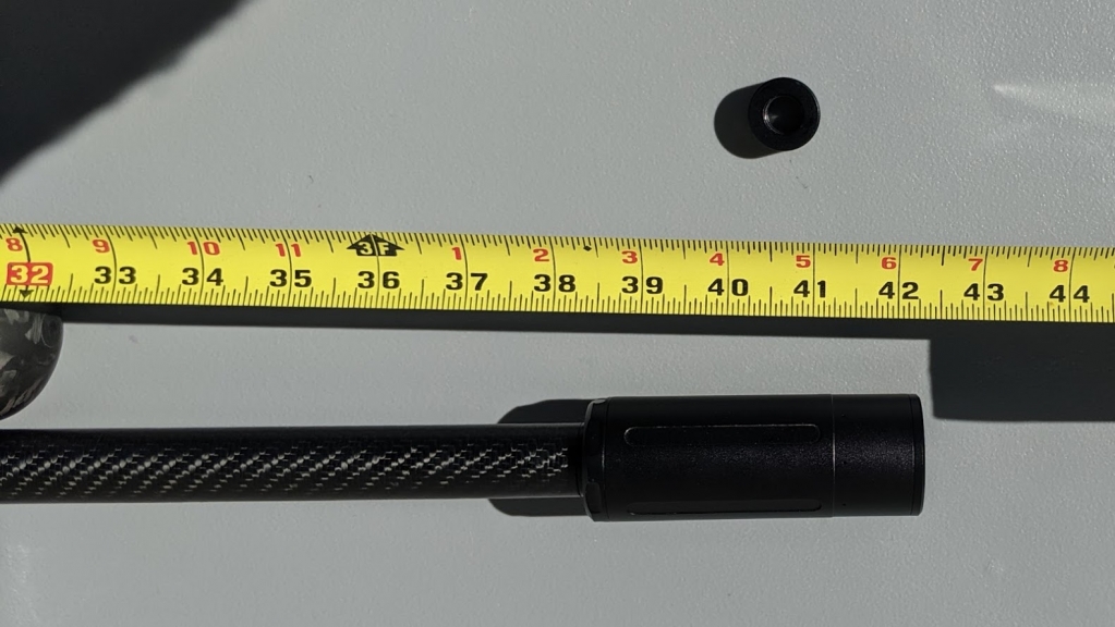

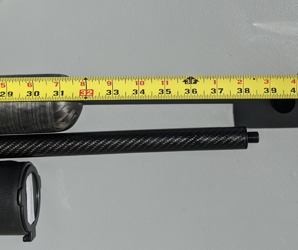

17 inch barrel, shroud is about 3 inches longer than the barrel. There appear to be some baffles in there. This is a functional shroud, as it's quite a bit quieter than expected for the power level, even without a moderator added.
Overall length = 38.5 inches.
42.25 inches with Donny Tatsu
45.25 with Hogan Decimeater

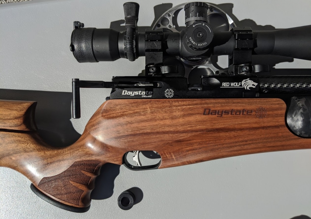

Battery compartment
Magnetic dust cover and fill port

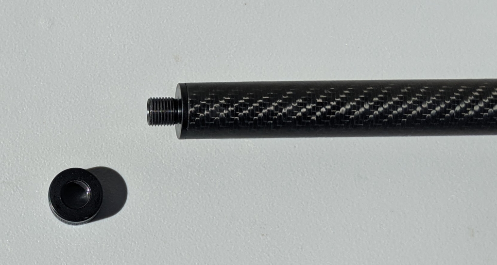

Thread protector
Biathlon type cocking lever

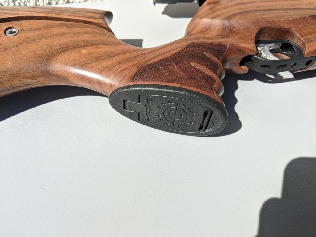

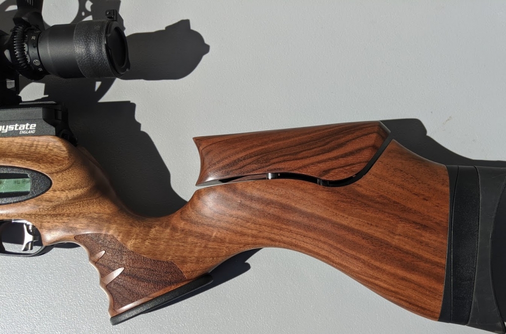

More stock pics (nice stippling panels on the grip)

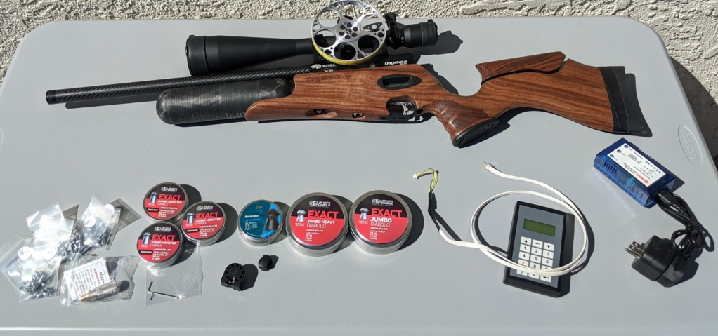

AOA care package (yes, some pellets and a NSA slug sampler were provided for this review-scope/rings/additional pellets/all other gear is on my dime-full disclosure and all)

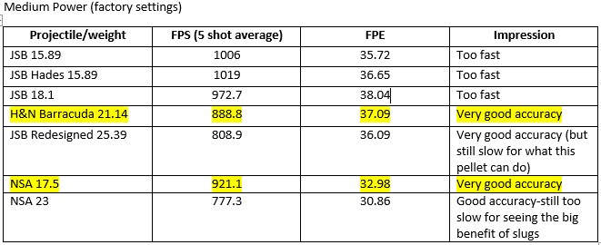

Chronograph #s
These are with the factory programming and should represent about what can be expected from the Standard RWs with G2 board, with the understanding that every gun is slightly different so there could be minor differences from one specimen to the next. I haven't changed any of the programming yet.
I'll post up all three power levels first (for easier comparison) and then explain my tables and share my thoughts on them.
Yellow highlighted items are what I picked as the most promising projectile for that power level, based on what I was seeing with accuracy and among the tested pellets/slugs. I only tested reasonable weight pellets for the power level (ie, no 13.43gr JSBs on HIGH).
Analysis
Probably the biggest takeaway here is that the Standard, on HIGH, is doing almost 45fpe with the 25gr JSBs. My ART friend is telling me they were getting 47fpe, I'm guessing that was with a Labradar since I know they use that a lot in their testing. So, the 47fpe from the Labradar is likely more accurate fps measurements than my old fashioned red Chrony. The previous generation of RW Standards were listed as 35fpe max output in .22. That extra 10-12fpe is a big step up when shooting long-range, or trying to buck the wind. It also gets the Standard RW into slug territory, light slugs, but slugs nonetheless. In other words, we're seeing a 28-30% increase in max power output from the Standard RW, simply because of the capabilities of the new board that was developed for the HP version. That's big.
So, Low = about 30 fpe, Medium = about 38fpe, and High =about 45fpe. Energy output on Medium with the new board is higher than what High produced with the old board.
That is pretty decent fpe for a gun that isn't advertised, nor really intended to be a high power monster, and at only 38.5 inches without a moderator....that's a pretty sweet little package for a non-bullpup rifle.
The flip side of the coin with the increased power is that the lighter .22 pellets are not an option, at least with the factory settings. Pellet weight for Low power starts at about 15.89 grains (and even that seems a little faster than the tight-waisted pellet designs typically seem to prefer). Medium and High need some pretty heavyweight stuff, at least heavy for projectiles in the typical non-HP realm. Even the 18.1s on Medium are going a little too fast.
On Low, NSA 23gr lose about 25% of fpe (when compared to JSB 18.1) likely from increased bearing surface of slugs vs pellets.
On high, NSA 23gr only losing about 15% of fpe(compared to JSB 25.39). Power and fpe lost to friction with the slugs seem to be an inversely proportional relationship (as power goes up, the % of fpe lost goes down). Basically, slugs like to go fast.

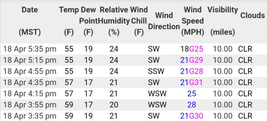

Weather conditions for the above messy groups...
You can see that the wind was keeping any serious accuracy testing from being possible. 25-30mph gusts make pellet shooting tough.
