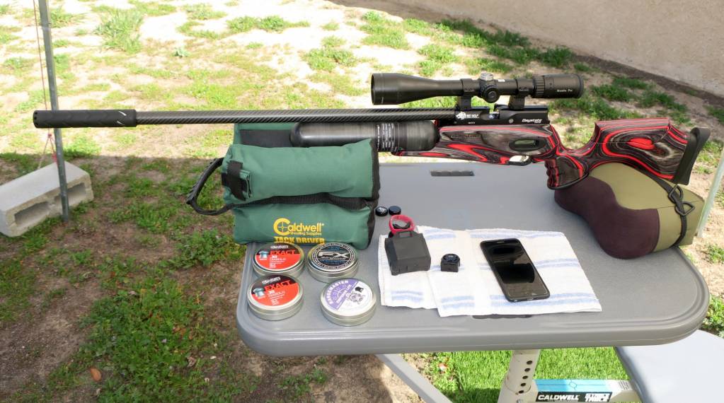

If it helps, my .303 "Safari in laminate clothing" with untouched factory programming (GC2 electronics) puts out 79 or 81 FPE at the muzzle with 44.75's/50.15's on the Hi setting, and 70 FPE at the muzzle with 44.75's on the Mid setting (sorry, don't have Mid/50.15 numbers). Haven't tested it on Low yet. 😏 The Daystate spec for the .25 Safari is up to 65 FPE.
