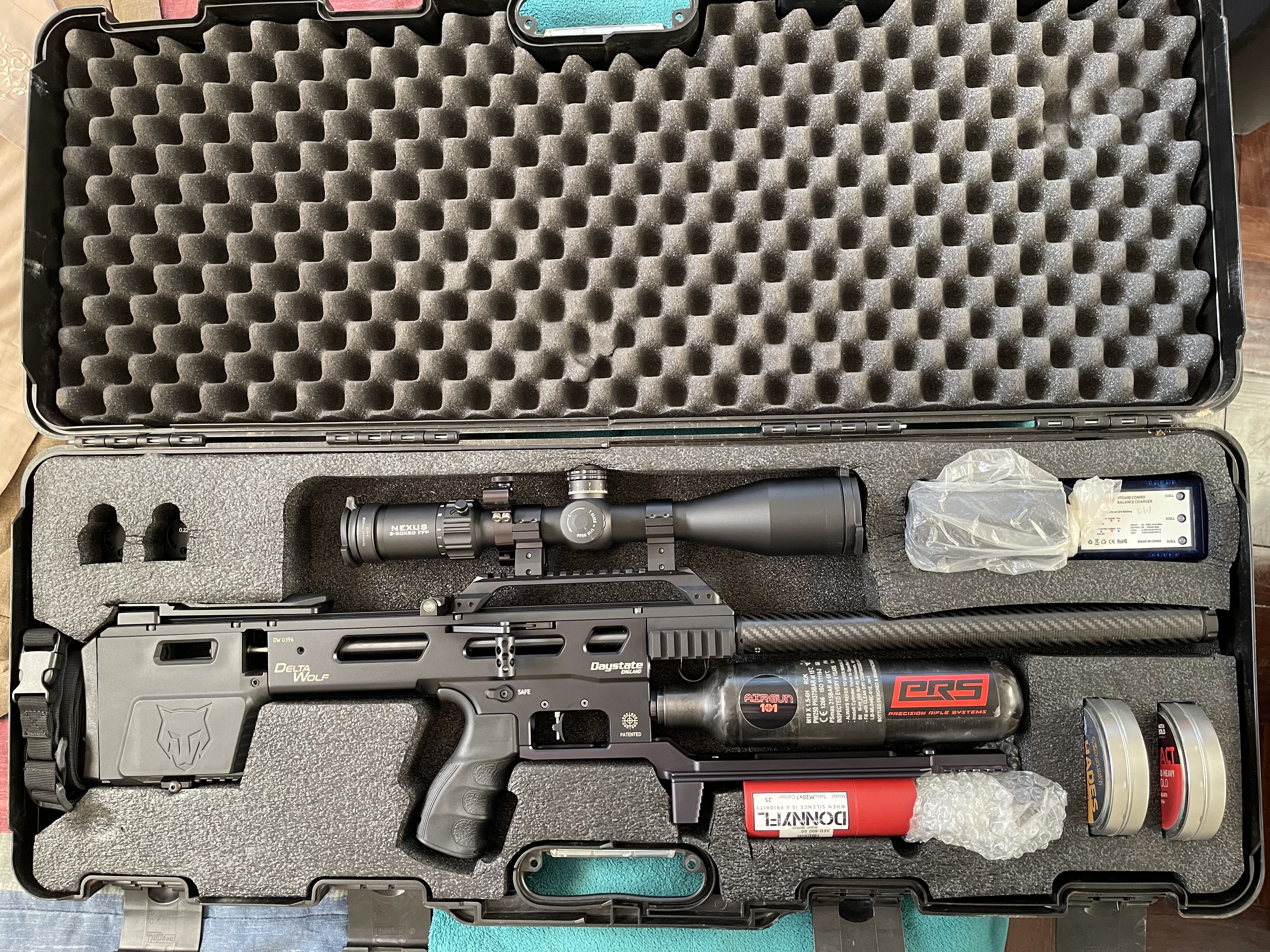

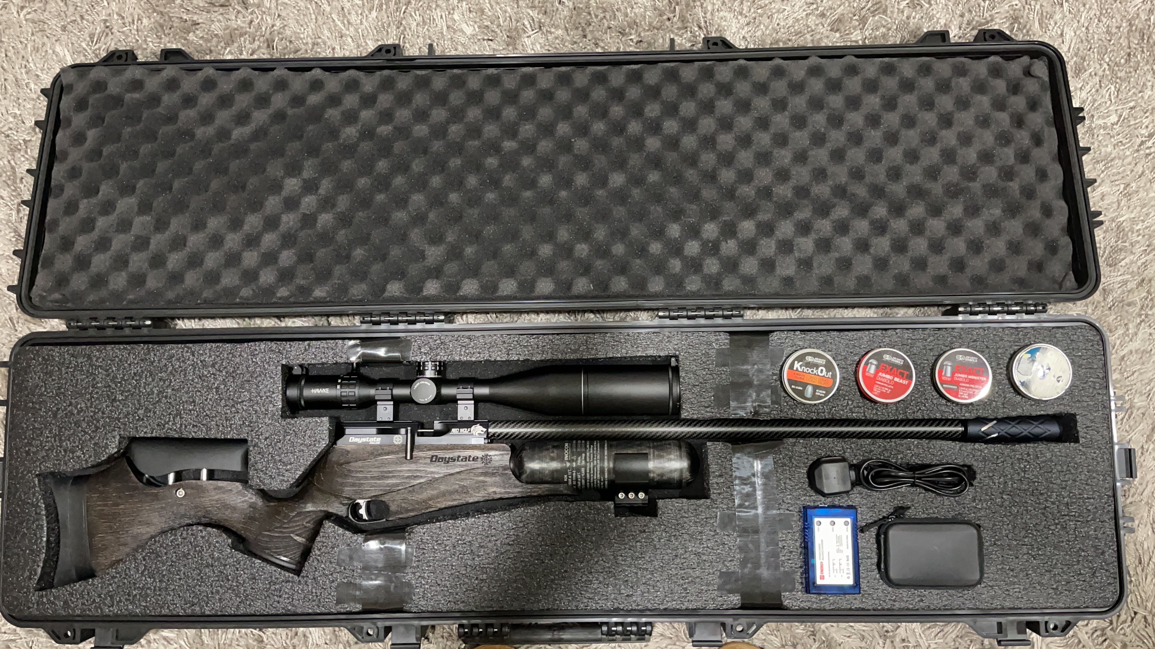

I was going through my old targets and found one that I used as a guideline for both rifles use and pellet/slug of choice. Pics of the target and the Red Wolf and Delta Wolf are attached.All shots are from 50 yards.
