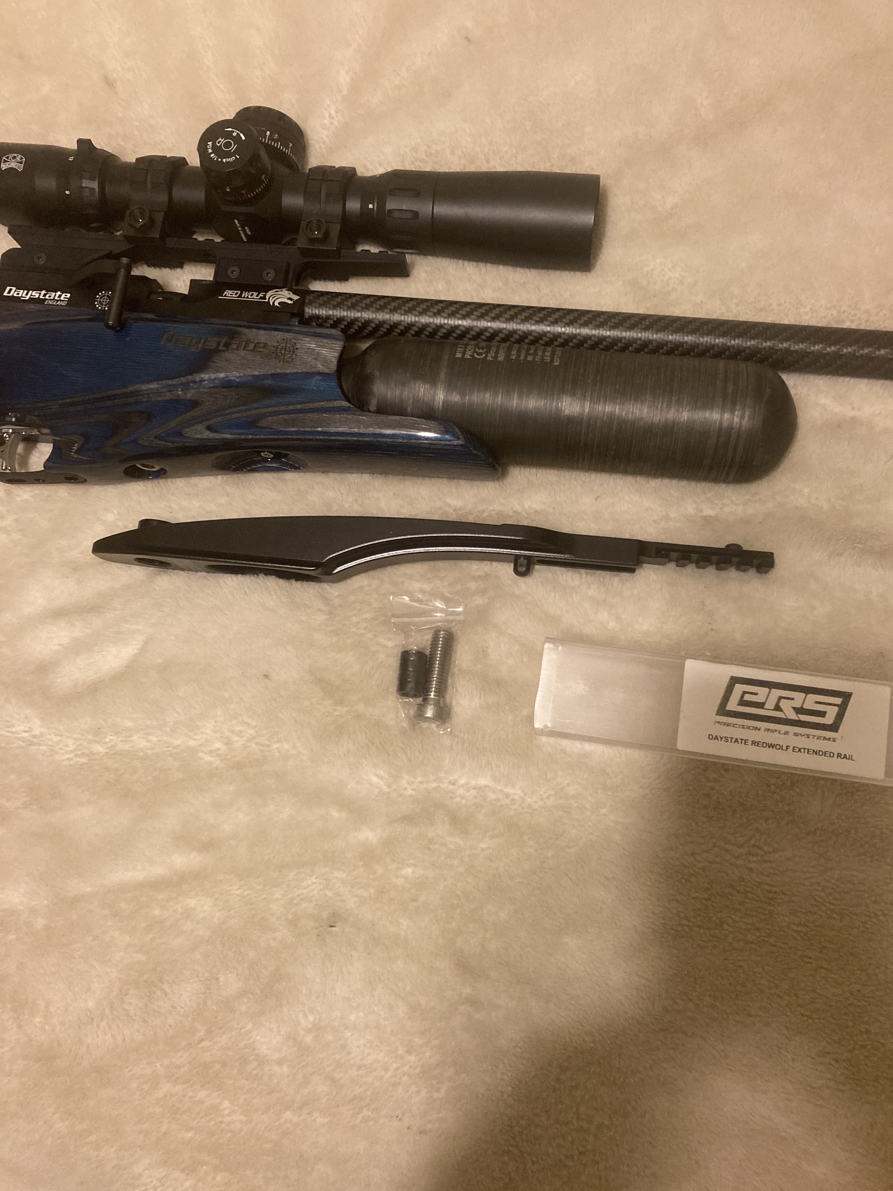

I also spoke to them about installing a picatinny rail (like an Atlas) and although they do it, they say they just install it using two pan head screws, no backing plates. They also indicated that it sits flush with the stock, but I don't think it will. Maybe it's "close enough."
Seems like I'd want something more like this rather than just wood screws..

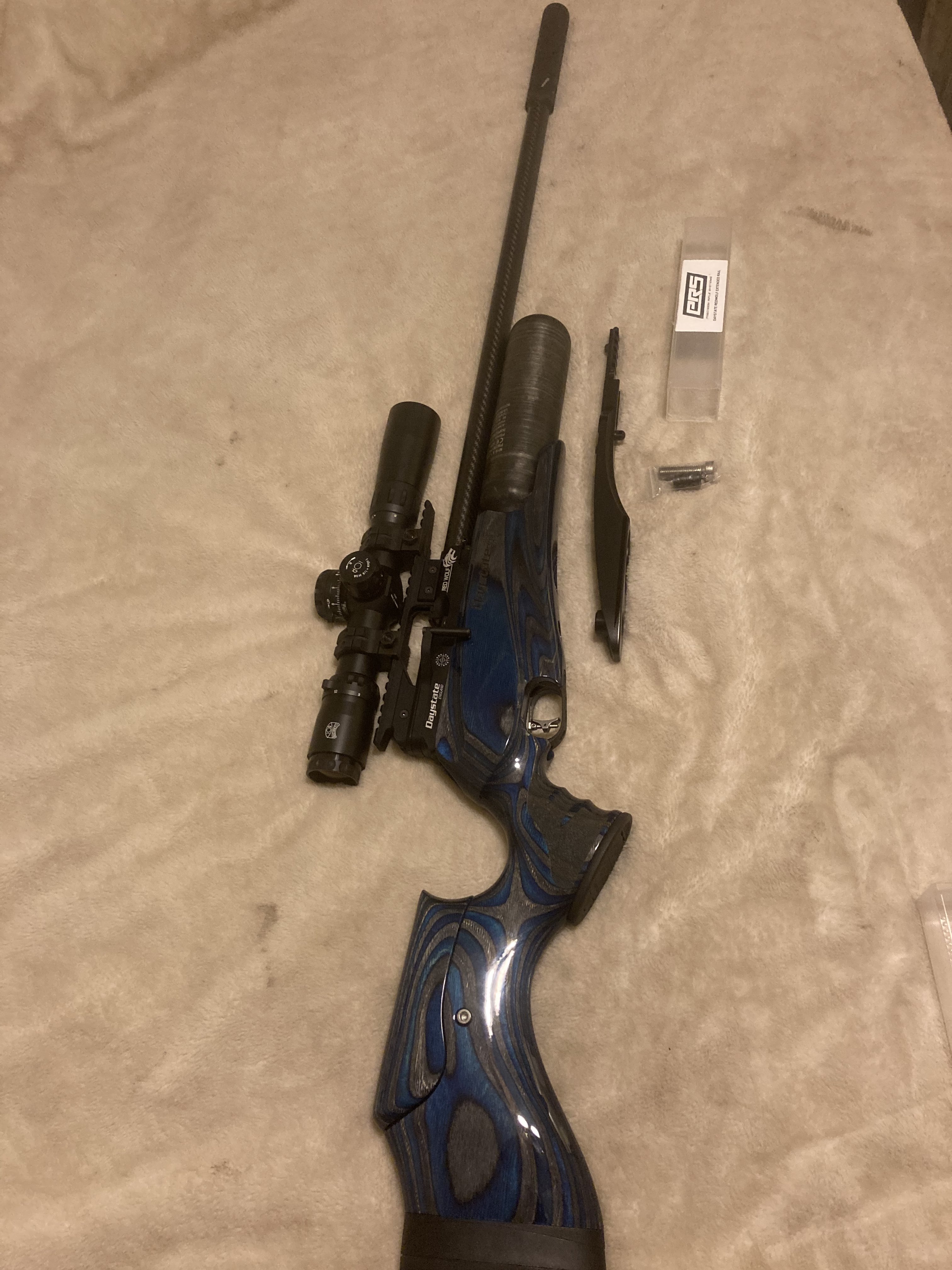

As far as a rail mounted on the rifle I ended up getting this beauty, it ain’t cheap at $290 but it mounts with just the main bolt and it’s really really solid.
It extends the bipod way forward for great stability.
