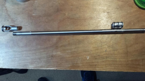

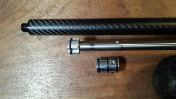

Crusher
The original barrel used a threaded air stripper at the muzzle, as you can see in the photo. At some point, Daystate realized that threading the muzzle upset the internal dimensions of the bore, and accuracy suffered. I'm sure many rifles with the stripper shoot fine, mine did not. The replacement barrel is not threaded and does not use a stripper. The short bushing fits at the muzzle to center and support the shroud. The longer bushing in the photos is the breech end bushing that fits just forward of the action. AOA sent me another one, as it can be attached near the muzzle also, but the shorter bushing gives better results in my rifle.
