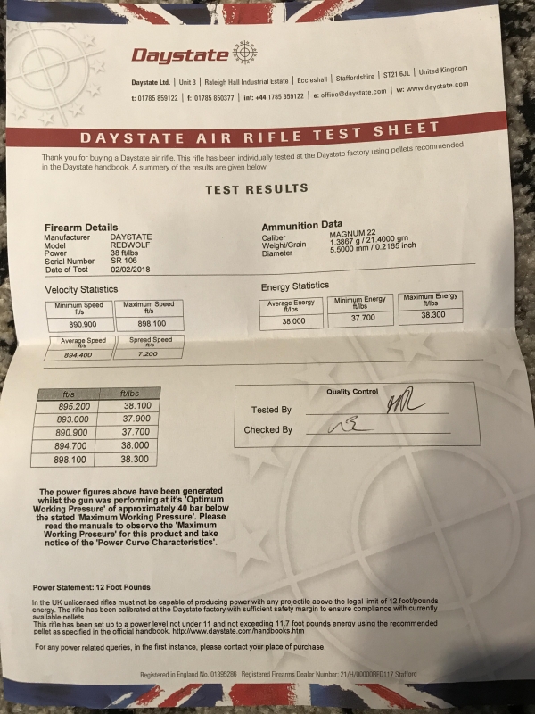

Straight from the birth certificate with my Hi-lite 38 FPE on high.

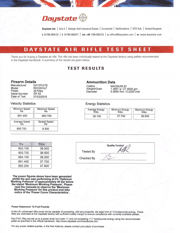

The formula is always 100%, 85% & 65% respectively from the factory, I could check mine if you want to know exactly, problem is they all vary slightly.

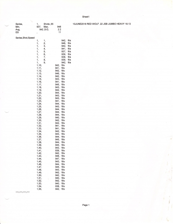

IMO the much better power setting is on the RW HP, simply because the high setting works for the JSB 25g monster, whereas the low setting gives right what the std version does on low power with the 18.13g EXCEPT! you get 200 shots on low, but only 75-80 on high from the STD power gun.
I never use med. low settings on my 35FPE std, no point in them really unless you want to reserve them for tuned settings!
