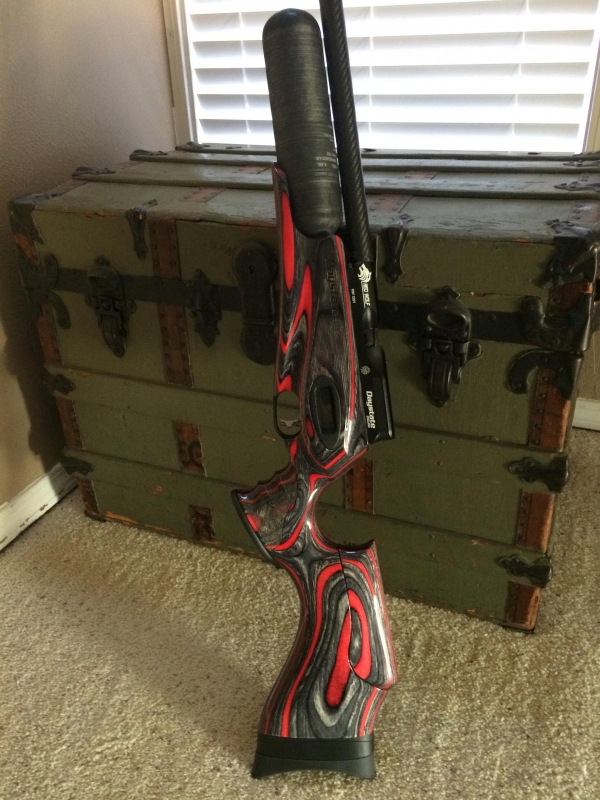

Can someone post some pics of their red wolfs and bottle/shroud clearance please. When my gun is resting on stock, you can't get a piece of paper between shroud and bottle. I am afraid this is going to cause accuracy issues. If you tap bottom of stock you can hear shroud vibrating off bottle for a second or two.

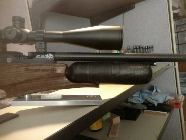

Bottle and shroud should not touch. I measured a clearance of .046" (1.8 mm). Pictures to follow.

Picture I promised.

2 possible cause:
1: bottle out of round, rotate bottle CCW and look if bottle clear the shroud within one turn and touch again. Or remove bottle and roll on even surfaces You will see right away.
2: barrel droop, turn gun upside down in horizontal position if bottle no longer touch the barrel, loosen barrel mounting screw and retighten starting from the rear screw 1st. If still touching bottle loosen barrel screw and rotate barrel till TP At 12 oclock tighten barrel screw if no change you my have an action barrel bore off center, if you have a friend that has a RW try fitting his barrel and bottle on your RW if bottle still touching talk to your dealer. Free floating barrels are not ment to touch the bottle if so you will have accuracy issues and a eye sore.
