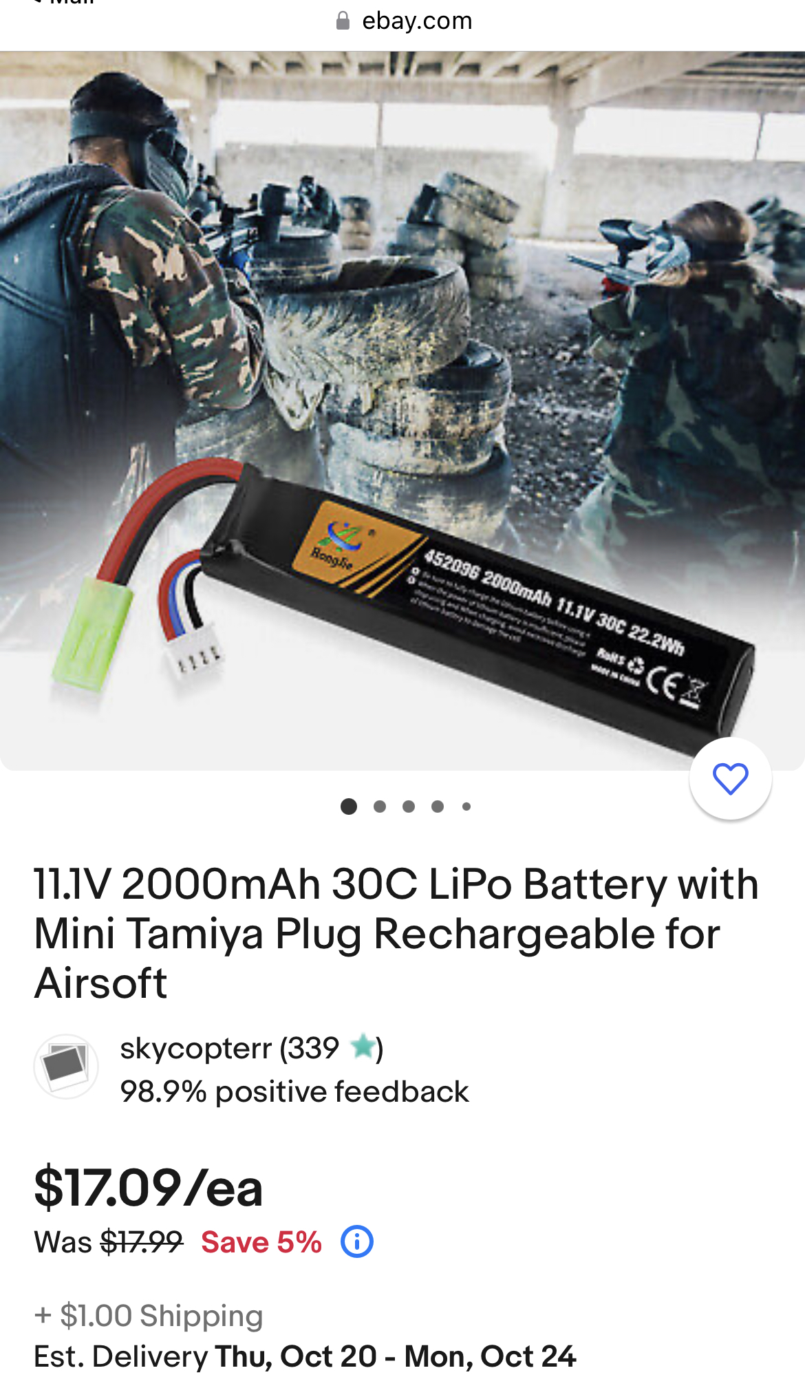

The battery link that rc4fun posted adobe is a larger capacity battery that will fit your Red Wolf with no modifications. I ordered one and use it in my Red Wolf Safari.
It uses the same charger you use now.

Thank you. I thought had to mod it to work. Just ordered one

Many of the lithium cells and packs marketed to the consumer have capacity claims that range from optimistic to absurd. However modest differences (10 - 20%, maybe 30%) can be legitimate. For example, a pack made for high-rate discharge will use a different type of cells broadly referred to as power cells. This type of pack would be suitable for things like an RC car or drone that will completely drain the battery in as little as 5-10 minutes.
Contrast with a lower rate pack made with energy cells having a higher mAh rating that is better suited for long run time with light or intermittent loads like a Daystate Red Wolf.
Butch
Bought this battery. It will go in the gun. You do have to force it in. Not good as getting it out is difficult. Measured it. 101mm x 20mm x 16mm. 1 mm more as it should be 15mm. Have to use the wire not needed to pull it back out of the gun. Suggest looking at the 1400mah battery instead. I put silicon grease on the edges of the battery. Comes out and goes in easier. Still need to pull that wire though. At some point that will fail
