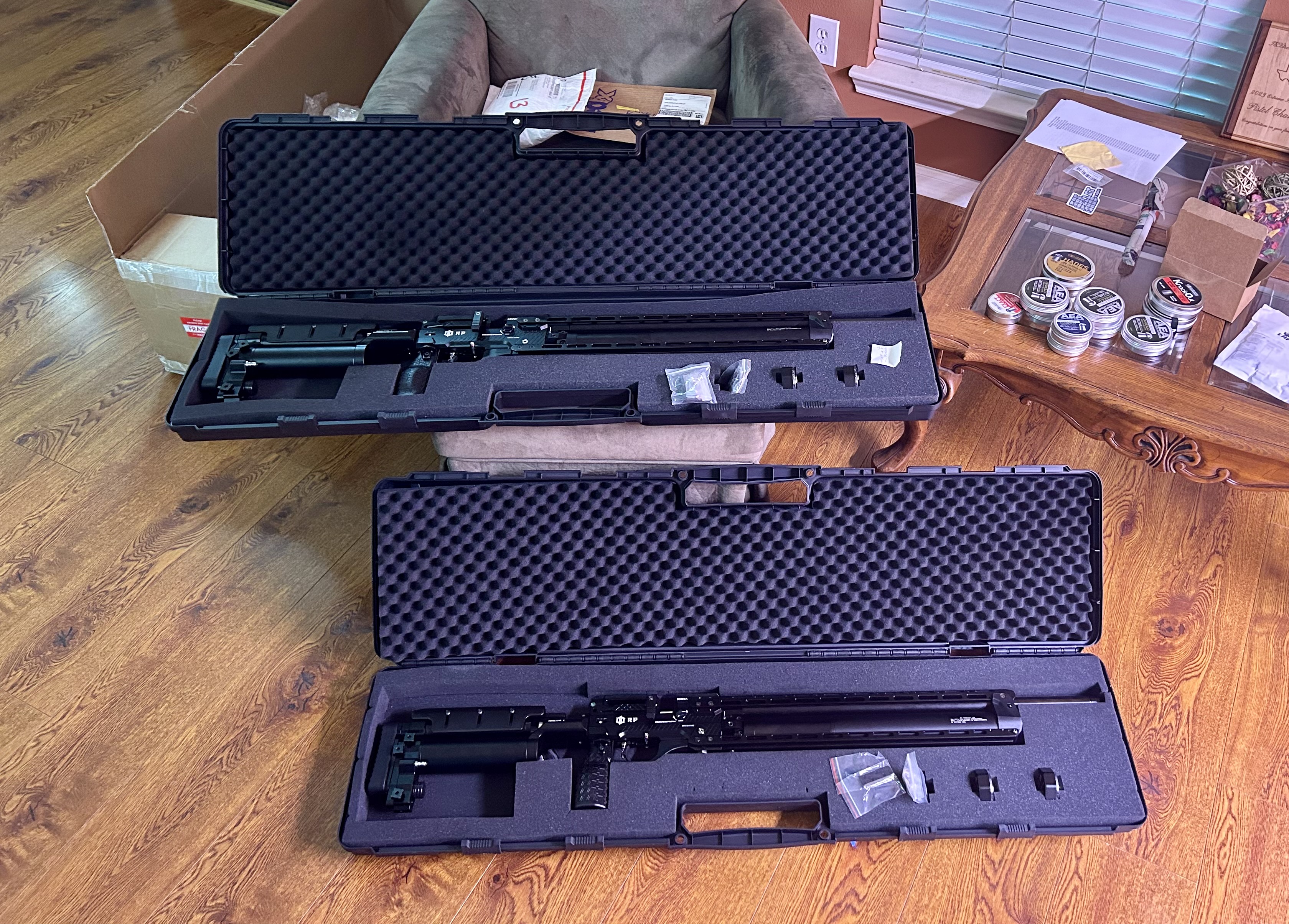

I agree..and I thought his post was legit, just seeing 2 rp in the picture made me assume he was.
I agree..and I thought his post was legit, just seeing 2 rp in the picture made me assume he was.View attachment 467088
Hello there. I’m actually also a dealer and own Tenacious Airguns. I acquired 2 RPs and I am keeping 1 for myself. The other was sold to a teammate. I would have gotten 10 if I could have but I can’t swing that cost.

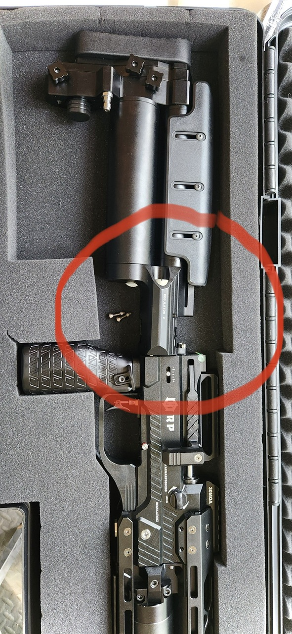

Also, I’m curious why recent purchasers of the Pandy aren’t saying anything about the frailty of this gun? Do you feel you’ll be ostracized by the community if you tell of receiving the gun broken? I know of three Pandys that have been received in the past few weeks with this issue:
Broken Pandy
It appears that these fasteners without sufficient thread engagement (3 1/2 threads) plus the flimsy case, result in significant damage with any sort of rough handling while shipping.
The good thing is this can be fixed at the Karma manufacturer or dealer level with a recall. Replace the too short screws with ones that give proper thread engagement and upgrade the case to something like FX or Daystate uses for their top of the line guns. IMHO
Broken Pandy
3 already? For such a heavy over built gun that's not good for durability......

Three that I know of. I don’t know the actual number.
Apparently two things.
- the case is not only weak, the foam inside isn’t the firm type that will keep the 17 pound gun from moving inside.
- the screws in the photo only have a few threads engagement. Standard engineering practice is fastener diameter x 1.5 for engagement length. I’ve been told it’s considerably less than that.
And like I said above, it’s an easy recall. Longer fasteners (or longer and larger diameter) and a stronger case with more dense foam. Easy day.
