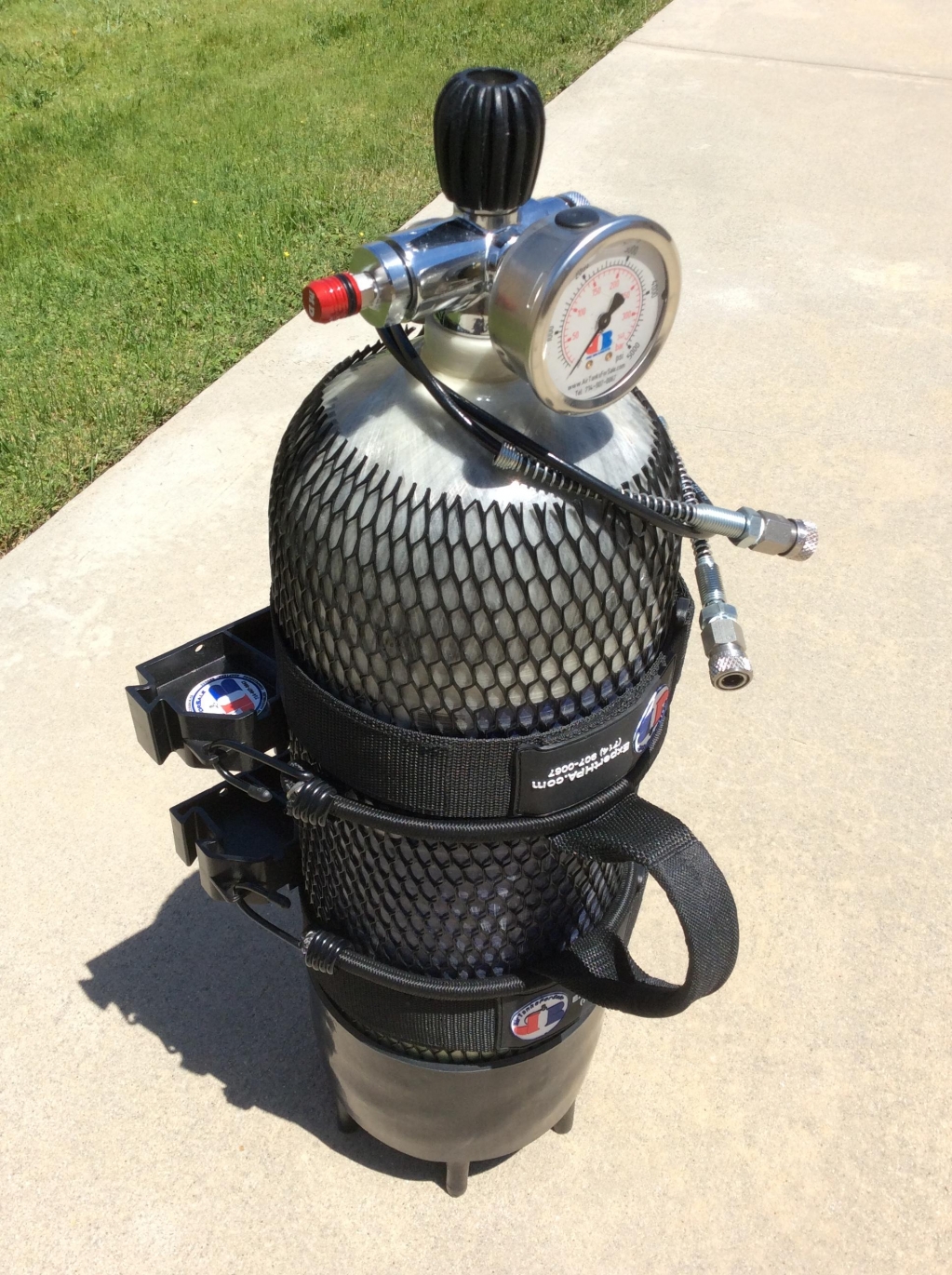

I second Joe broncattos tanks. Even if you don't buy his tanks do yourself a favor and buy his microbore hoses. They slowly fill your gun for precise and safe fill up. They save air too. Another way you can go if your like me and live dangerously. Buy an expired Scott air pack and build yourself a whip manifold. I spent 150 bucks total on mine. Dive shops won't fill it but for a couple hundred less than a great white you can buy a Yong heng and a tank. That's what I did and it worked great. However buy it from Amazon and get insurance on the Yong heng. It will break before 3 years and you can get most your money back.
I third Joe Brancatto’s tanks. His slow fill and second gauge make a much safer and easier fill station.
