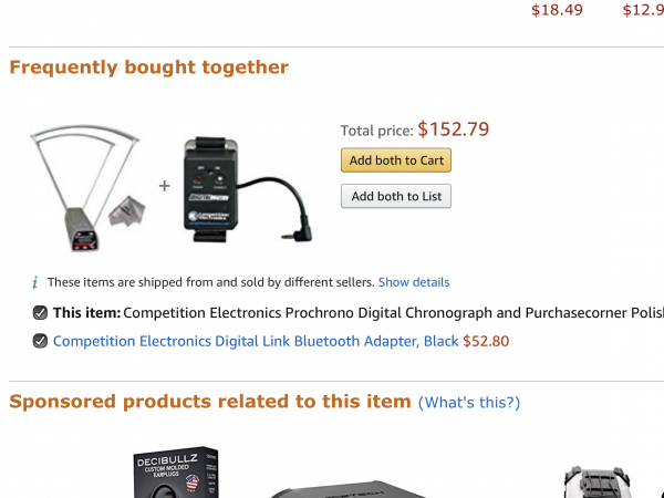

Competition Electronics recently released the ProChrono DLX which has the Bluetooth adapter built-in. I will be using my indoors, so I also got the lighting kit, and it worked for what I wanted. I prefer metric and for that you have to every time both (1) power up the chrono with the review button held, and (2) switch the shot string in the app to metic. I hope they fix in the future device. The Android app works well but needs a bit of polish, and I believe they were receptive to my suggestions. They were working on the next version app when I chatted with them last week.
