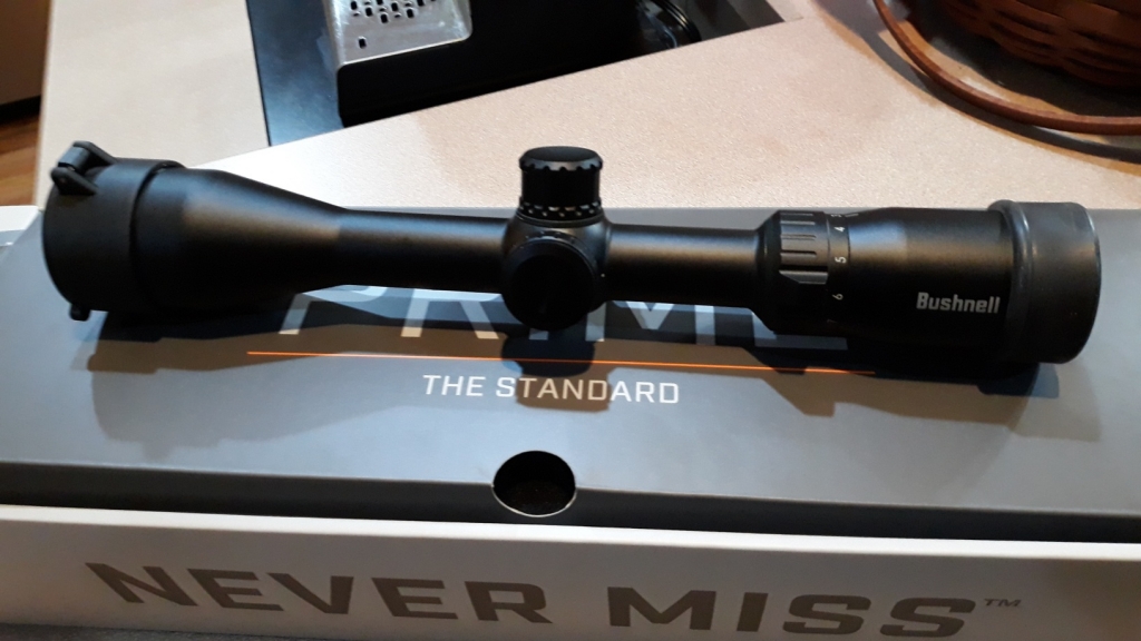

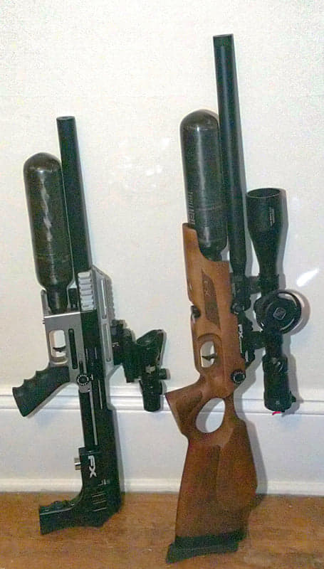

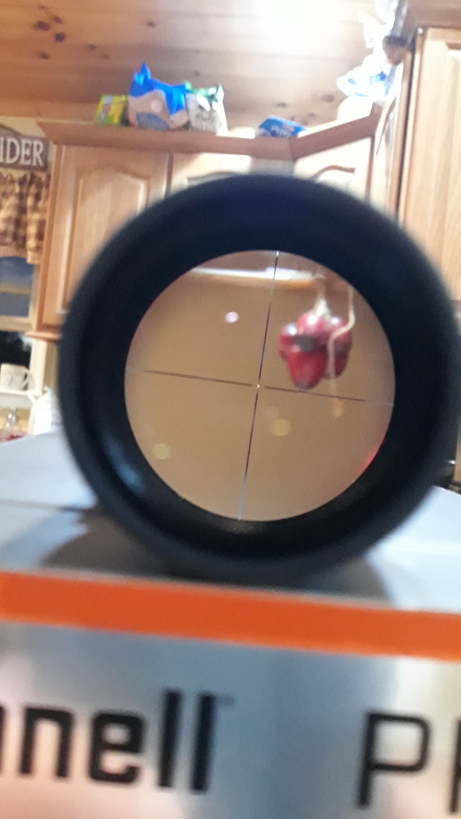

Agree with Michigander that 3-12 Prime would be a good one. I just bought a Prime 3-9 with the illuminated dot. I wanted something light for my soon to arrive FX Compact Lite Tact, or whatever they call it. Well since these 3-9 are parallax free at 100 yards ( no SF or AO) , I just moved my Objective lens forward until I have no parallax at 30+ yard and not enough to make much difference at 20-50. Will adjust more if needed, but think it is about perfect now. The 3-9 Prime has exc glass and the dot is great & only 16 oz. I use cheaters made by Bulzeye, due to diminishing eyesight. So with that, It boost the power from 3-9 to about 5-12, that is just a guess. Make the crosshairs very visible to aging eyes. I would of bought that 3-12, but could not find it with the illuminated dot., which is a must for me now.
