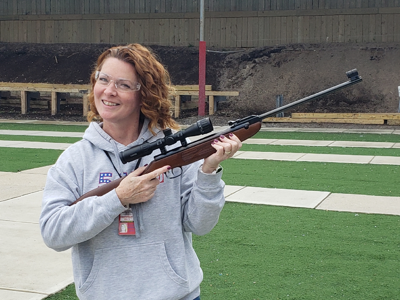

Hw30 is a better pick. It's 2 plus pounds lighter and much easier to use. Here's my wife with her's.
Both guns have the same long reach to the trigger that may be a stretch for her. My wife is 5'9" and manages ok. If your wife has short fingers she may need a set back trigger on either gun.
The length of pull on the Hw30s is 14" not particularly short either. I never measured it but the length of pull on the Hw35 is probably like other Weihrauchs which is around a half inch longer than the Hw30s.
Really nice rifle. I sold m HW30 in the near past to buy a Beeman R7. Same action, but IMO a better stock. And did I say accurate?
post # 2 , that is a great looking range good berm with a solid looking fence on top ( and of course a lovely wife )
as for rifles i like the HW 30 or 50
That's a private club range in Freeport NY. It's on the Freeport PBA property. They share the range use. It's not cheap but it's well run and the 50' indoor range is open 24/7/365 for members. Belonging there is necessary because I can't shoot a pellet gun in my NY backyard without helicopters and swat teams. I didn't renew this year because I'm relocating to Arkansas this summer. There I'll have enough room geographically and politically to shoot anything I want at anytime.
And thank you my wife is lovely and shoots better than me (and most men) at the range.
