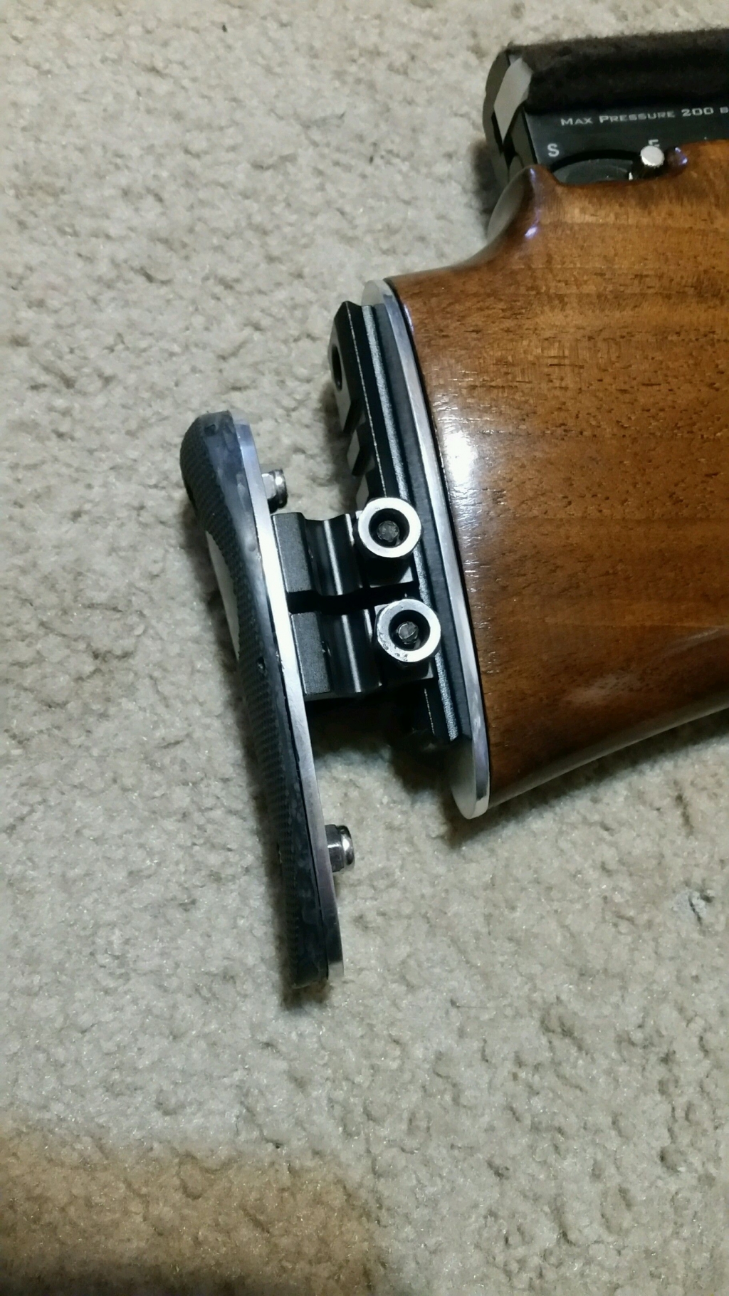

Here it is on my Kral :(with added adjustable plate)
