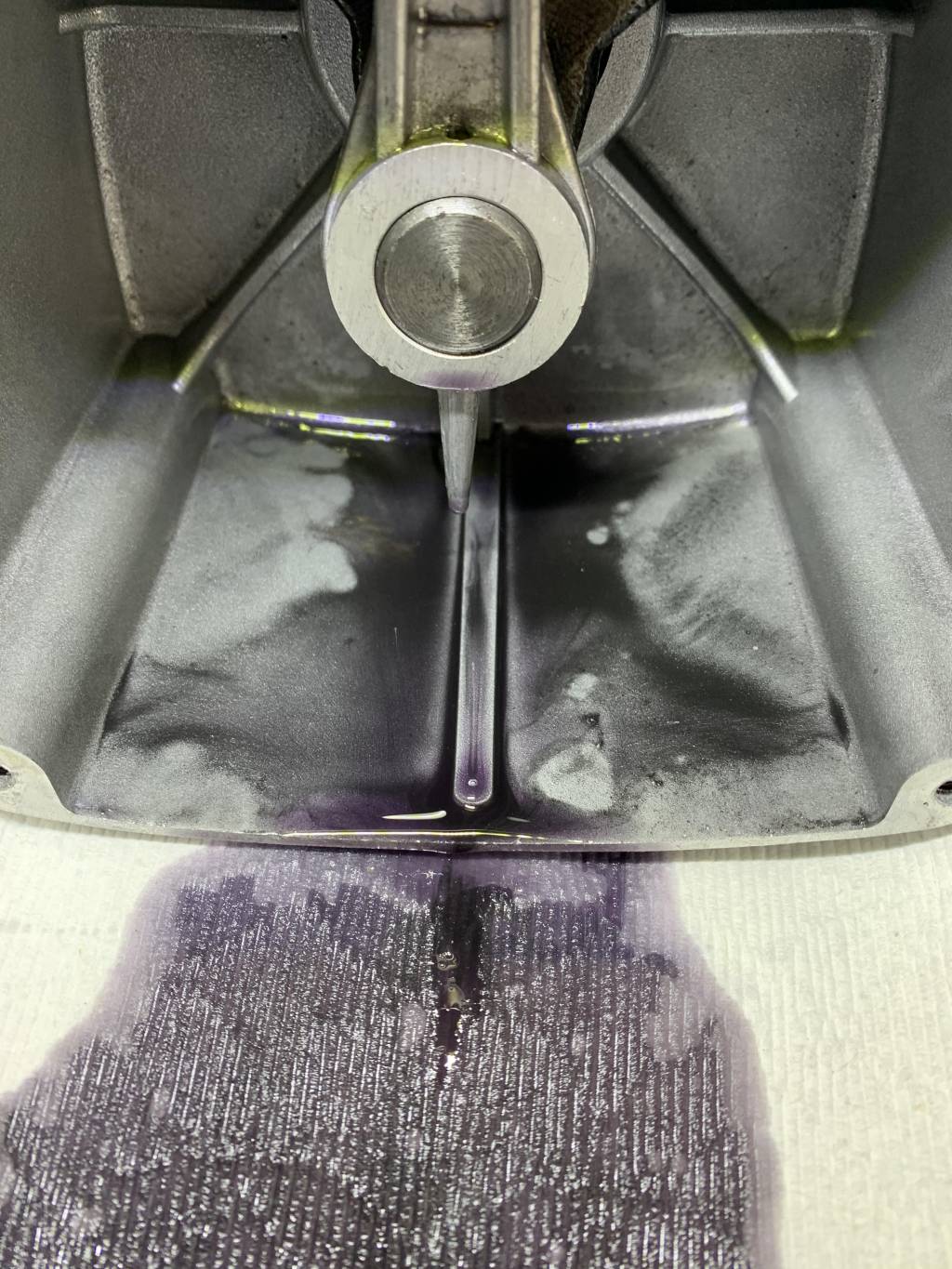

This was my 2nd oil change, at about 1 hour run time on the purple stuff. I wiped it down well and changed to 751 dive compressor oil. It will be interesting to me to see the oil condition on the next change. I assume the blackish debris is ring material, or carbon from detonation, had a odd smell, almost like cordite.
