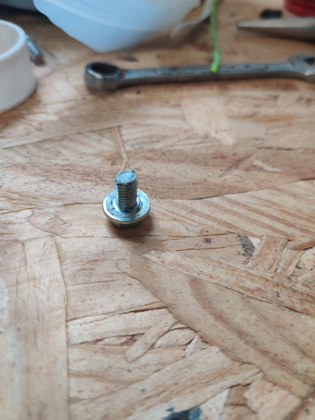

I removed gauge on flashpup and added teflon tape to threads and reinstalled. Unscrewed the bleed screw on gun and noticed a metal shaving was pushed against the o-ring. Removed that and tighten screw. Replace the inline filter on air line and connected airline to gun again. Fired up the compressor and it filled the gun in 45 seconds from 0 pressure to 200 bar. Compressor did its job fast and i was pleased. But ran out of time and didnt get to the hatsan airmax. Hopefully tomorrow.

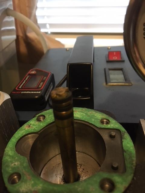

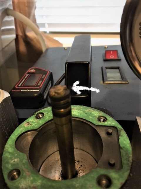

Do as you please, but when I first got my YH 3 years ago I started out using the Husky full synthetic oil, after a broken second-stage piston, and signs of carbon from detonation, I quit using it and went to a better oil. As I was new to the unit at that time, I didn't recognize that the crackling sound the unit would make was actually detonation occurring. Since changing oil types and repairing the piston I no longer get that crackling sound. Just for the record, the unit's temp was never allowed to exceed 60c. It is now three years old.

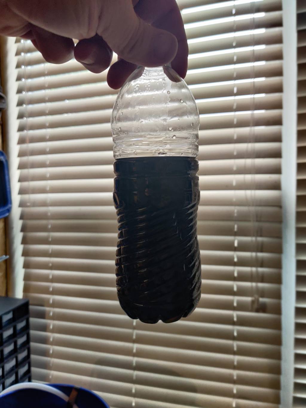

Decided to go ahead and do the 1st oil change today. Best guess, I've ran it so far for about 40-45 mins. Fills ups are pretty quick directly to guns. Oil had lost all transparency. The husky oil is clear to start.

I'd bet that "stuff" is aluminum particles mixed into a sludge in the oil. Could certainly be otherwise but this seems to be a common appearance in small engines, especially as they "break in". THAT is why I always do a first oil change after initial run in and then change oil frequently. Save some money by stretching the oil changes? Not for me with a high wear situation like these small compressors.
