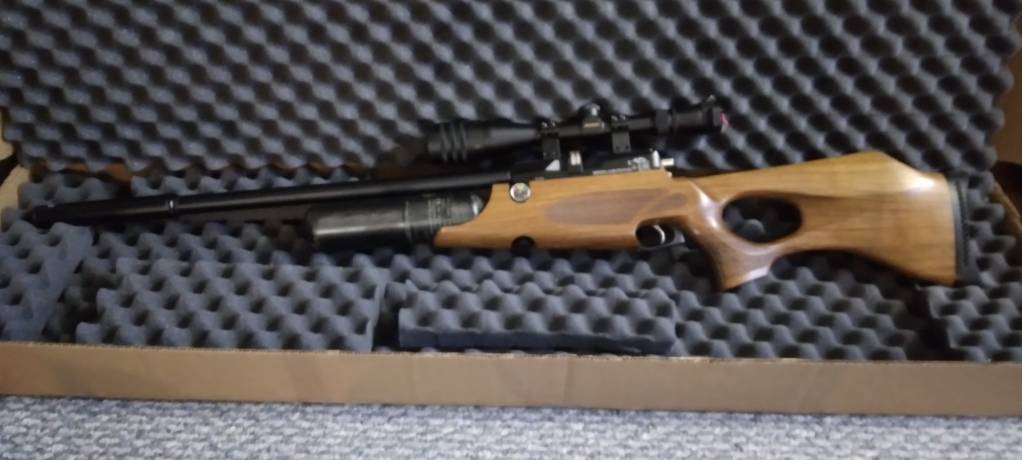

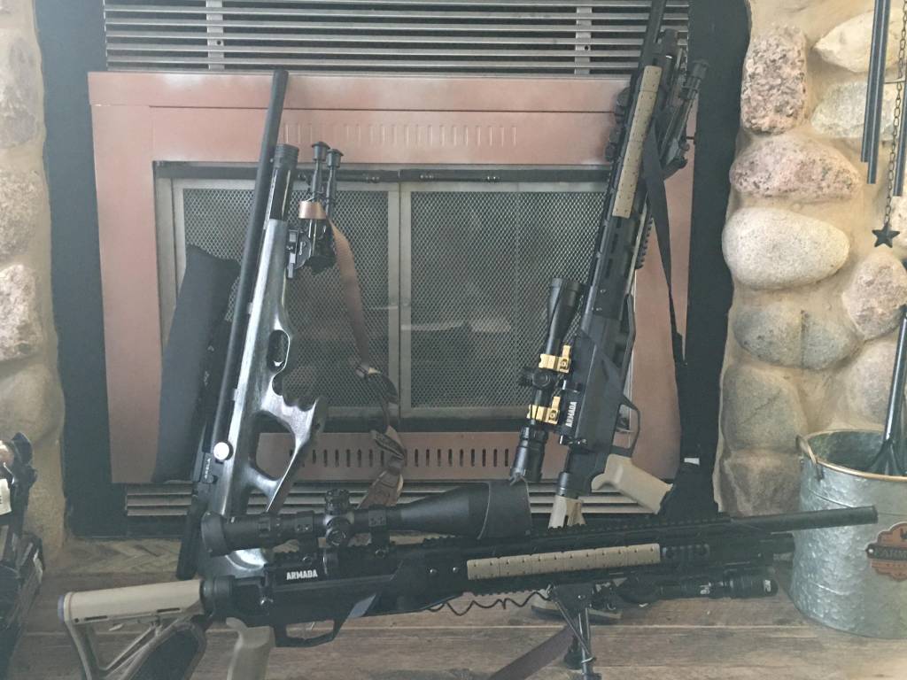

I used to come here and lurk around before I bought my first pcp rifle in 2018.It was the Benjamin Armada in .177 caliber.You can put all the AR goodies on it, hand grip,stock etc.It came with scope and bipod for around 700 at the time and whatever PA coupons I used.I also bought a Benjamin carbon fiber tank(400$)but you can get a cheaper one than that and just get it filled at the scuba or paintball place whichever is closer.Or get cheap compressor for few hundred.(you don’t need both right now)My point is I was shooting my brand new pcp for about 11-1200 bucks.If I had signed up first and asked for advice,I probably would have lost interest before I even got started with people telling me I need multiple thousand just to stick my toe in the water.On the other hand I probably would’ve just did exactly what I did and made do with the money I had to spend.Nobody wants to hear save some more money when you have money to play right now.I will say 1000 bucks can get you shooting a decent gun.Let’s say you get x rifle;5-600 bucks. A scuba tank you need to get filled or cheap compressor 2-400 bucks.All you need now is scope and ammo.If you’ve reached your all in before scope;I’ll send you a Centerpoint 4-16x50 that I don’t use.It’s not a GREAT scope but you’ll be shooting.My two Armadas .177 and .25 along with the Akela .22 which if you look at the Crosman craftsman line Akela,Kratos,Cayden they are within reach and have FIVE year warranty. Sorry for the long post y’all. Just don’t want to see someone get discouraged thinking they need a million bucks to shoot a pcp.

I really want to second this opinion, as it is excellent advice. I have a bunch of expensive airguns, but I certainly didn’t start there, simply because at one point I couldn’t afford it! My first PCP was a Benjamin Marauder in .22. I shot that for years before getting into FX airguns, and had a wonderfull time doing so. Guns like the Akela, Kratos, Cayden plus the Marauders are excellent value for money. You don’t need the most fabulous scope. A CenterPoint 3-12 did well for me for quite a while. I had no difficulty using a hand pump with my Marauder, or with any gun that fill to 3000 PSI/200 Bar. It is definitely harder when the pressure get above that, or you go from a tube to a bottle, but quite doable and its good exercise.

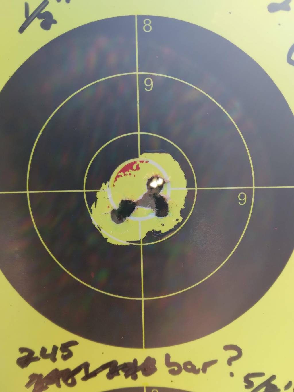

Very new to the world of airgunning. Had a couple older pump guns and just got my first pcp. Bought a used daystate wolverine, less than half the price new, but still around $1k. LOVING IT! Bought a tank-$599 and a hand pump-$180. Haven't had a chance to get tank filled so I've been filling by hand everyday. It ain't by any means "fun", but it doesn't suck too bad. It is a workout. I'm 155lbs, only last 230-250 bar is a bit difficult. It's a big cylinder-480cc. Takes approx 200-225 pumps to go from 100-250 bar. Pump gets hot so I take breaks after about 100 and then after every 50 to let it cool. I got 75 shots yesterday starting at 250 bar to 200. Start at 200 next shooting day, see how many more shots I get before it starts to drop off. I will be looking to get that tank filled at paintball shop before too long, but like having the hand pump for just in case.
5shots@30yrds
I've also come from the firearms side. Been shooting many years but I'm no competition shooter. Better shooters could get better groups at further distances, although, I've only owned her for a week, and we haven't got the feel for each other just yet, I'm gonna keep working on improving. Hope this info helps your decision making.

Totally agree.My thinking at the time of first pcp was “Hey, Crosman has been around for years and the Armada .177 came with scope and bi-pod and had good reviews so I took a chance without seeking advice.Bought another one in .25 the next year.I felt if there was a problem Crosman would stand by their product.Yes now 3 years later I have a Uragan and a Weihrauch and a compressor but starting out it was a Benjamin Armada, scuba tank and driving to the dive shop to get my tank filled.
