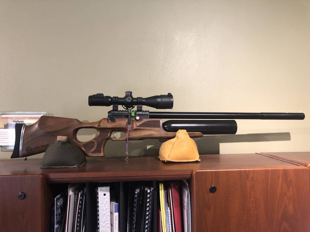

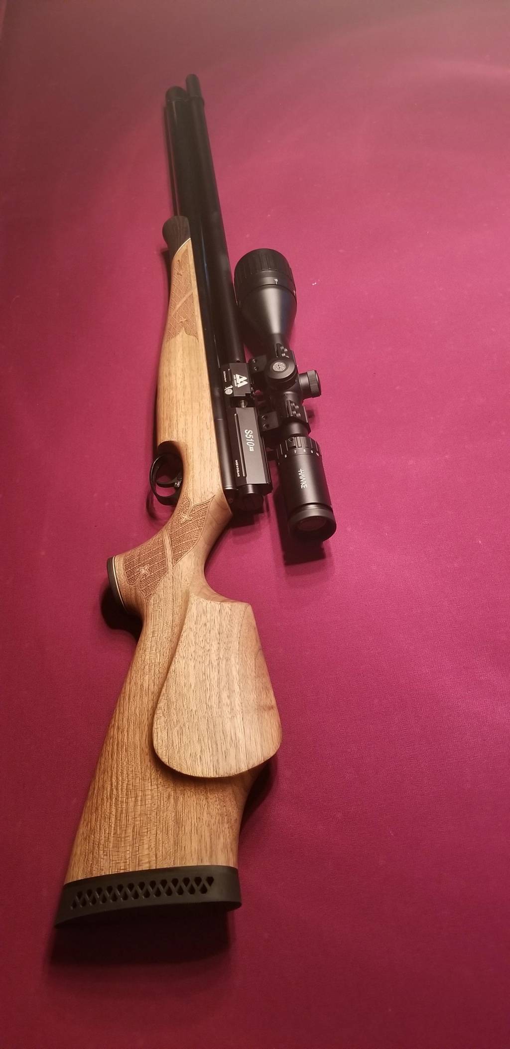

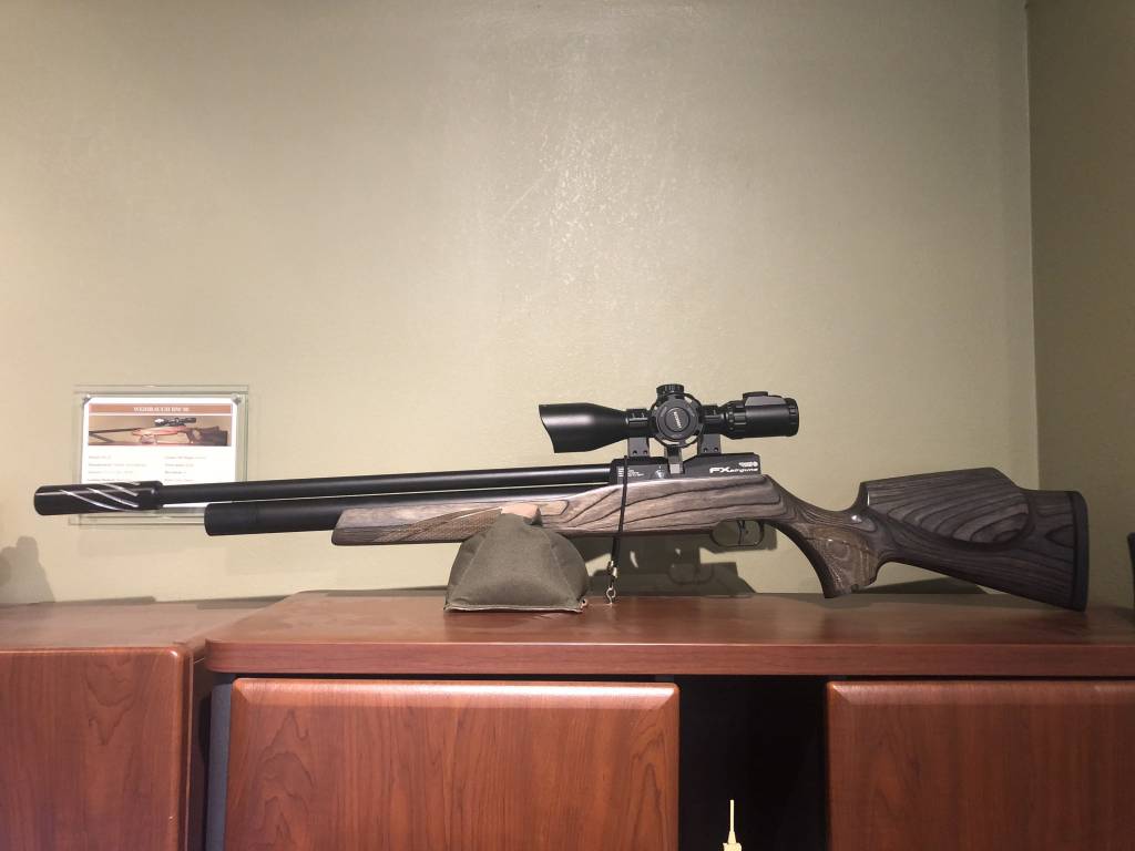

I have been into air guns for 40 years all mostly high end spring based (HW, AA Theoben etc) and this year dived into PCP with 5 new rifles! (after selling some of the spring guns) and have 2 Krals and 3 FX's. The FX's happened by accident more than design. Sure the FX's are "nicer" and you can configure and upgrade them in many ways but are they are 3x the cost of Kral's nicer or really 3X better than most PCP's in the $400 to $700 range no not really. Below is the SJ, .22 FX Streamline and .25 Dreamline in a special aftermarket stock they all shoot essentially the same.
