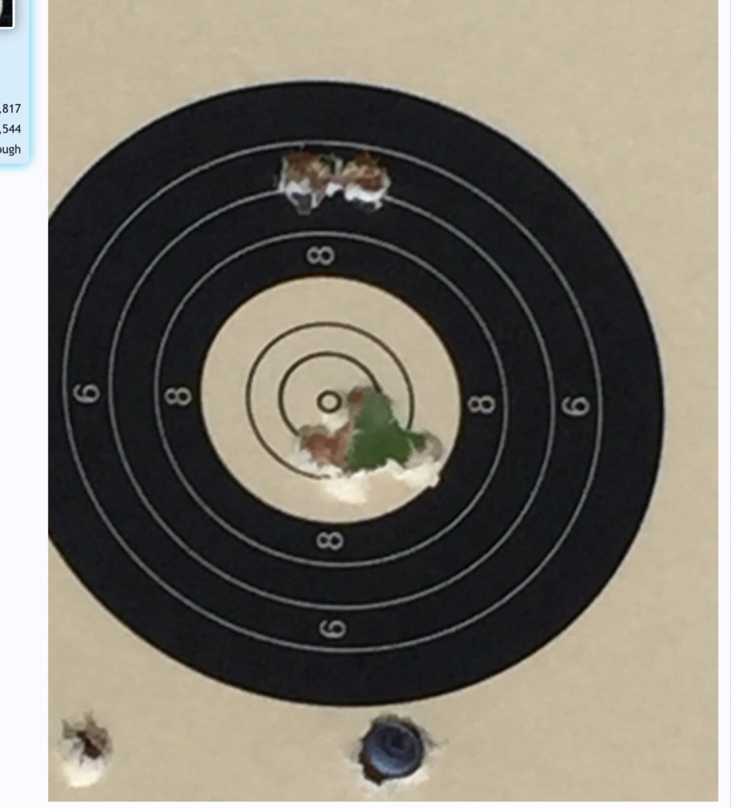

For pellet testing, I can generally tell if the pellet is or isn’t going to work in my gun within 5 pellets.
However, I will always test an entire magazine worth to see how the pellet copes with being indexed within it.
Here you go, the top group in the target is an 8 shot group single loaded
the middle group is an entire 17 shot magazine worth
To give an idea of scale the pellet below the target is a .177 pellet that I pushed into a 4 shot single loaded group.
this group was shot at 45yards with my .177 mfr 8.4grn Air-arms fields at 780fps outside .
