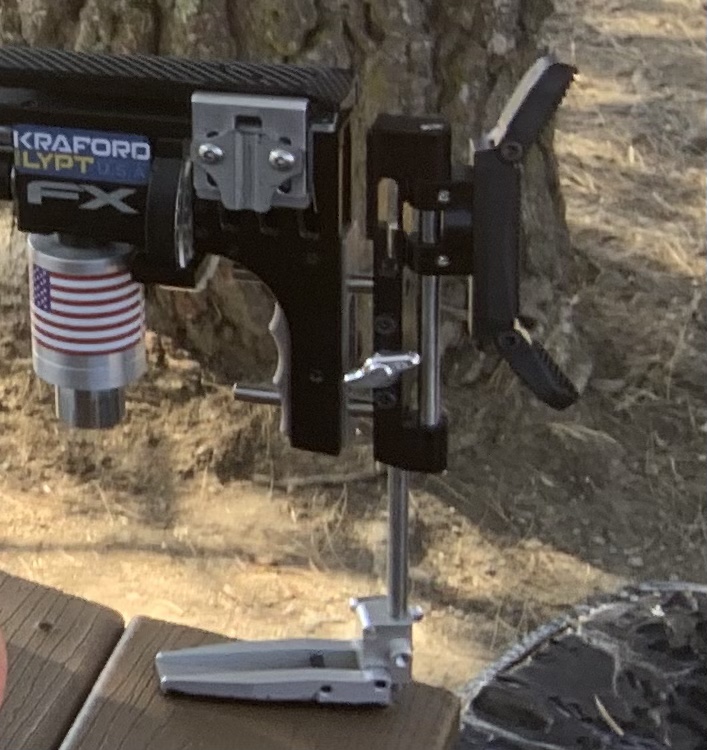

I have a few rear monopods made by Accu Shot. K&L with bag rider and also a home made version. Rear monopods can serve a purpose but they work much better with a wide stable base like the Saber Tactical models. Otherwise, you have a tiny point of contact so they can be kind of wobbly. You can hold the monopod in your fist to add stability & some adjustability, which is what many shooters do, for me, not the best option.
I made a rear monopod out of one of my wife’s cutting boards(PVDF) and some K&L parts I had. I cut up the PVDF so that it was 3”x5” at the base, attached it to a titanium rod and used it with the K&L stock. While it was stable from the bench, it was cumbersome anywhere else(I’ll try and find a picture, it wasn’t pretty). Like everyone, I like to try new things, experiment & make stuff but for years, I’ve always found myself going back to a rear bag, almost always! They’re far for stable, quickly adjustable with a squeeze and they’re fairly cheap. I have a monopod on the Delta Wolf & use it occasionally but more often it’s used folded up as a bag rider.
It really all kinds of depends how much height you need, how mobile it has to be, what you want to spend and what you like. I know these are not the exact recommendation you’re looking for but I have used factory mono pods on my PRS rig a lot over the years, made mono pods for our bench guns and always go back to a rear bag when I can, except is rare instance. It’s just so more stable because of the contact area, it’s just so simple & quickly adjustable. On the other hand, turning the screw on the monopod for minor up and down adjustments can be a pain.

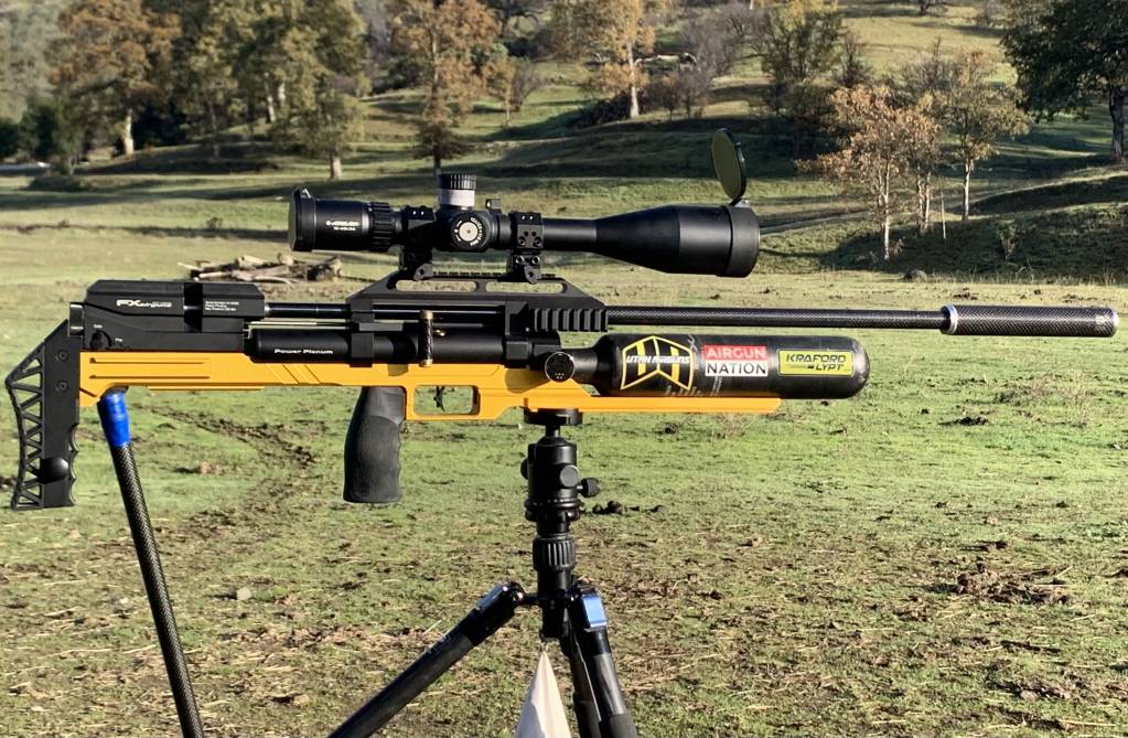

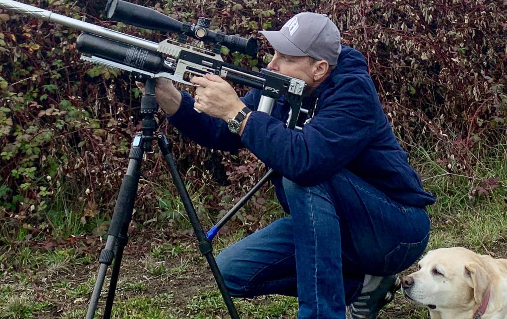

When my boys and I shoot from a tripod and have a cumbersome, unsteady shot, we often use a piece of carbon fiber tube that we wedge between the rear of the gun and the tripod for more stability. Combined with a sling or strap, it can be rock solid! You could use some kind of tube or something similar for a rear brace. Something as simple as that might work as a rear support for you in the field. There are lots of options, you just have to get all the information you can and try a few things to see what you like.

This picture(it’s the only one I had, sorry) shows the K&L monopod with bag rider. I can’t find a picture of the monopod I made with the chunk of cutting board attached. In essence, it was the same as in this picture but with a 3”x5” chunk of cutting board screwed and epoxied onto the rod for more surface area touching the bench.
These pictures show how we use a carbon tube to stabilize the rear of the airgun when shooting from a tripod. You could use the same concept with a bipod and some kind of brace in the rear.
