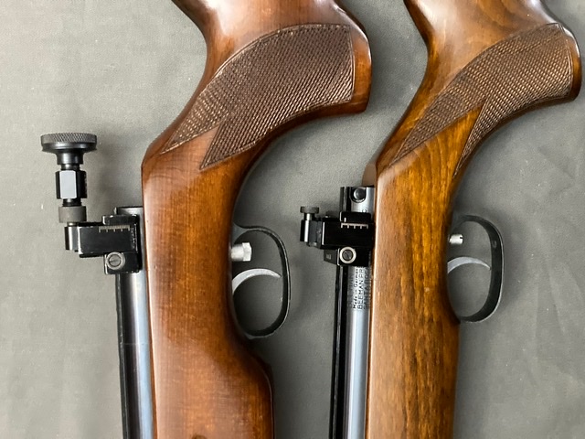

If your gun is the globe sight model from Weihrauch then you are set. If it’s the model without sights the problem is twofold. How to install a front sight and does the stock have enough drop on the comb for irons. If it has iron sights when new then Weihrauch/Anschutz diopter will work perfectly. Not a cheap choice but worth every penny. You can find them on places like eBay. Around $175. Make certain the Weihrauch diopter is the 11mm model. Early models were 13mm and will not work on your gun.
An aside - a peep sight does not generate a "need" for a different front sight. A gun's line-of-sight for a given distance is determined by its trajectory with a given pellet, and the height of the front sight above the bore. Any rear sight is just a device to help your eye "find" the LOS. (An old-timer's trick when mounting a peep is to align it with the open rear before it's removed, that gets you 90% of the way toward being dialed in.)
Now what front sight size or shape you prefer is a separate issue of course.
Most find the "high" version of the Williams sights - either the FP-AG or 5D-AG - is best for barrel cockers, but your mileage may vary. I have three old HW's with AG's sighted-in for 10 meter target shooting, and they are adjusted so low that the FP-GR or 5D-GR probably would have worked.

This. Most people will put the peep sight far towards the rear, but not everyone. With the stock front I’m guessing it’s 3/4” to 1” high and the high FP-TK would work best. Also does away with stock clearance issues that affect some guns if you use the low version. If you decide to get the Williams I’d measure your post height and call them to see what they recommend.

My guess is the AG would work best on your gun, but check with Williams. I just put one on a Diana 34 and looks like it will be perfect. Trying it out a little later today. I don’t know a lot about your rifle, but if the front sight is screwed on there are lots of options for replacing.

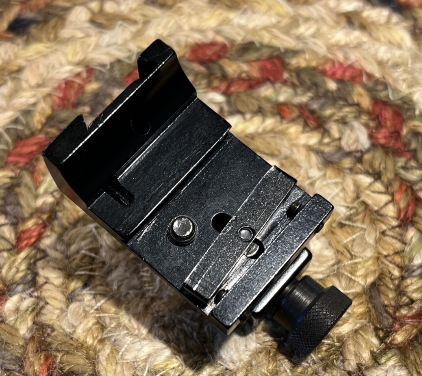

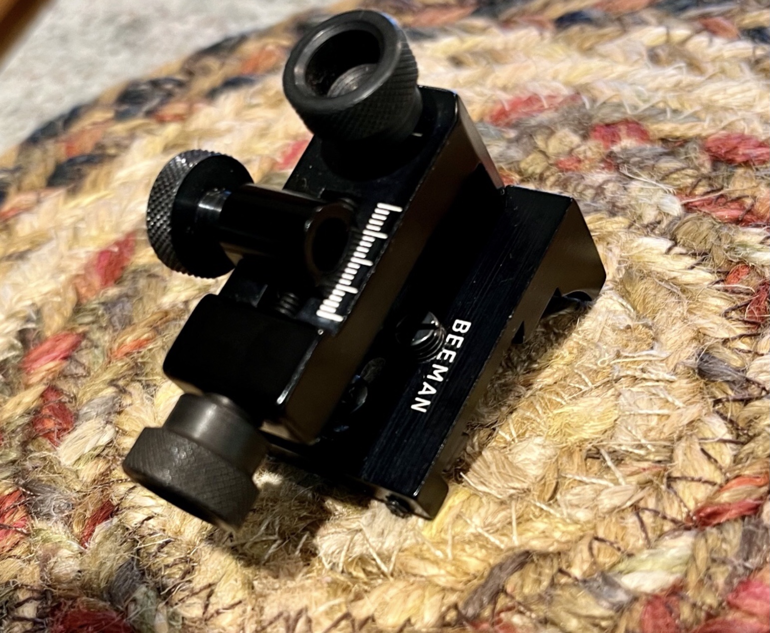

The Williams diopter works perfectly with the Weihrauch globe sight. Just mount it to the dovetail and done. I have had the Williams sight move rearward because it does not have a stop pin. Either add a stop pin to the mount ( drill and tap) or use a scope stop. That RX will probably move the sight. Says Beeman but made by Williams.

Love the extension on the back. Allows the aperture hole to be much smaller being closer to the eye. Hence, tightening the “room for error”.
