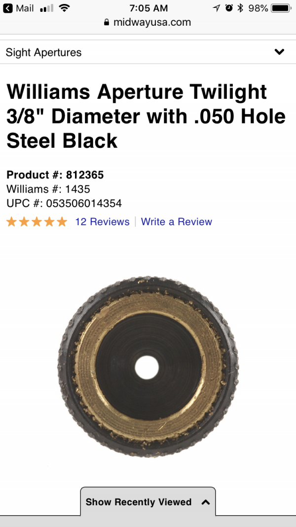

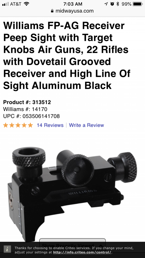

I just put a peep sight on my R7 and like it. I also got a 0.05” aperature too, that makes it easier for me to shoot tighter groups.
1525086743_10249413605ae6fa1717a665.49965088_C46EF7BC-A425-4F8E-AED8-800CA22515D5.png
"Crutcherro1"I just put a peep sight on my R7 and like it. I also got a 0.05” aperature too, that makes it easier for me to shoot tighter groups.
Thanks CR.
Looks pretty slick.
Noticed that they offer an FP-AG sans knobs.
As I plan to set it and leave it, that might be even better.
RE: the 0.050 Aperture.
Is that bigger or smaller than OEM?
EDIT: Just read that OEM is .093"

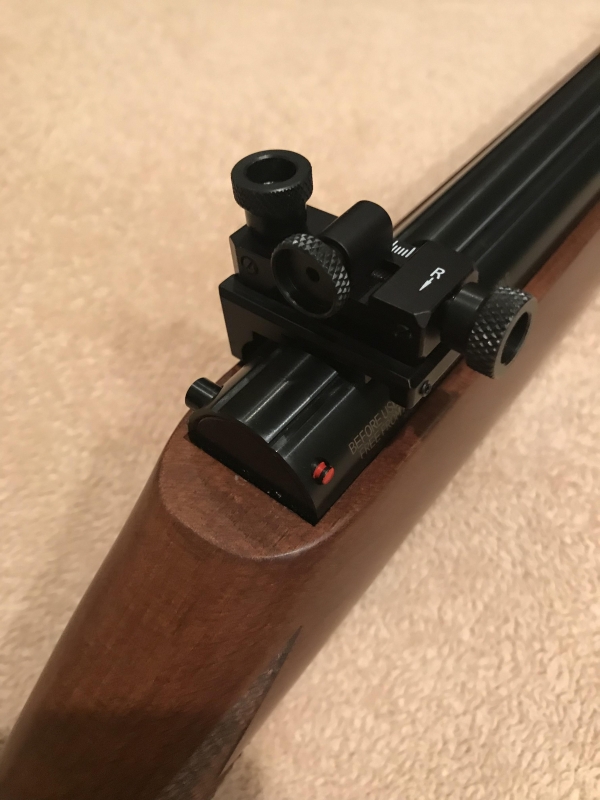

Received and mounted the FP-AG rear Aperture sight on the R1.
The instructions were poor.
You need to:
- Set the dovetail clamp lightly with the allen set screws.
- Then lightly set the top screw.
- Then torque the allen set screws.
- Then torque the top screw.
If you follow the instructions, the mount base will flex and bend, leaving a gap between the clamping jaw and the base.
Other than that, I set the base just ahead (~ 1/16") of the safety, so that the safety was centered b/t the sight base and the rear of the receiver.
Safety operation is unencumbered,
The stock aperture's optics work great, with plenty of field of view.
Have a minor issue with the rifle, however.
This R1 is a carbine, and has a few degrees of up angle on the Bbl/chamber block.
So, with the sight run all the way down, hard against the base (which is good), the rifle shoots ~ 2.25" high at 20 yds with the std. front sight, and the Benjamin CYL pellets I am currently shooting.
What this gives is a hold of just a hair over half way between the top of the post and the top (inside) of the ring.
I don't know if the alpha can be corrected, and it didn't seem to concern the Air-rifle Ferrari mechanic that overhauled it not too long ago.
The Benjamin CYL pellets are shooting ~ an inch at that range, but have a pile of JSB Diabolo Exact on the way.
Suffice to say, the rear Aperture sight is awesome. Should make the R1 a great field carbine again.
