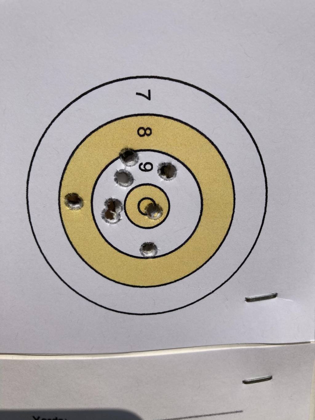

I can shoot 220 to 225 or so on EBR Target Challenge with Red Wolf HP and .217 JSB KO slugs at 990 FPS. Average group size about the 9 ring which is 1.2 inches. Real world results not cherry picked. Average wind conditions here in SoCal so around 5 to 10 mph swirling. In totally calm conditions the RD Monsters are ever so slightly more accurate.
This would be an average group, 8 shots at 100 yards. Yes, have had groups half that size but this is real world average in real world conditions. Right at MOA C2C I would estimate.

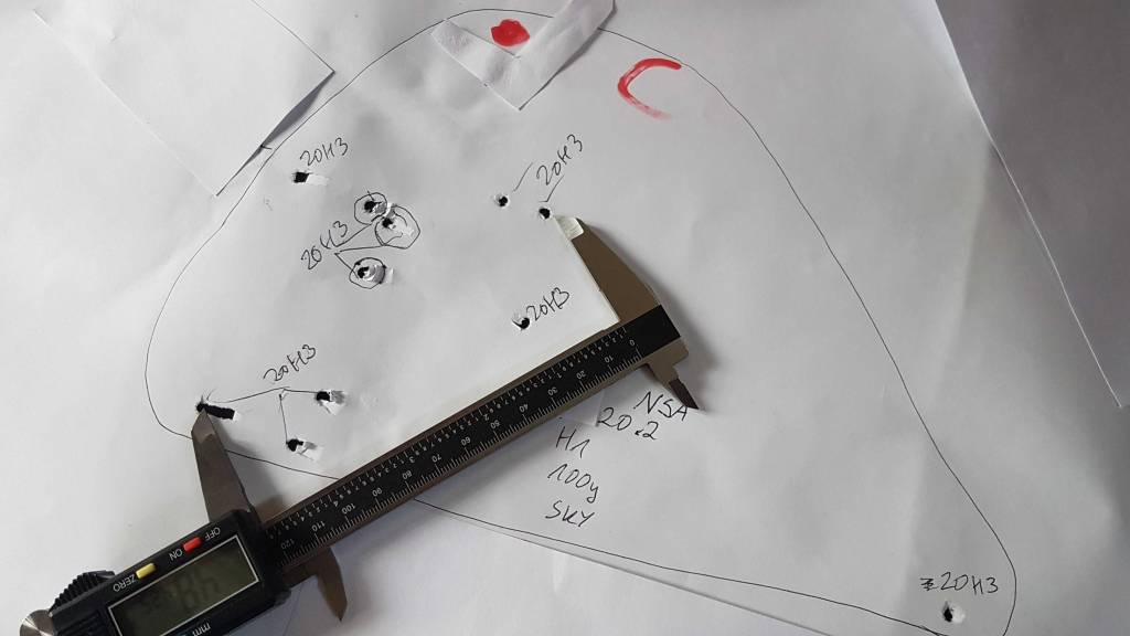

5.4" 10-shot group | NSA 17.5gr, 5.52mm | 100y | Skyhawk with LW barrel
TEST.  SKY.  N 17.5 H2.  91m.  10Sh.  MxGS4.8in.  Tun04.  2020-11-23.1606171231.jpg
4.8" 10-shot group | NSA 20.2gr, 5.53mm | 100y | Skyhawk with LW barrel
TEST.  SKY.  N 20.2 H1.  91m.  10Sh.  MxGS4.8in.  Tun04.  2020-11-23.1606171325.jpg

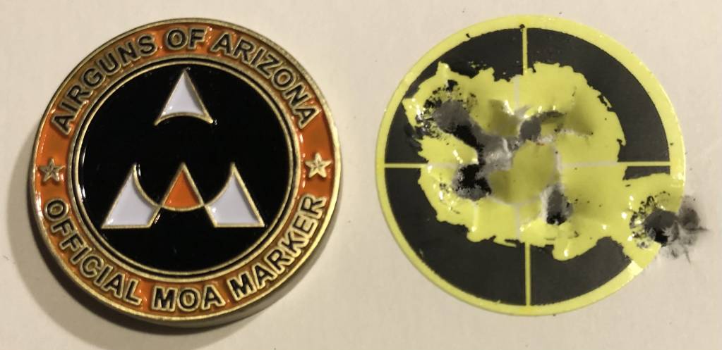

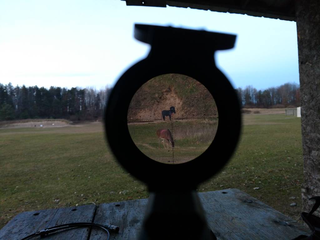

There's actually four different groups here from the other night shooting at 235 yards, until the deer shut down my longer range silhouette target. All are sub moa from an AAA .357 Slayer, if I do my part. Because the thing is unregulated, I have to adjust on the fifth and sixth shot to keep it tight at that range. If I slip on what I should be doing to hit the same spot then it does show up at these distances.
All with a little bit of practice, knowing what to expect from the shot string, a good scope, and also fine tuning the pressures to the projectile...
