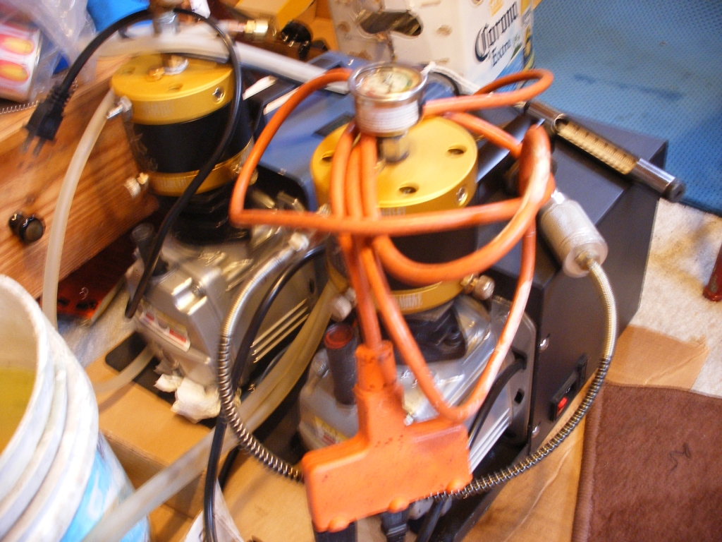

dont worry my son?some day your gun room will look like this"
