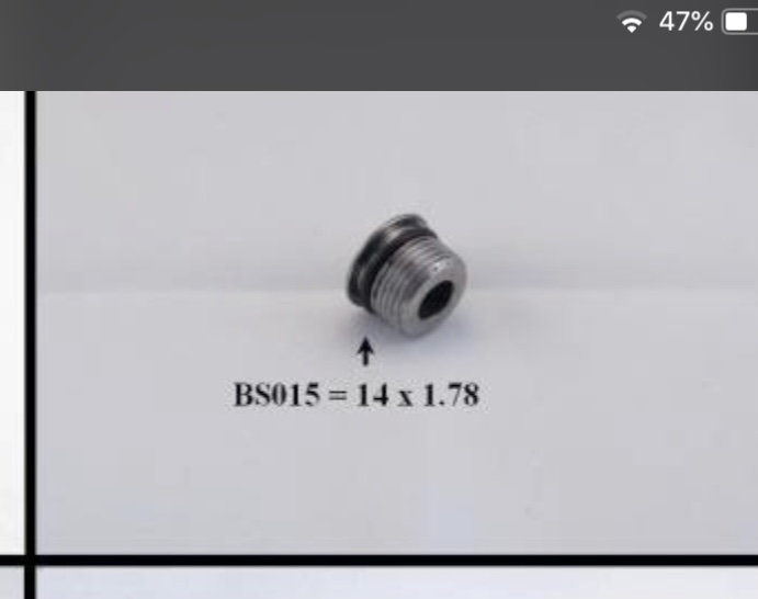

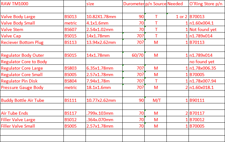

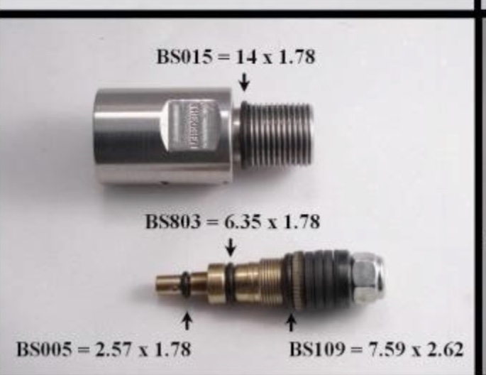

This is what I have, don't know if it's COMPLETE, hopefully BBoy or Motorhead will chime in 👍

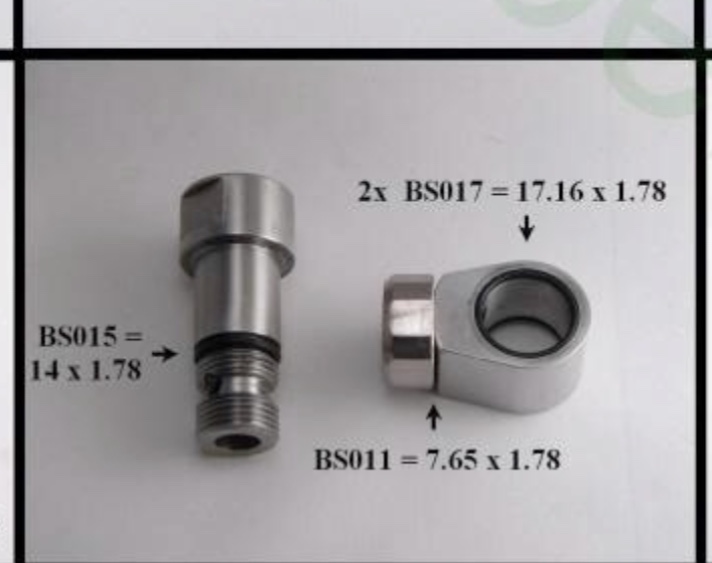

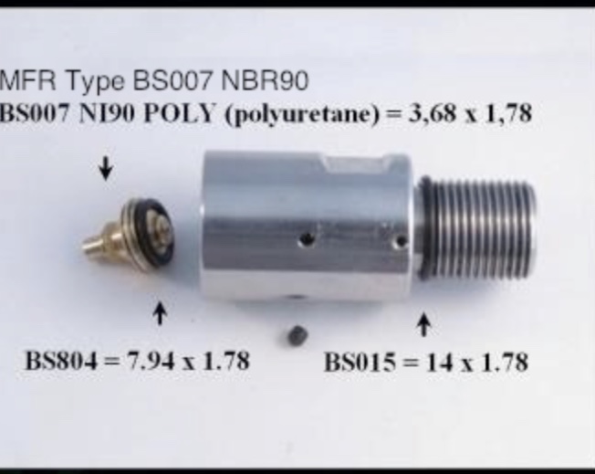

Here are most of them
The o-rings listed are for Rapids and some RAW's, which can get confusing.
Which specific o-rings do you need?

the list on the thread is mostly not for The HM1000,i had to wait 1 month for them to arrive from ebay and then dissasembled the gun to find out the valve body orings are small. on my riffle are the top ones

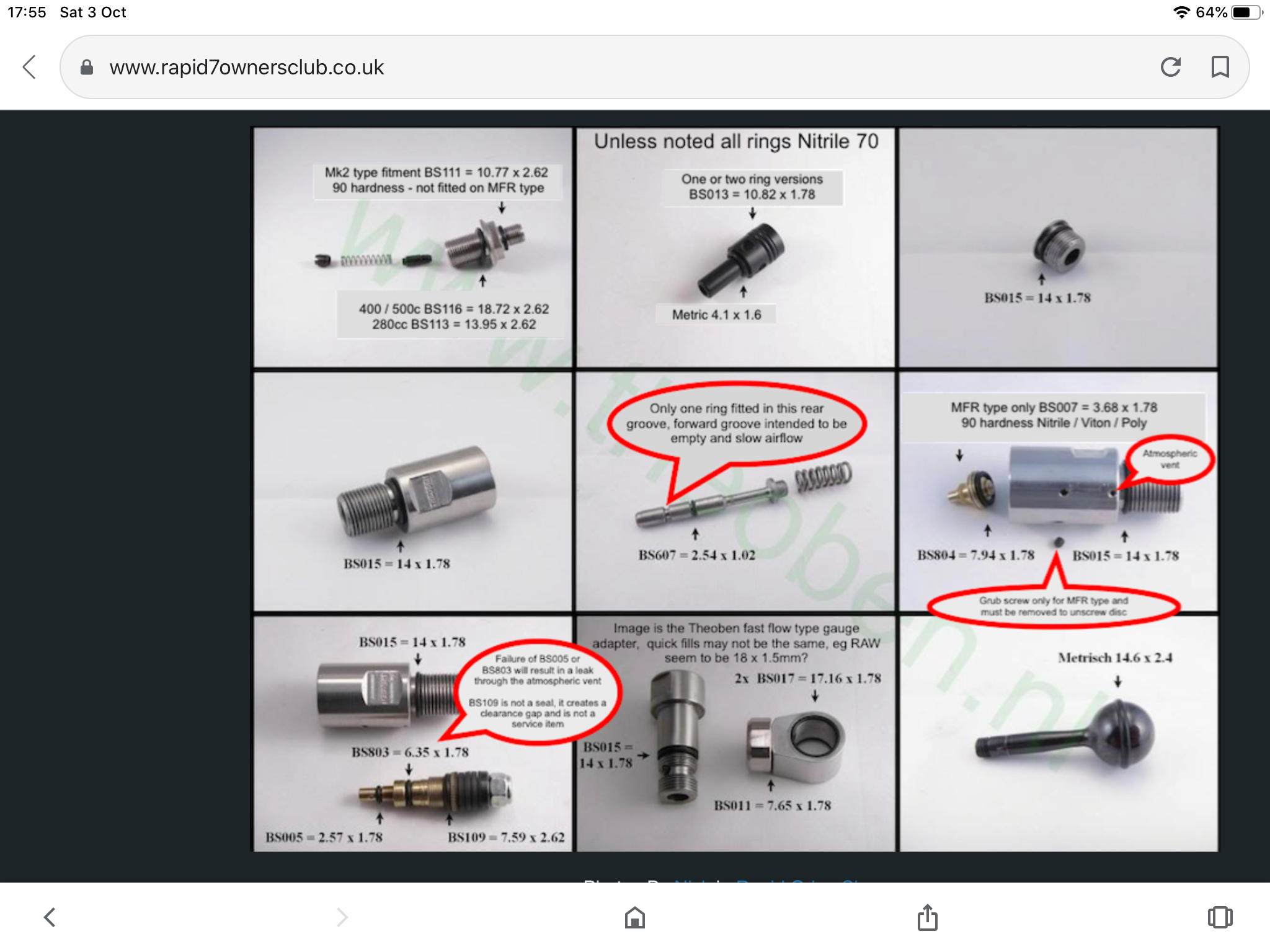

I started with the above chart, but many of these are for older versions and I ended up buying o-rings that I don't need. I will be taking the gun apart again to take some measurements and order some more from O-Rings and More. Even this hit and miss approach is cheaper than buying them from RAW. I really want to like this gun and am considering the purchase of an MPA chassis for it, but I have gotten frustrated enough with it to purchase a Taipan Veteran II Tactical to use in the meantime. I don't think a comprehensive list of the required o-rings for the newer RAWs exists anywhere at the current time.
For instance, the V-Block Quick Fill was leaking, and the above list indicates a BS017 is used, so I ordered a supply of 50 of these for about $2.00. When they arrived, I realized that these aren't even close. I removed the old rings and measured them and purchased metric 1.5mm x 18mm rings that fit properly and appear to be sealing well. Lesson learned...remove the rings and measure them before ordering!
