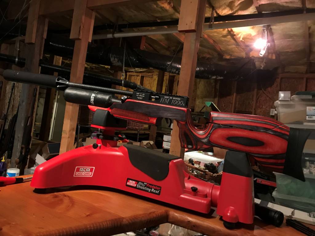

Hey Guys,
Does anyone know the OEM regulator set-point for the .25 caliber RAW HM100xLRT?
Likely 140 or 150 bar...
Kirk
