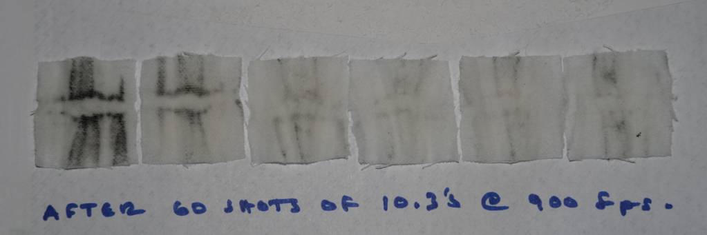

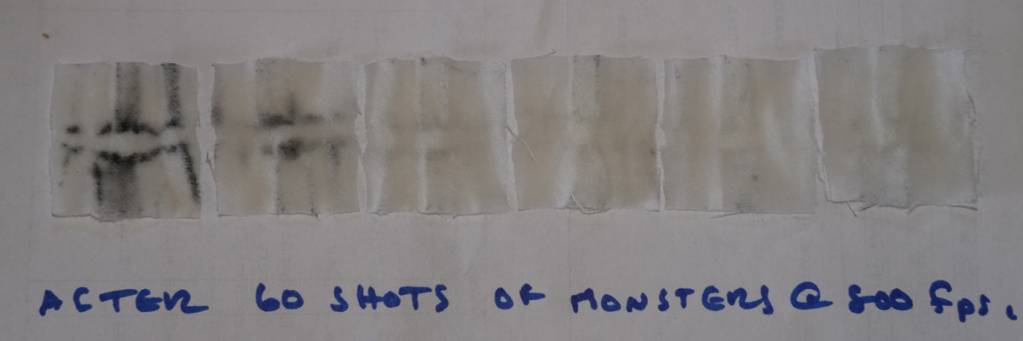

I think I've finally got the RAW dialed in. I found out that shooting the Original Monsters at 800fps are more accurate than the 10'3s at 900fps. However, I have to clean the barrel after every 60 - 100 shots in order to maintain the accuracy. I would have thought that the poly barrels would be less likely to fowl up??? Below are a few examples of what I'm getting.

Glad you got it figured out! I had my poly barrel polished and after 5 tins the patches look like yours after 60 shots. Are you removing the barrel when cleaning it....if not, then that could be dust, paint or debris from the moderator. And, yes, poly barrels lands are smoother so there should be less cleaning to do than regular grooved barrels. especially if shooting them slower as you are plus there is no choke. I hold my RAW snug when I shoot as I like to be compact, elbow in, more comfortable to me.
Not sure if Martin polishes the barrels. The Airgun Channel guy Kaylandy ran patches through his new HMx in his video review of his .22 Chassis model and it was a little dirty....I know mine was polished with non marring JB bore paste. Check the barrel polishing video by Orion the iguana guy, he posted one here awhile back on how to do it and with what paste, mops etc...
Hey Green-Y,
I normally polish all my barrels when new with 400 grit clover/patch and a jag - about 10 back and forth's in the barrel. Then do about 20 back and forth's with JB paste. Any future cleaning can be done with weed whacker line and patches w/Goo Gone. No need to scrub the barrel more than once, after that simple patch cleaning should do it.
